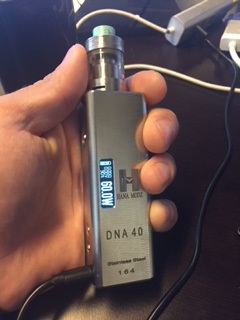

Spector NS5 RD Posted September 20, 2016 Report Posted September 20, 2016 Levivapes said: I have a vaporshark rdna 40, would this board fit? Expand welcome to the forum levivapes. i plan on doing the same with my VS RDNA 40 mod. the board will fit inside with little to no modifications. however, There is one main concern that presents itself when transplanting the 60 into the rdna. the 60 is escribe capable, the 40 is not. if you want to be able to use escribe, you would need to connect the data pins of the 60 board "somehow" to existing female micro usb socket that is mounted on the VS daughter board. the daughter board has all of the regulatory buttons on it, the 2 amp charger, reverse battery buzzer and finally the QI wireless charging circuit. so it is doable but requires some rerouting and adding some charging and data lines. another option is to set the board up with all the profiles etc. that you want, before you install the board into the mod. then leave the 60's data pin outs open (not connected). the mod won't be able to connect to escribe but will be already set up for any wires or profiles etc. this is my least favorite option (i will not do this option, i use escribe too much not to have it) but would be the easiest way.
Levivapes Posted September 21, 2016 Report Posted September 21, 2016 ChunkyButt200 said: welcome to the forum levivapes. i plan on doing the same with my VS RDNA 40 mod. the board will fit inside with little to no modifications. however, There is one main concern that presents itself when transplanting the 60 into the rdna. the 60 is escribe capable, the 40 is not. if you want to be able to use escribe, you would need to connect the data pins of the 60 board "somehow" to existing female micro usb socket that is mounted on the VS daughter board. the daughter board has all of the regulatory buttons on it, the 2 amp charger, reverse battery buzzer and finally the QI wireless charging circuit. so it is doable but requires some rerouting and adding some charging and data lines. another option is to set the board up with all the profiles etc. that you want, before you install the board into the mod. then leave the 60's data pin outs open (not connected). the mod won't be able to connect to escribe but will be already set up for any wires or profiles etc. this is my least favorite option (i will not do this option, i use escribe too much not to have it) but would be the easiest way. Expand
Levivapes Posted September 21, 2016 Report Posted September 21, 2016 Thanks for the info, protovapor said someth8ng about a daughter board being an issue, could I just swap it out too? I got the vs for free because the wattage and temp just go down for no reason. No stuck buttons, must be a board issue, since I figure anything I do to make it work is worth it.
Spector NS5 RD Posted September 21, 2016 Report Posted September 21, 2016 Levivapes said: Thanks for the info, protovapor said someth8ng about a daughter board being an issue, could I just swap it out too? I got the vs for free because the wattage and temp just go down for no reason. No stuck buttons, must be a board issue, since I figure anything I do to make it work is worth it. Expand the problem with ditching the daughter board is the regulatory buttons are soldered onto it (FIRE, UP and DOWN buttons). the daughter board runs from the bottom of the mod to the top with the dna board soldered to it around the middle. since it's already broken, take it apart and you'll see what i'm talking about. no interest in fixing the existing dnA 40 that's already inside? if you know for sure none of the buttons are stuck, the next likely suspect is flux residue shorting the dna 40 board external button pinouts. it happened to a dna 40 of mine. it had the symptom of a stuck DOWN button (flashing between 1 watt and the serial #)but the actual button was in perfect working order. i had to clean/scrape away the flux residue between the 2 DOWN button pinouts, works fine now.

Levivapes Posted September 22, 2016 Report Posted September 22, 2016 ChunkyButt200 said: the problem with ditching the daughter board is the regulatory buttons are soldered onto it (FIRE, UP and DOWN buttons). the daughter board runs from the bottom of the mod to the top with the dna board soldered to it around the middle. since it's already broken, take it apart and you'll see what i'm talking about. no interest in fixing the existing dnA 40 that's already inside? if you know for sure none of the buttons are stuck, the next likely suspect is flux residue shorting the dna 40 board external button pinouts. it happened to a dna 40 of mine. it had the symptom of a stuck DOWN button (flashing between 1 watt and the serial #)but the actual button was in perfect working order. i had to clean/scrape away the flux residue between the 2 DOWN button pinouts, works fine now. Expand I actually found someone local with a rdna 40 for 40 bucks... so it's gonna be cheaper than a new board. I'm gonna go ahead and cerakote the body for mine and just put those guts in mine
