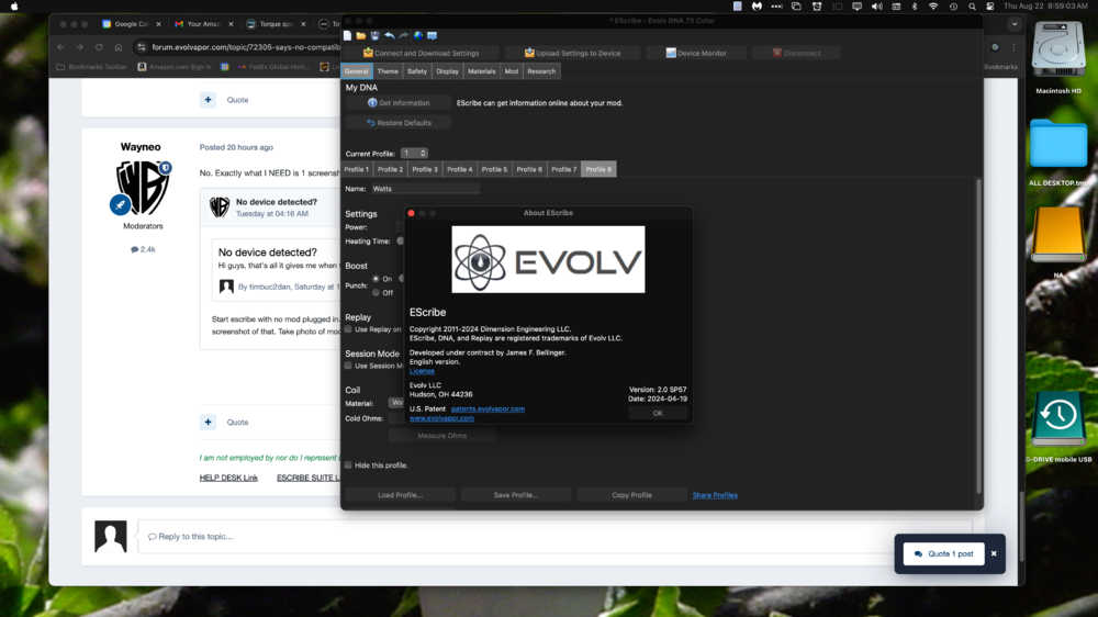

  4. Hello, @Wayneo Posting these on behalf of timbuc2dan. He came to the support desk. I think he just needs to download the newest version of Escribe - it can be found here : https://www.evolvapor.com/escribe
  5. Try this: Plug the device in & open Escribe. Ignore the connect prompt. Go to Tools> Apply service pack > Try an older service pack. If this applies, then apply the newest service pack from the front page of Escribe. If this doesn't work, I would also try more than one USB cable. Inspect the usb port and ensure it is clean. Even if it looks clean, I would use a small piece of paper towel, isopropyl & a toothpick to carefully clean out the port.
