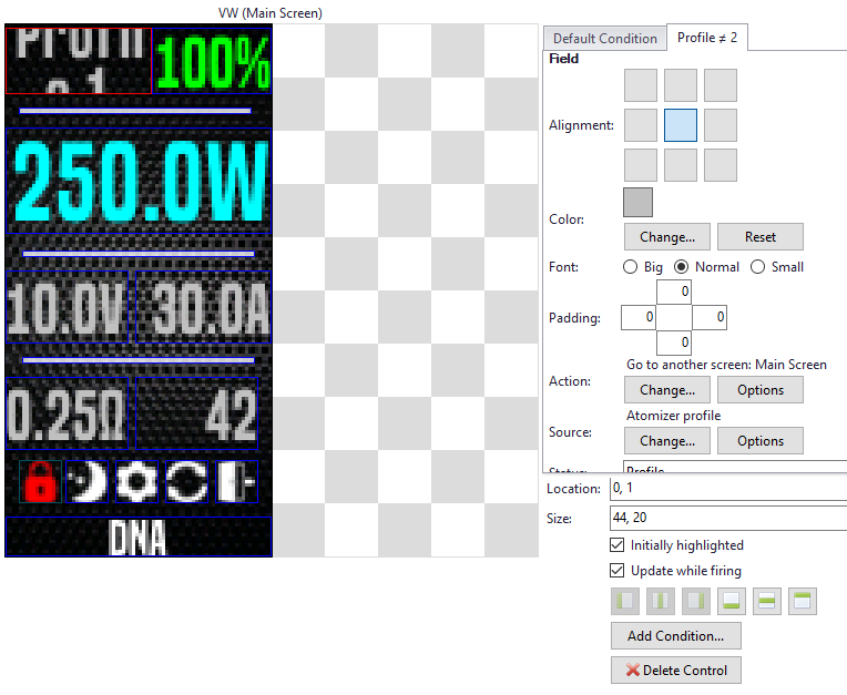

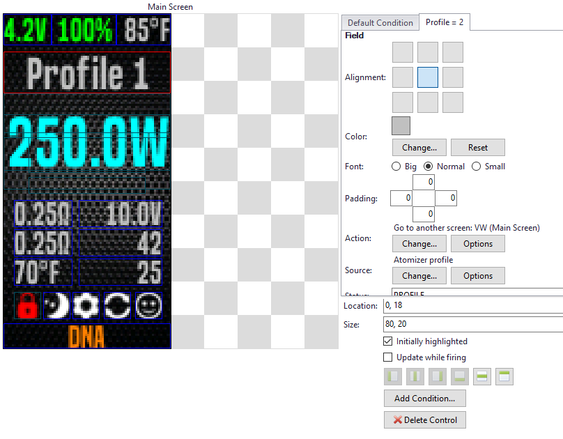

My main idea was to separate temp and non-temp sensing materials on different screens because all those fields eat up some much space on the screen I could use for other useful stats to be visible. Also, a few friends use my theme but they want just a basic screen for VW and I don't want to maintain 2 themes. Figured it's good you need to press fire once more otherwise you stuck in the selected mode. Cheers for all the help -

Hi, Thanks for coming back. Yeah, I've tried this method but I couldn't make it work only if you use it on the Profile field readout. There is just one small gripe but it's not so bad. Actually, when you choose the desired Profile, you need to click select, and then select one more to trigger the action. Anyway, I love it. So the method is: On the Main screen Profile Field - Add condition Control: Field Compare: General - Profile Comparison: is equal to - Your desired Profile number On this condition (Profile = 2 in my case) Action - Go to - Another Screen - The screen you want to jump to To go back to the Main screen Profile Field - Add condition Control: Field Compare: General - Profile Comparison: is not equal to - Your desired Profile number On this condition (Profile ≠ 2 in my case) Action - Go to - Another Screen - Main screen -

I'm not sure how to edit my post so I put it just here. I know it was not clear what I want but here is a pic. I want this screen where the profile always Profile 1 on the top left regardless if I use another profile on another screen . -
Hi, Making my own theme and just wondering if there is a way for the profile field to default to a specific profile, so I can make my own screen for my 3 preferred profiles. It is possible to set profile read-only so it's not a problem, but I just can't find a way to define a profile for a specific screen. Thanks for reading
