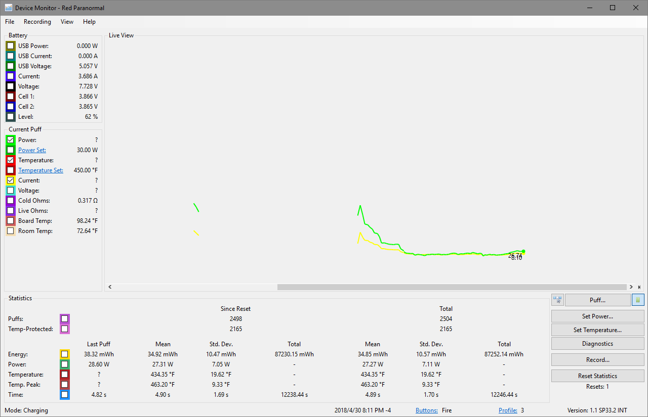

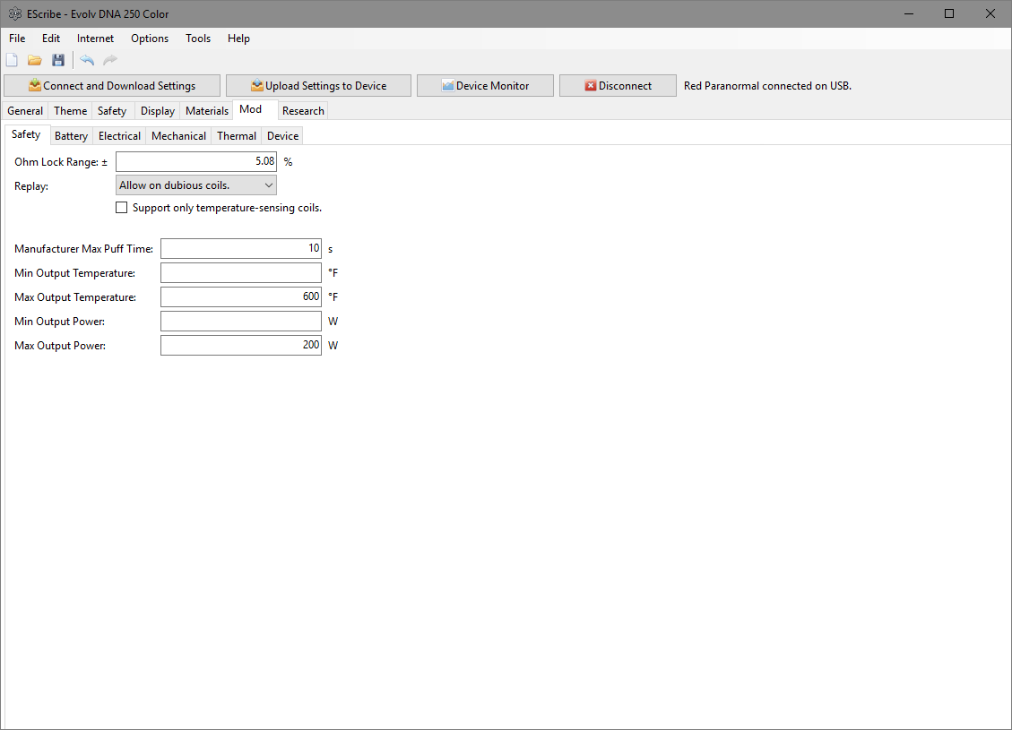

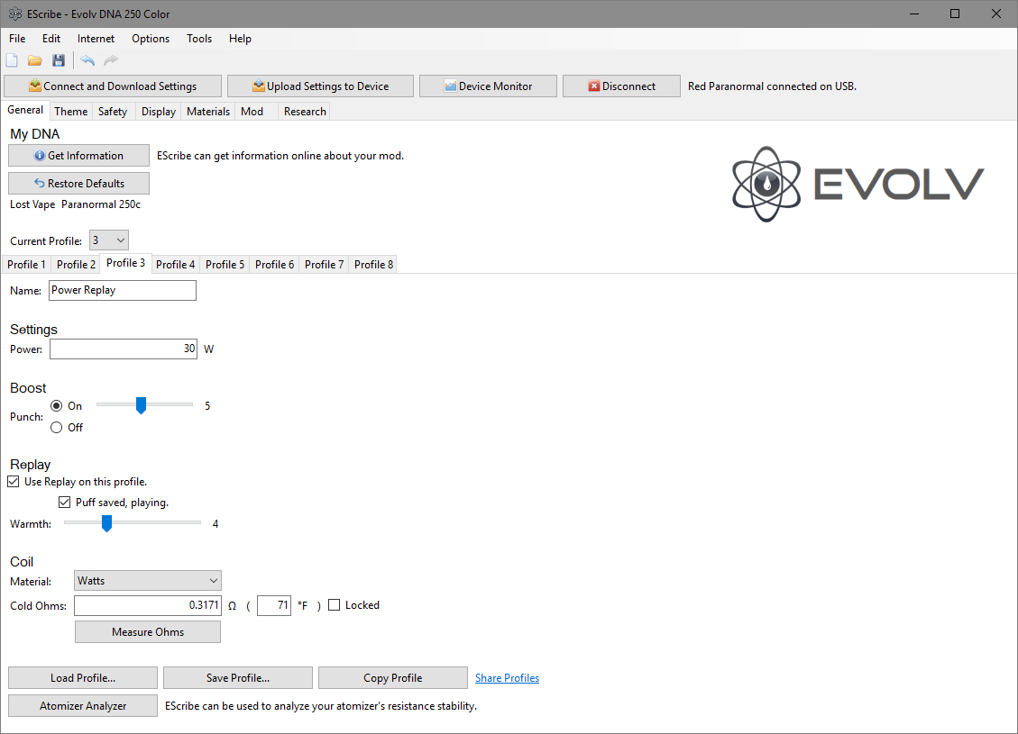

I had Replay 'working' in TC mode. Then, I was informed that Replay was meant for wattage users and would work best in that mode. Setting my profile to 'Watts' didn't produce any vapor, just the Check Atomizer warning. After a bit, I decided to try a different method to get Replay working as intended. I use SS430, so was using that as my material. When I did that, the mod was somewhat confused. I saw Temp instead of volts on the display and could only change Temp from the main display, no wattage. I think it worked, but as TC is solid I couldn't really tell. Anyway, I changed my settings. On the mod tab, I chose Allow dubious coils and unchecked Support only temperature-sensing coils. Then I set up a profile to use Replay in power/wattage mode. And, it works a treat. I have wattage displayed for change, and see volts instead of temp. Plus, it works as shown by device monitor. No temp displayed there now.
