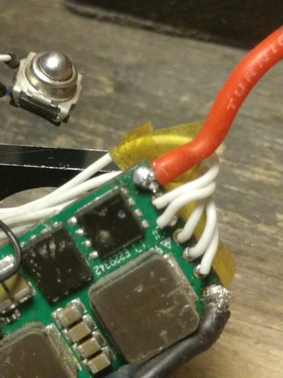

  7. That was my 1st test with the meter, I just figured it more relevant that the the connection between the wire and the solder holes was good. All power wires are 18g silicone wire. When I get home tonight, I'll take a some pics of the wiring.

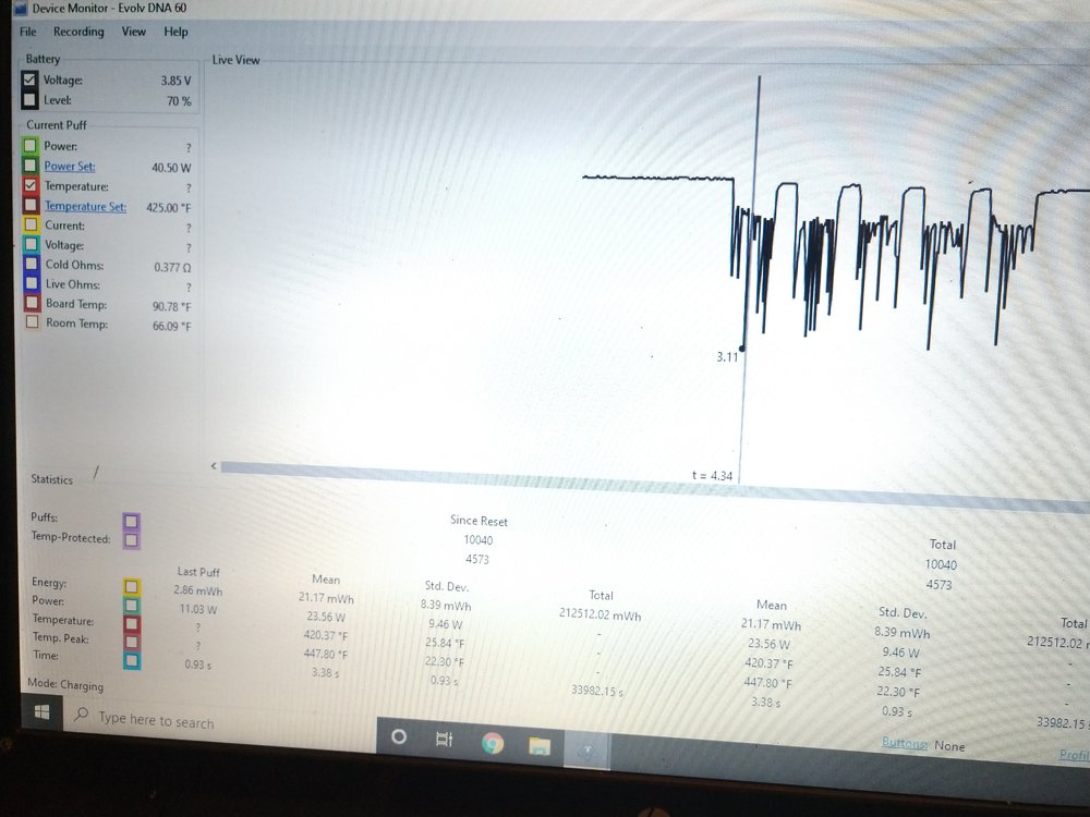

  8. I've been messing around with my dvom, it has min-max capture. I'm starting to suspect the board. When device manager is showing input voltage is dropping to 3.11v, the dvom shows 3.744v at the opposite side of the solder holes as the wires are soldered. I used to have either an extra 40 or 60 in a box of stuff somewhere, I'm going to try and find it and see if it works better.

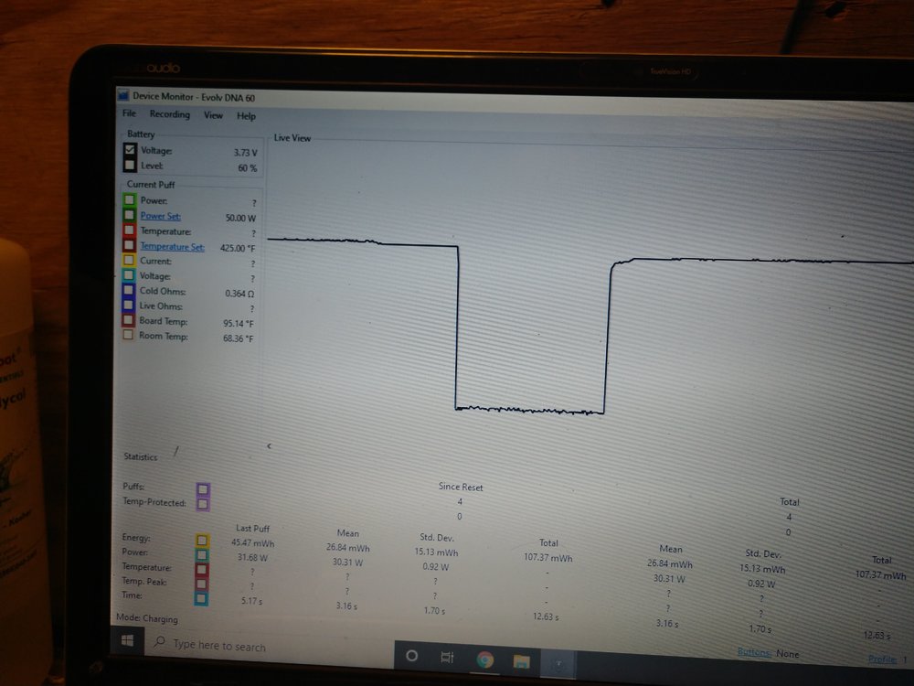

  9. Just adding another, less cluttered device monitor pic

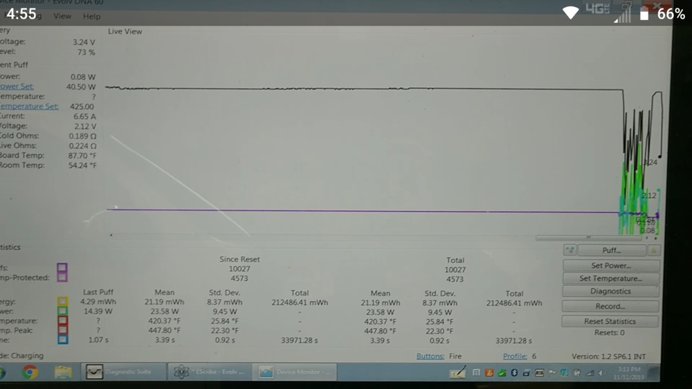

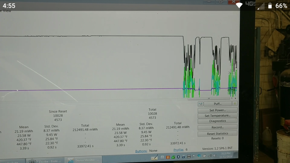

  12. So a couple years ago I swapped a dna 60 into a Hana v4. I got about 10k hit count and it started cutting out and making weird buzzing sound when firing. I stuck it in a drawer and ran my silo 75c. Fast forward to Saturday and my silo either got lost or stolen while we were in town getting groceries. I'll try posting a short video of device monitor while firing. I resoldered the power in and out connections, tried 3 different batteries that work well in other devices. I haven't Vaped over 45 watts for years, usually 37-40.
