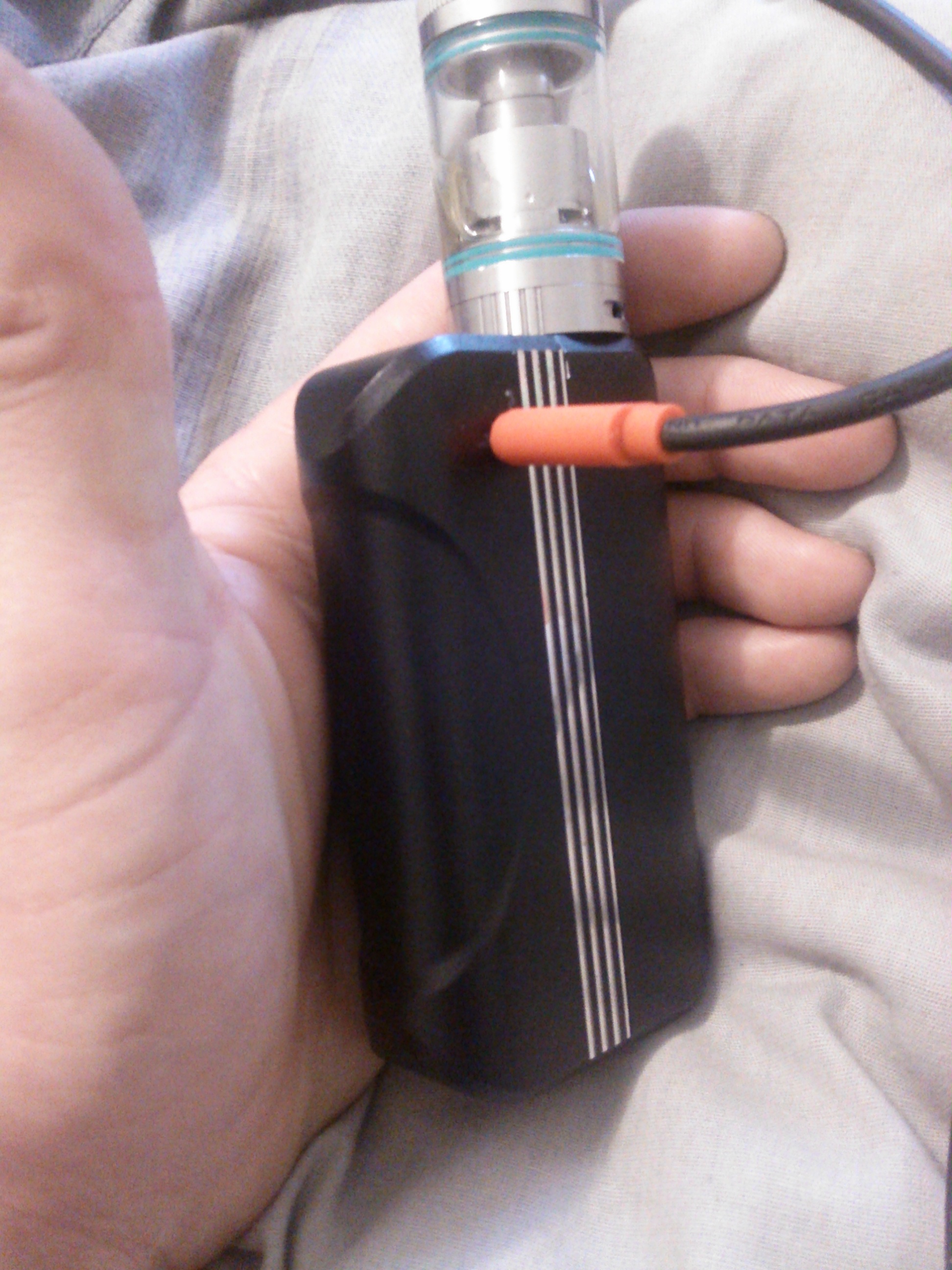

nice, an official dna 75 build thread. thanks dwcraig1! i hacked open a dead vt200. sent the dead board to evolv for replacement. rather than putting the replacement board back in i decided to put the 75 board inside. modifications required to install board are : chop off plastic oled screen stand offs (dna75 board components get in the way of it sitting flush), rewired/re-soldered stock 1300 mah 3s lipo for 1s 3p config (2898 mah according to battery analyzer). i'm bypassing the onboard usb charging ic for a higher (2) amp combo i put together. i dremeled/installed the usb socket on the side of the mod (limited space for it). my dremel skills are.........not great. that's about it. really enjoyed building this. plenty of current available to the board with this batt and the 3p lipo charges fast at 2 amps.
unfortunately the dna 75 will not display usb charge current. that option was only for the 200. the selection you made is for the current your atty is drawing. only options for the charging screen are batt percent and voltage (that are useful for charging purposes.). if it's any consolation i thought the same thing till i dug a little deeper. would have been nice but the simple TI ic charger on the 75 doesn't have all the bells and whistles like the 200's balancing ic.
