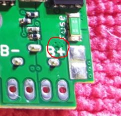

Just a stab in the dark here: Notice how the positive wire is soldered. It "appears" that the positive wire is directly over the top of some "vias". Could this be causing an unintended short?
Keep digging, not sure what the answer is, but it is something unique to your particular circumstances. I have 5 DNA200s, all in regular use, all using NI200, and all work fine without a single issue yet that wasnt of my own doing.
