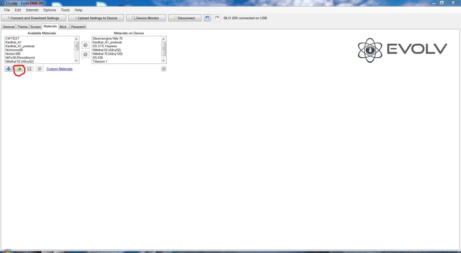

  24. Use the button circled in red. but with resister wire such as Kanthal the device will recognize it as such. No CSV file is needed for Nichrome or Kanthal. Your attached CSV file is of the type used....btw
