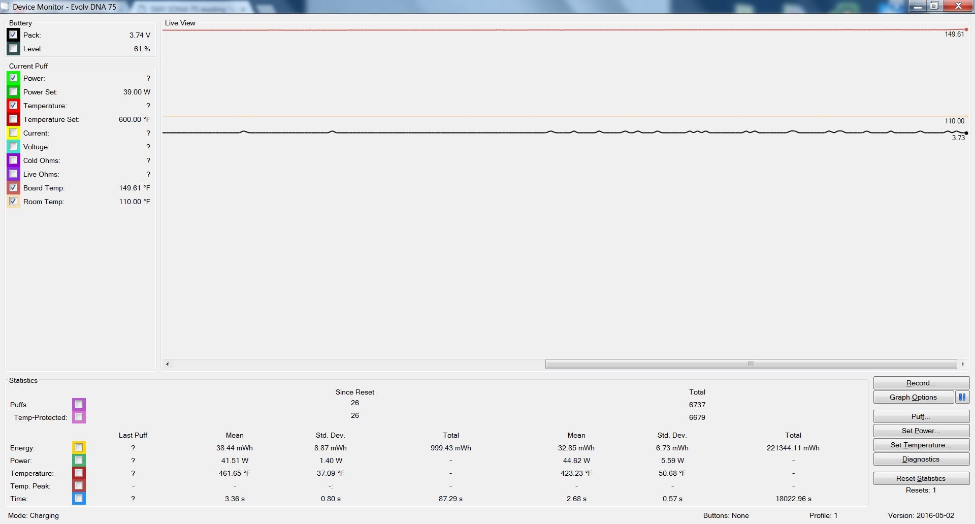

EDIT: fix found and posted in #6 below. I have several DNA75 and 200 mods and have never seen this before. I have about 8 Freemax tanks tanks that I use in rotation all using the same .15 NI200 coils running between 38-45 watts on all my mods. The other day, after a few pulls, the mod read 'too hot'. The board shouldn't even have been much higher than ambient at that point. So, I plugged into escribe and the board was reading over 180F and room temp displayed 110F. It was about 68F outside. I tried soft reboot, nothing. Hard reboot, nothing. I was only successful in removing the error by updating the firmware (same version). I then went to use it, and again, after 5-6 pulls, it read TOO HOT. this has happened 4 times in a row now. I am not fully in-tune with escribe and its far reaching capabilities, as Iv'e only used it for basic programming changes. Does anyone have any knowledge of this, and a fix? Or, based on this just continuing to occur, is the board faulty? thanks,
