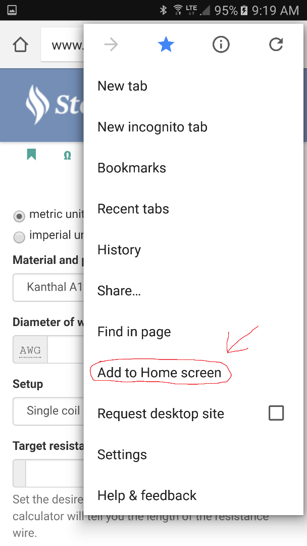

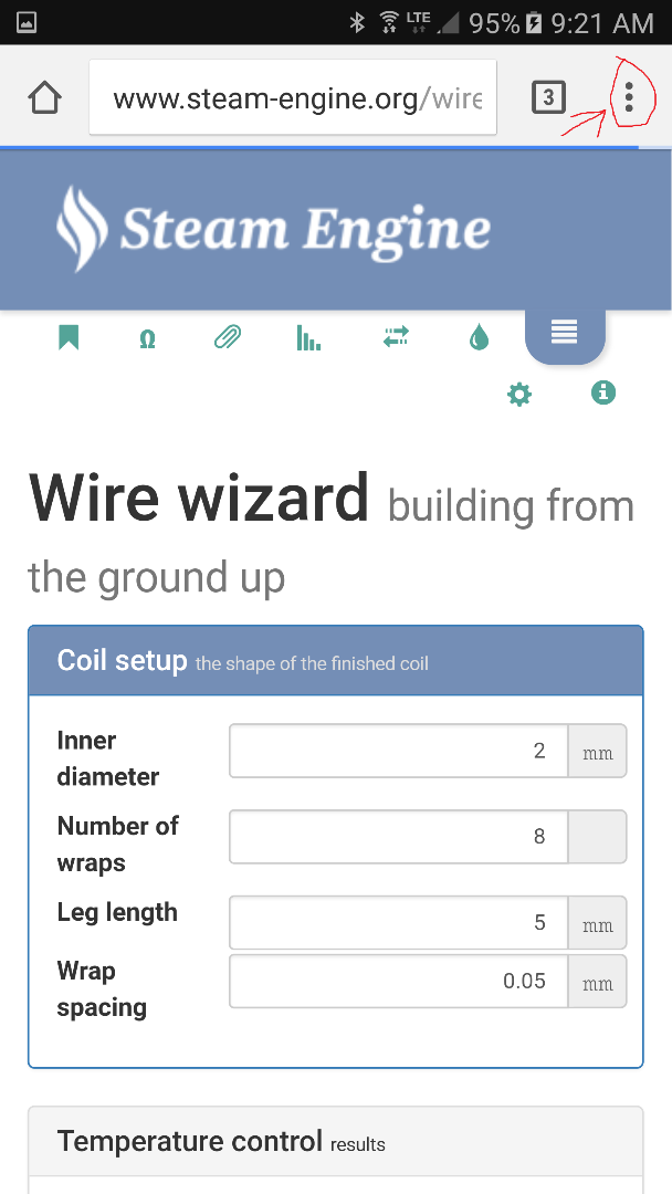

	I'm sure alot of you DNAer's out there know about this, but not having found any info in the forum about this thought I would just throw this out there & share. You can save Steam Engine to a home screen on your mobile device & it only takes a few seconds. I only have Android devices, so can't verify if it works on Apple or IOS devices. If someone can chime in to let everyone know if it works on those devices as well... The pictures I have attached will show you where to perform this task... Open the browser on your device & head to www.steam-engine.org. At the top right of the screen, you will see the 3 vertical dots (more link)...tap on that...about 3/4 way down the list, you will see 'Add to Home Screen'...tap on that... A widget (icon/link) will be added to the next available spot on your home screens. You can actually set it to go to the page of your choice on Steam Engine..for instance...the screen I use most often is the 'Wire Wizard', so, whichever page you are on when you create the widget is the page you will be taken to. You can still navigate to the other pages as well. Also, it will not utilize your devices browser & can actually be opened when not even having internet access...

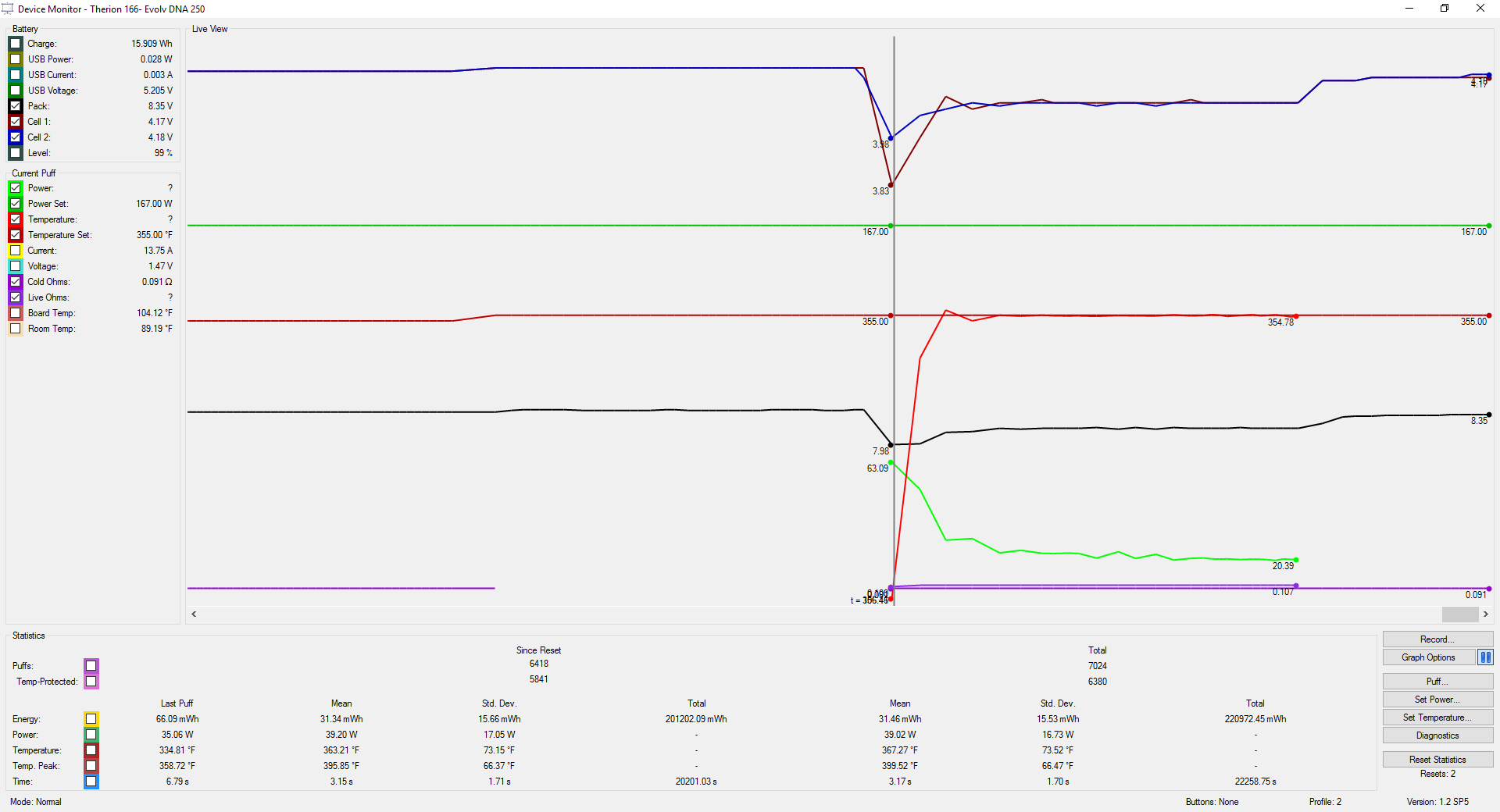

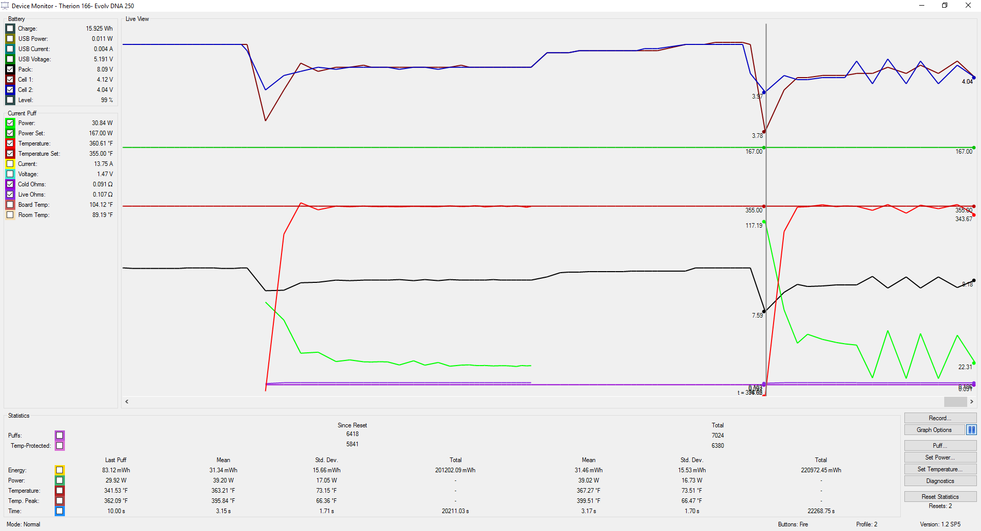

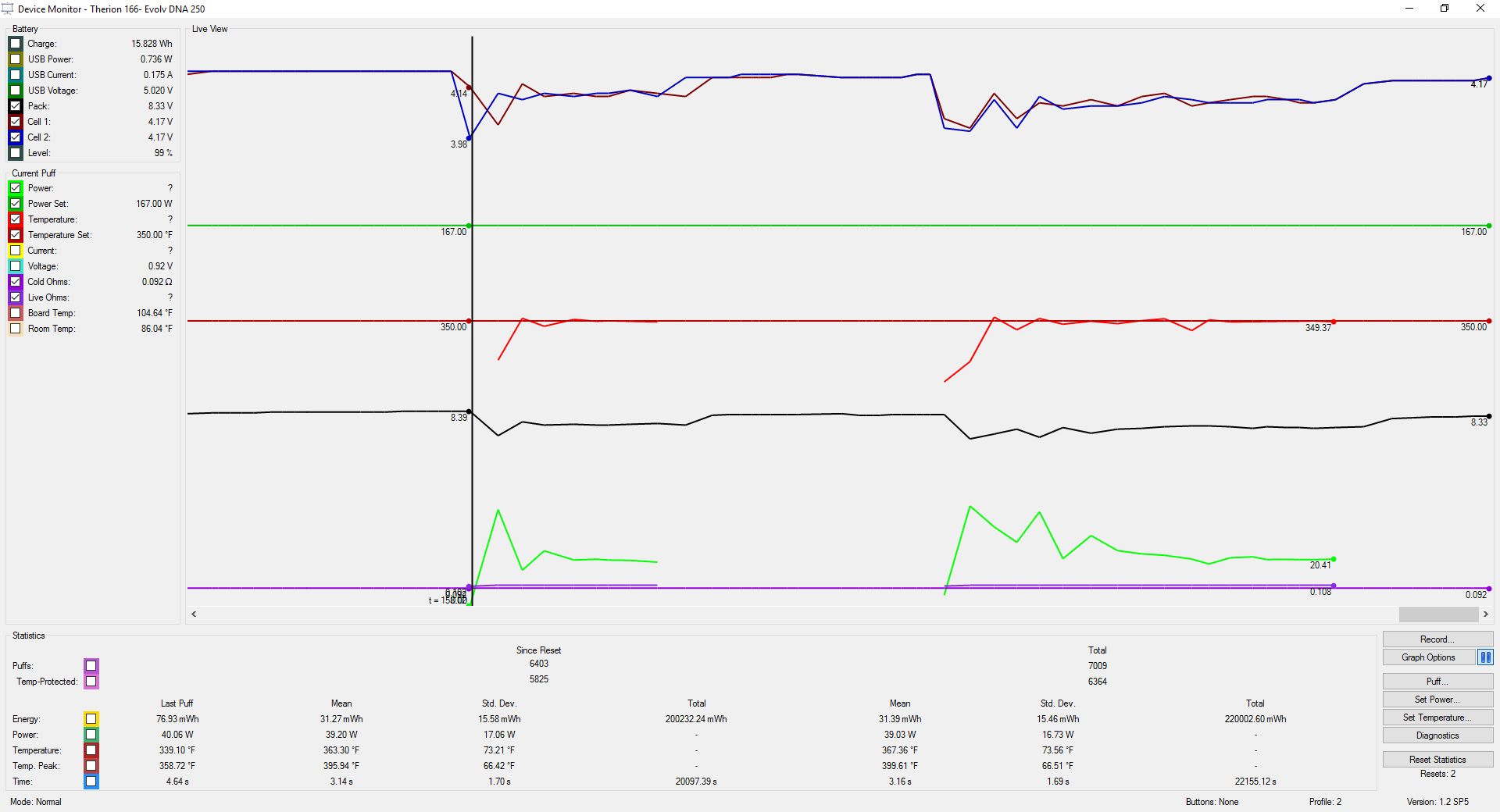

	On the left side of this screenshot is the previous 10 sec. puff using device monitor & on the right side is me pressing the fire button
	Here is new screenshot...10 sec. puff using the puff function in Device Monitor...not even touching the device & everything is looking normal again...haven't changed any settings.. .
	ChunkyButt200...those 2 screenshots are of the sag when firing...2 different fires but they fit on the same screen so took 2 screenshots so that I could move the marker from one fire point to the other... Wayneo...haven't changed anything yet...but now the device is firing normally again...
	Ok...haven't changed any settings & now it seems to be back to normal...this is about how this seems to happen. This is longest it has acted like this, was never able to get screen shots before. Here is a new screenshot ...

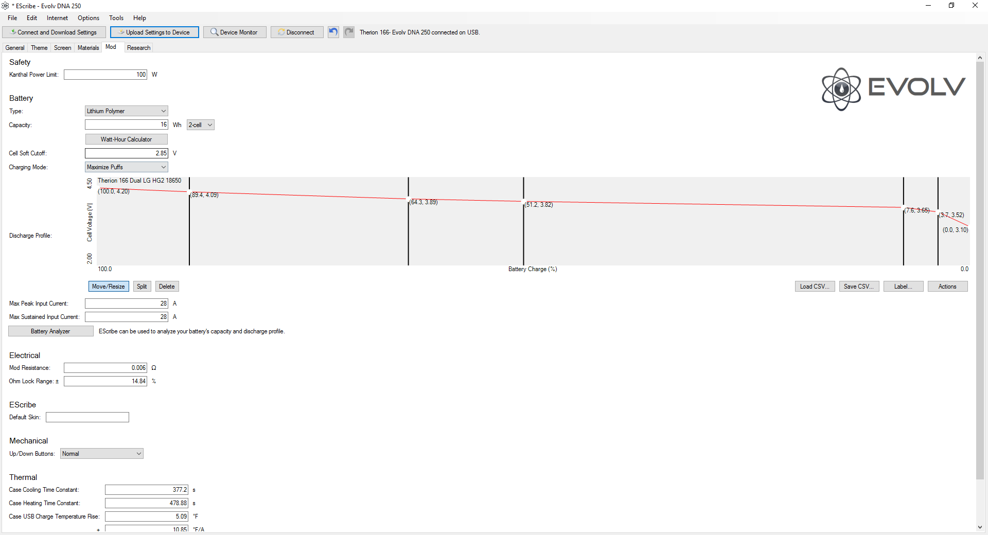

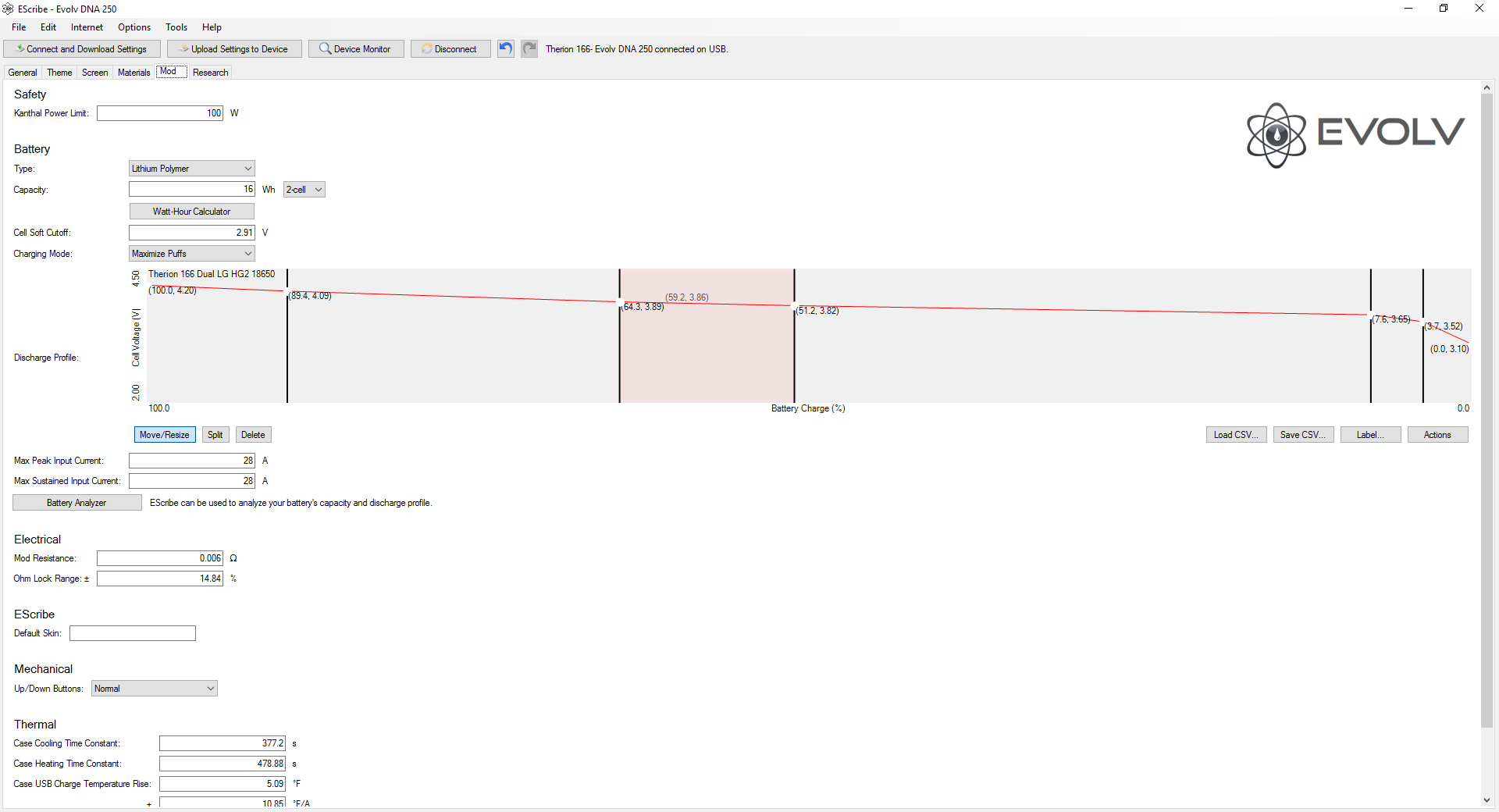

	Cell cut off is set at 2.91...attached screen shot of mod settings. Changed out with fresh batteries...screen shot of device monitor after battery change out

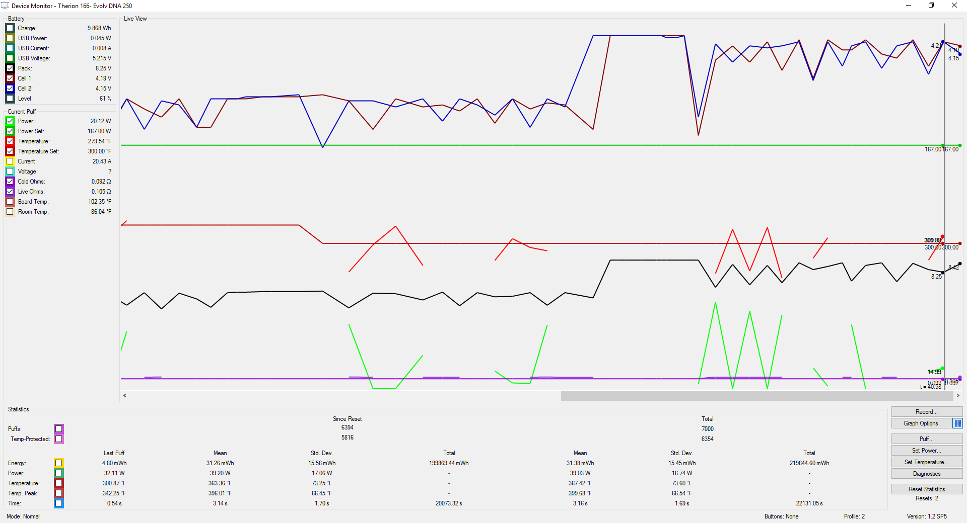

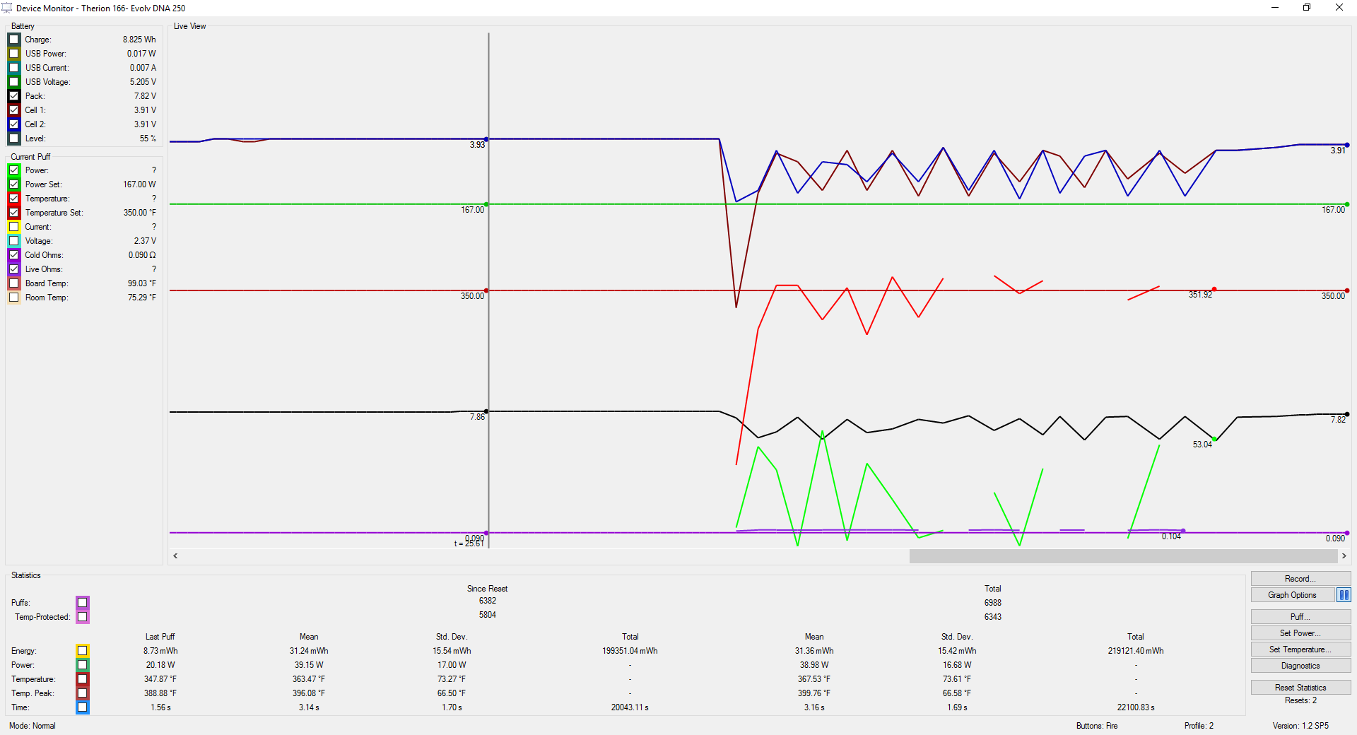

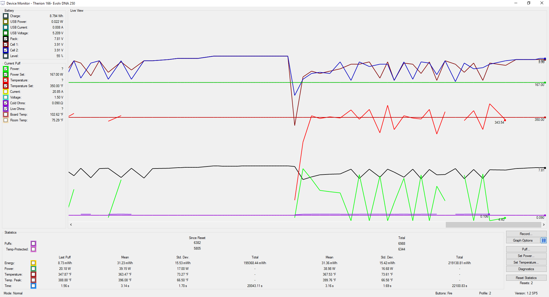

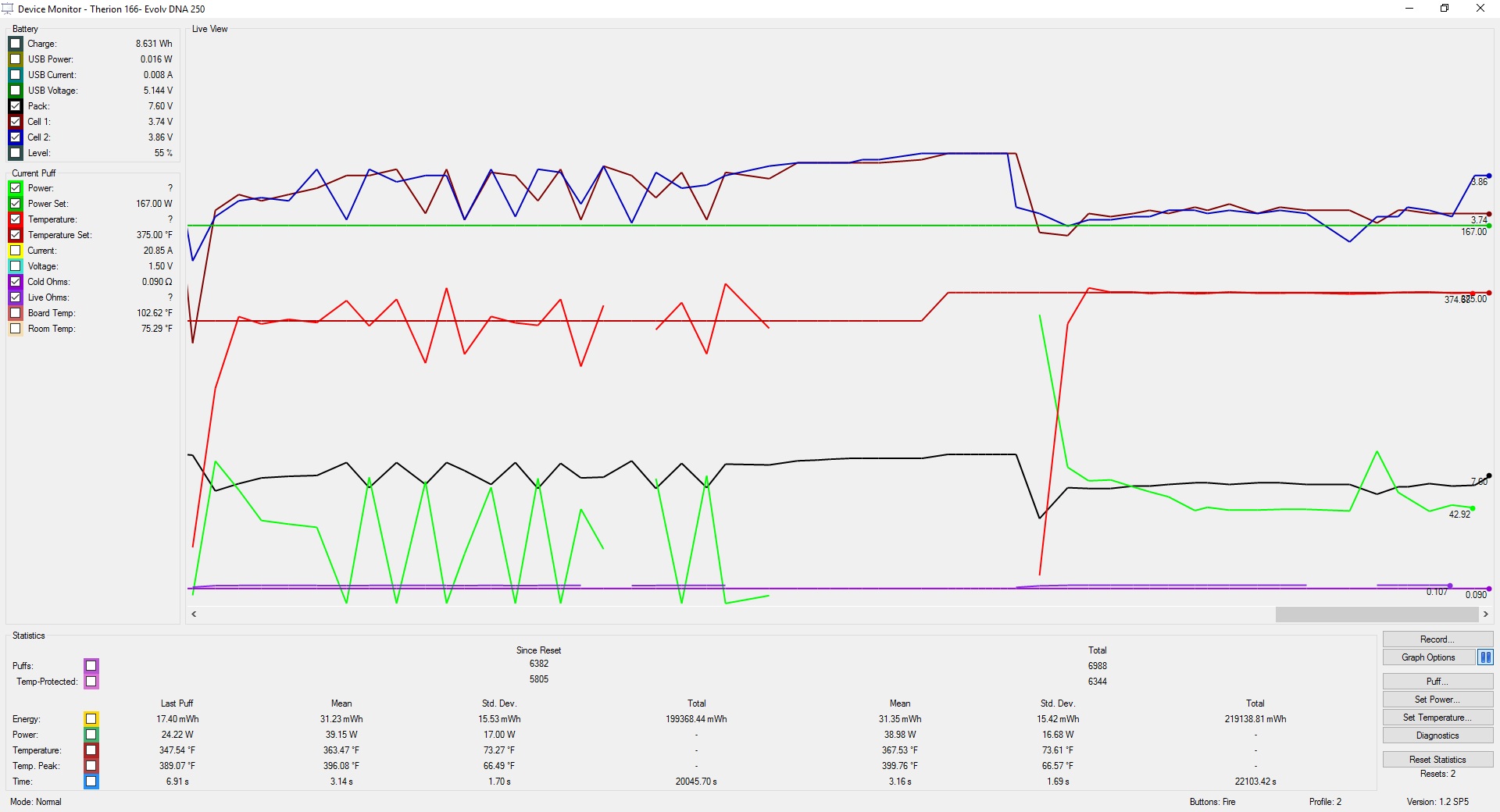

	Hey guys...have noticed a few times that I could feel the pulsing of the device & temp rising & falling. Was finally able to catch it on Device Monitor. Seemed like every time I tried before, it would clear up. This is on a Therion 166, 250 chip, SC Aromamizer, dual coil, 24g, 316L, about 6 or 7 wraps & clocking in at .09 ohms. In the screenshots attached, you can see the fluctuation when at 350F, but when I cranked it up to 375F, the fluctuation stopped. The third screenshot shows when I cranked it up to 375F. Every thing bounced around with it except for the cold & live ohms. Atomizer analyzer showing stable build. Checked all connections, etc... Any ideas? Edit...It has happened on different atty's as well, not just this one
