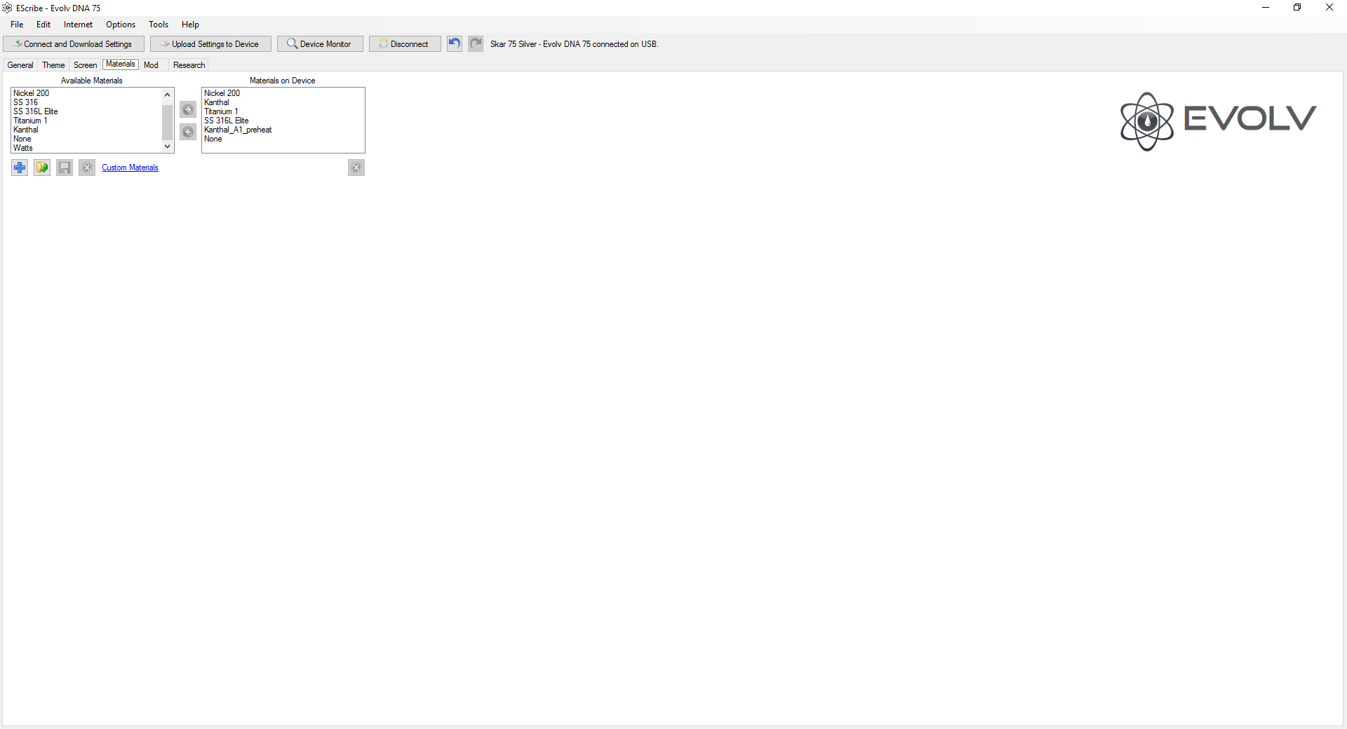

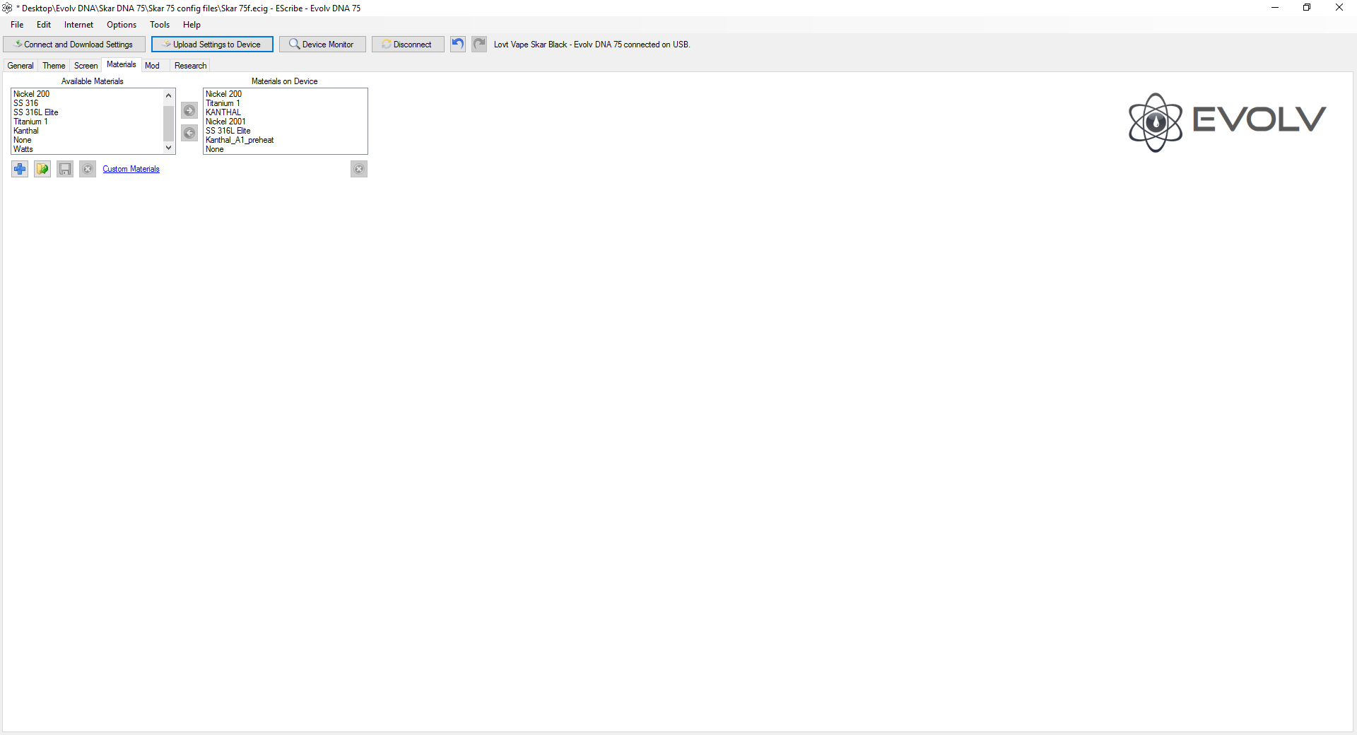

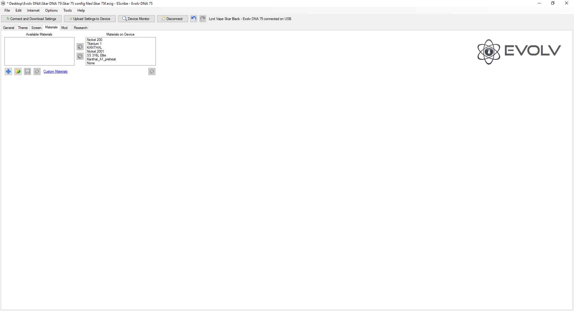

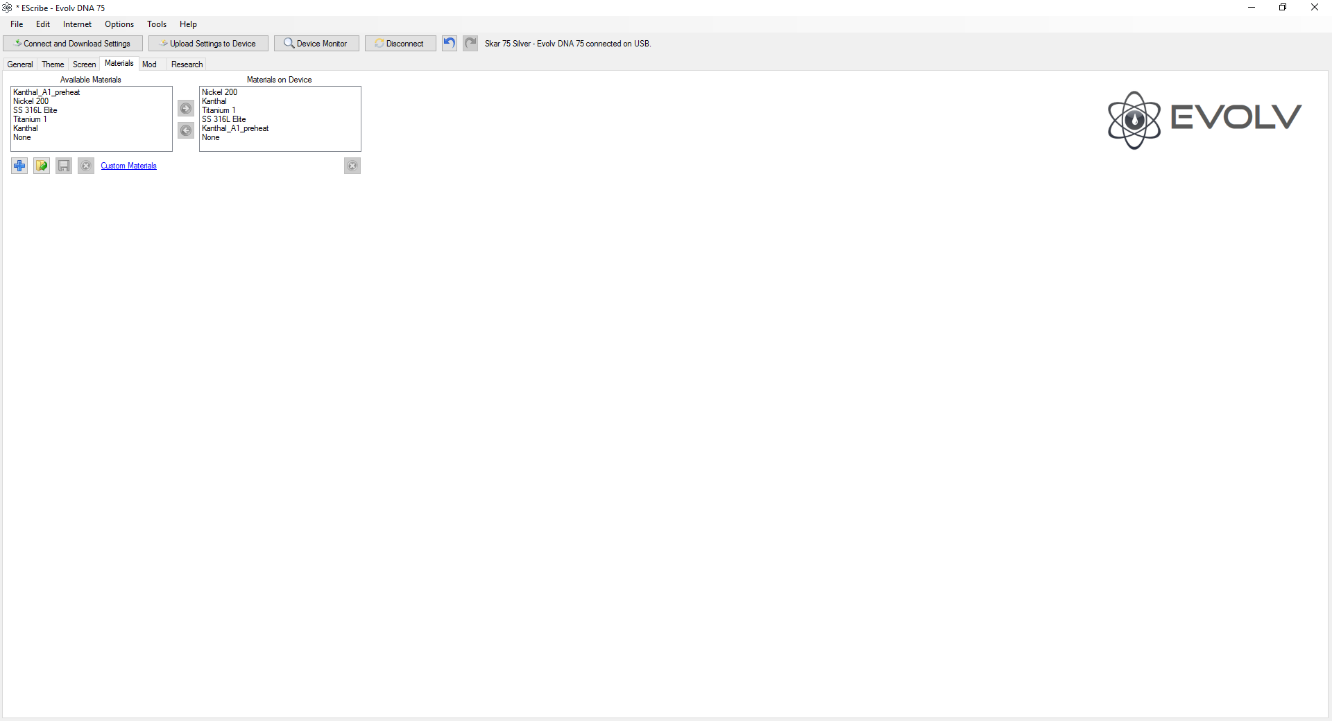

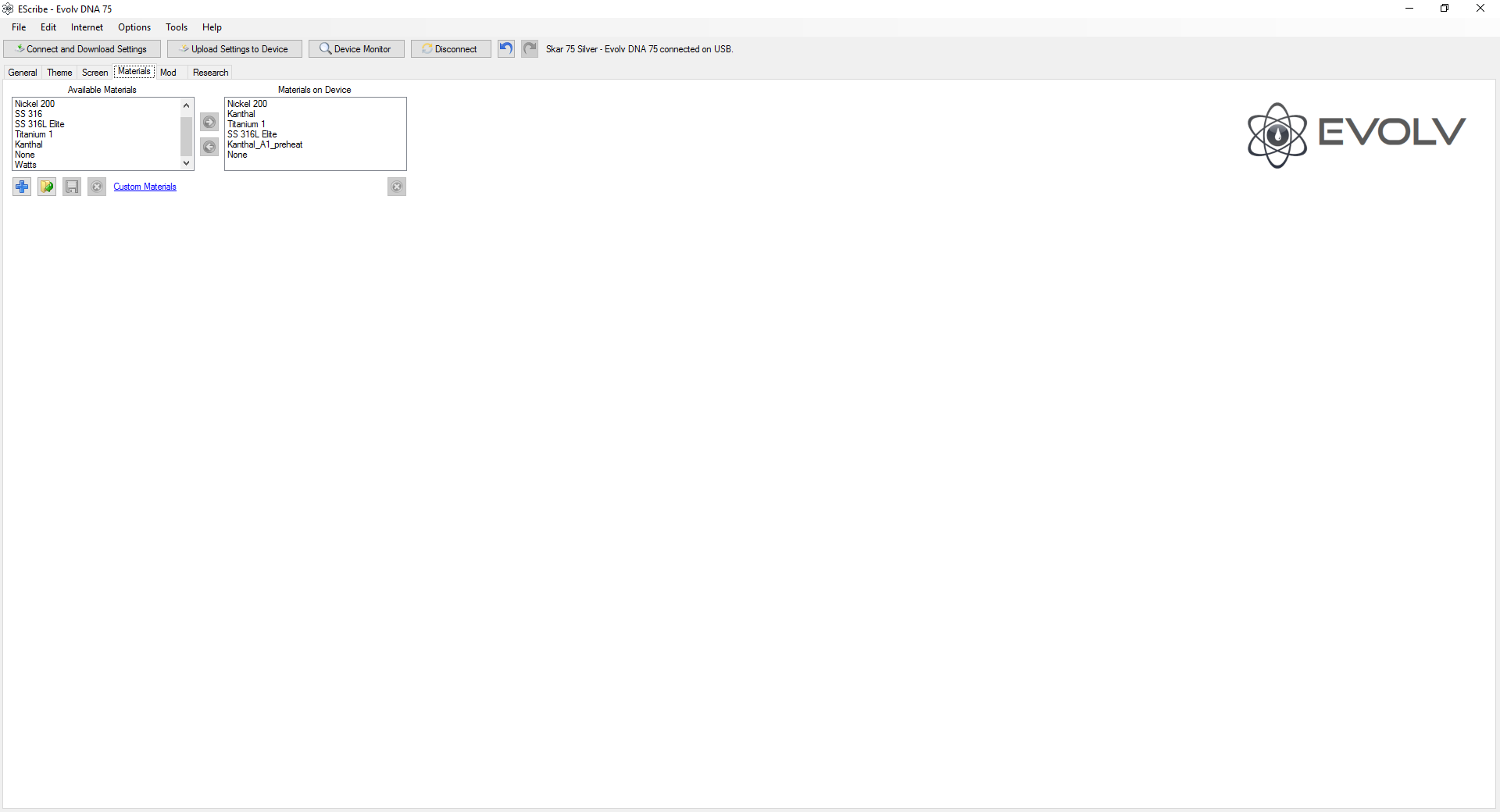

Ok, tried something else...in the first screen shot here, this is a restart of Escribe. The second screen shot, I deleted everthing in the 'Available Materials' list & the third screen shot is of a restart of Escribe. -

I save the .ecig files for the device & for Escribe every time I make any changes so as to be able to roll back to previous settings in case of a major mistake or something I didn't like. The materials I am trying to delete, from the 'Available Materials' list don't even show up as an option when setting up profiles because they are not on the 'Material on Device' list. These are a couple of materials that I will never use & was wanting to just remove from the 'Available Materials' list. When I realized that deleting them wasn't working, I tried renaming them instead & even that didn't work because upon restarting Escribe, the names were reverted back to the names prior to my changing them. If you take a look at the screen shots again, you will see that I am attempting to remove...SS316 & watts. If I delete or rename them in the 'Available Materials' list, when I restart Escribe, they are back as before. -

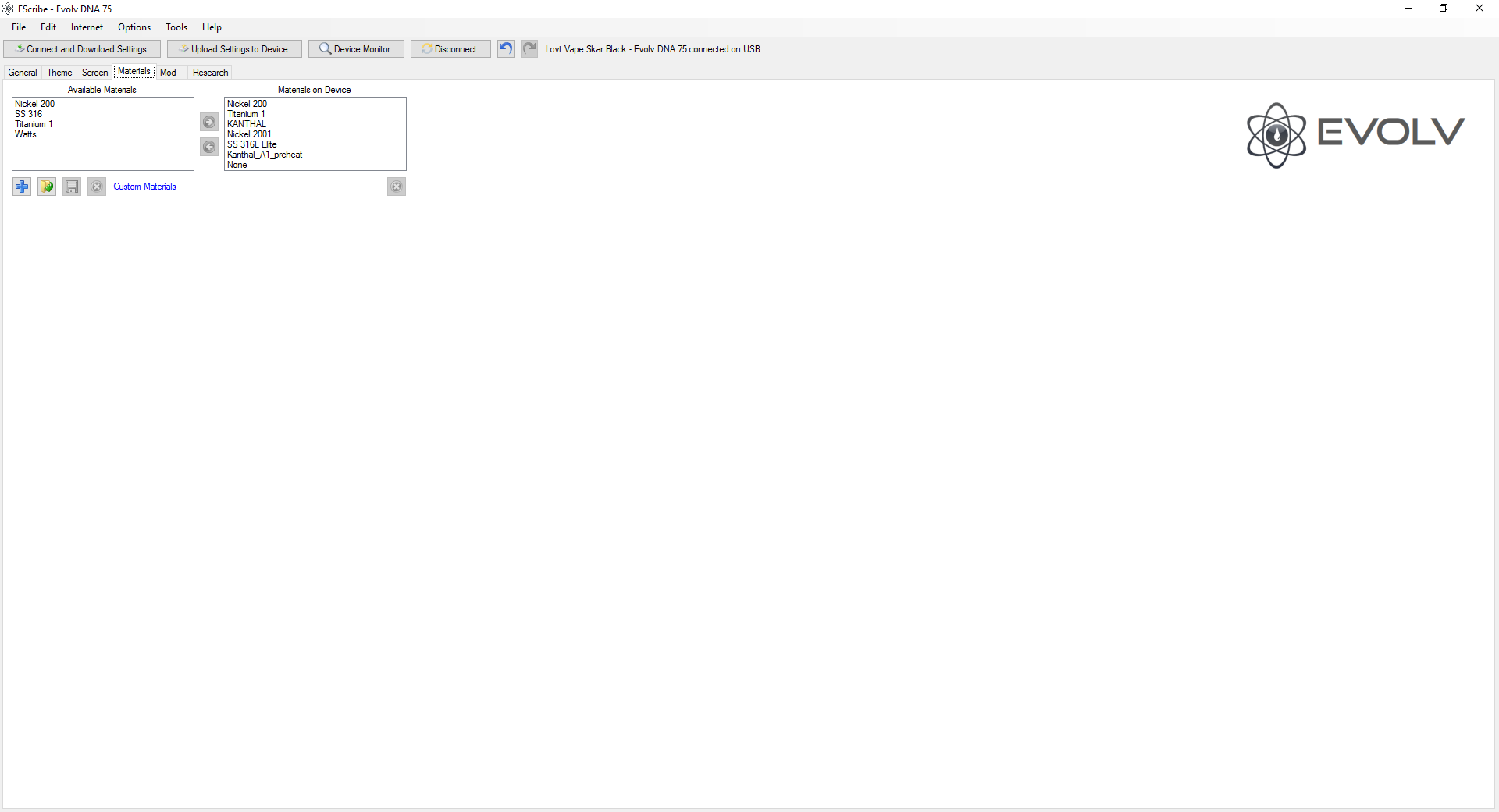

I looked & didn't find a thread or info on this. When I try to either delete unnecessary materials or rename materials in the 'Available Materials' list in Escribe, upon restarting the software the materials are back & the names have been changed back to the previous names. I have saved everything prior to shutting Escribe down. This is only happening in the 'Available Materials' list, not the 'Materials on Device' list. Seems like, if you delete or change something it should restart with the same list as you left it, or am I missing something here? The first screenshot attached is of a fresh start of Escribe...screenshot 2 is of after the deletions & screenshot 3 is of a fresh restart of Escribe. These are after trying to delete materials. The same thing happens if trying to rename a material. Edit: Forgot to add that this happening in both 75 & 250 versions -
