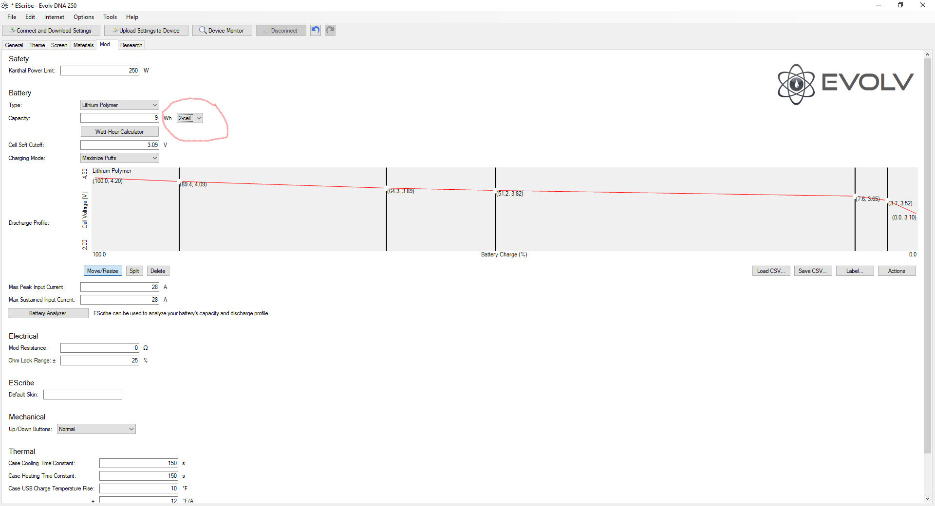

The device is looking for a 3rd cell that isn't there, changing it to 2 cell & uploading settings to device should have you going...here is the .csv file for the 25r batteries... Samsung_25R (2)_18650_2500 mah_16.92Wh.csv ....download this file & save to your computer...on the Mod tab, click on 'Load .CSV' & then select this file...in the 'Wh' field, enter 16.92...in 'Cell Soft Cutoff', enter 2.75...the LV default 'Mod Resistance' is .004
What kind of batteries are you using in your 166?
Ok, near the top of the screen, go to 'Option>User Interface' & then select 'Manufacturer'...that will give you the 'Mod' tab...on the Mod tab, make sure that it is set for 2 cell...then upload to device... Here is the factory Lost Vape .ecig file for the Therion 166 in case you ever need to restore it to out of box state... Lost_Vape_Therion_166.ecig Edit: When you hit the 'Restore Defaults' in Escribe, you reset the mod to the Evolv defaults, not Lost Vape's
Can you post a screenshot of the 'Mod' tab in Escribe & another of 'Device Monitor' with batteries installed. Make sure you are in the 'Manufacturer' UI so the complete 'Mod' tab will be shown... Edit: A better screenshot can be had by pressing 'PrtScr' on the keyboard, paste it into Paint & save, or using the Snipping Tool that comes with Windows...
