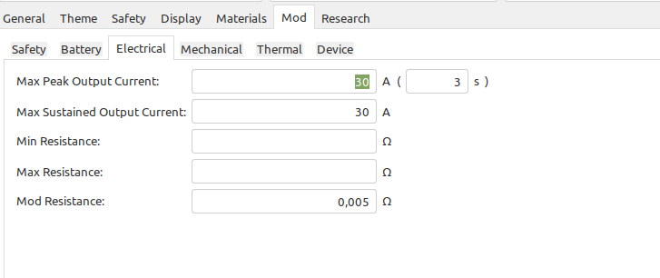

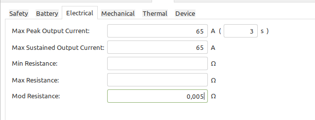

Wayneo Posted May 11, 2022 Report Posted May 11, 2022 On 5/10/2022 at 10:08 AM, rcamarda said: I did all procedures before. I should have written it since the beginning. Expand Just wondering what you have set for each mod's internal resistance. 2 screenshots is preferred.
rcamarda Posted May 11, 2022 Author Report Posted May 11, 2022 (edited) On 5/10/2022 at 3:35 PM, BillW50 said: I just randomly grabbed three mods and three tanks @rcamarda and I played switcheroo. Zeus X Kanthal Mesh 0.224Ω Hyperion DNA100C 0.23Ω Geek Vape Original Aegis 0.223Ω Geek Vape Aegis X Cerberus (not sure of the non-TC coil in there right now) 0.302Ω Hyperion DNA100C 0.31Ω Geek Vape Original Aegis 0.298Ω Geek Vape Aegis X Aspire Atlantis Ni200 0.157Ω Hyperion DNA100C 0.17Ω Geek Vape Original Aegis 0.161Ω Geek Vape Aegis X Of course, I could keep making the list longer and longer all day. But I am not seeing anything out of line here. So what does your resistance reads on your DNA mods when you set the wattage to 1 watt (for safety), have the Atomizer Analyzer reading live and you stick a screwdriver to short the 510 pin to the threads without firing the mod read? Don't worry about that spark if you see one. It is harmless to you. If you're curious what the Aegis X reads shorted, it reads 0.000Ω and errored Atomizer Short. Expand Here i am. Had to find the time to do some tests. The Odin Mini 75c reads 0,040. The VTBox 250c reads 0.038. Before testing with the screwdriver i did set the internal resistence to 0. Apart from the screwdriver test, since you mentioned the wire I'm using is a suprema ratio ss316 28GA wire. Edited May 11, 2022 by rcamarda 1
rcamarda Posted May 11, 2022 Author Report Posted May 11, 2022 On 5/11/2022 at 12:34 PM, Wayneo said: Just wondering what you have set for each mod's internal resistance. 2 screenshots is preferred. Expand Here the two boxes: 2
Wayneo Posted May 11, 2022 Report Posted May 11, 2022 On 5/11/2022 at 9:14 PM, rcamarda said: Here the two boxes: Expand Thanks for that. Both values look very respectable. Since you measured the internal resistances yourself I'm out of ideas. 1
