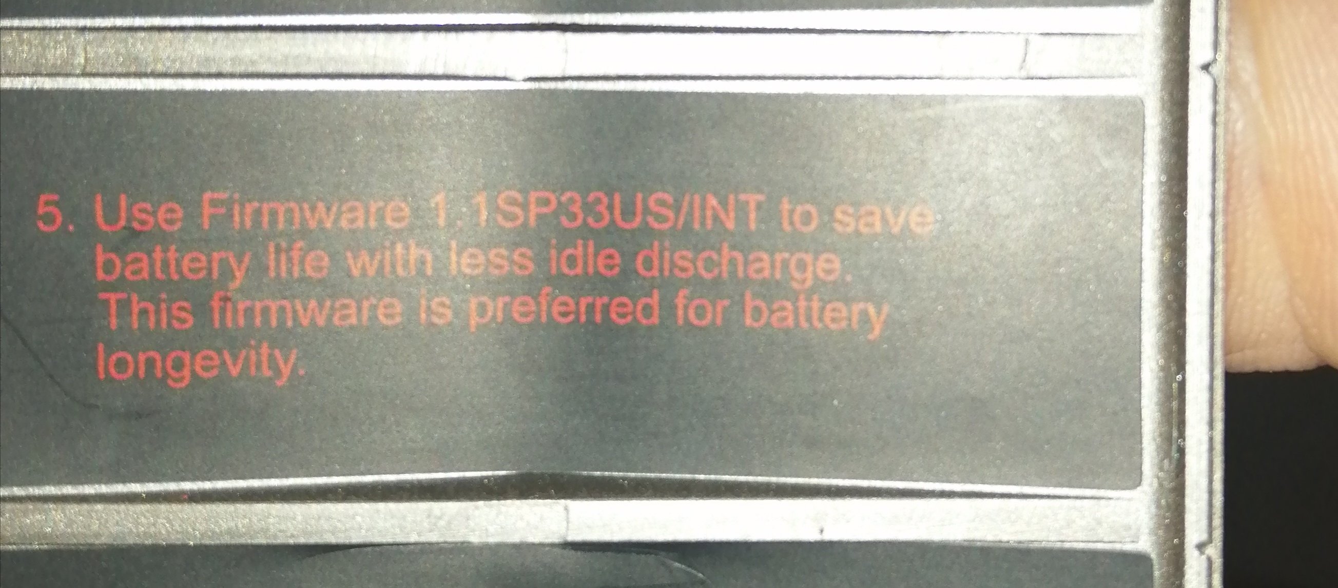

Then on the next charge I read the very small print on the side plate....not just a battery safety warning.
Use Firmware 1.1SP33 TO save battery life with less idle discharge. This firmware is preferred for battery longevity

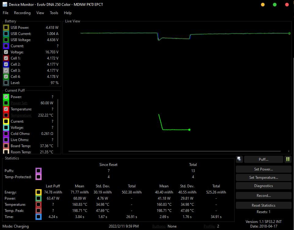

Why don'cha post a device monitor screenshot
Posted
Well, my battery charged to 100% according to the mod but then instantly dropped to 97% after 1 puff lol.
  • Like 1
Posted
At least all 4 cells look equal. 👍 Many mfgr's do not run the 'battery analyzer' for their batteries. I don't know if they did, but it will make that % value or an icon more accurate. Sorta like idiot lights in a car.

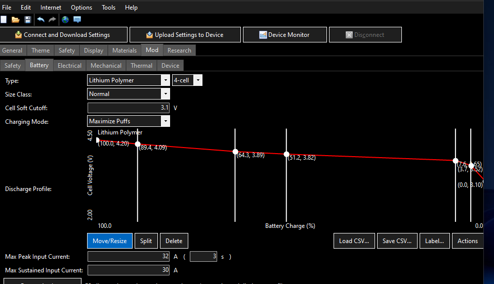

I have adjusted the battery curve with this CSV, this is for charging to stop at 4.1 volts per cell. It is adjusted to show 100% charge at 4.1 volts per cell. This is how I do all my Lipo powered DNAs, the battery will have a much longer life. Save your battery CSV first and give this one a try, you can always go back. Remember to upload the settings each time that you make a change and want it to stick.
Edit: Be sure to change "Maximum Puffs" to "Maximum Recharges and upload settings.

Device Monitor uses that battery curve voltage value for the Level % after the 4 cell voltages BUT
If you're gonna follow the screenshot @dwcraig1 showed, see that label in his pic that says 'Maximize puffs', that MUST be changed to 'Maximize recharges' for charging to stop at 4.10Volts
