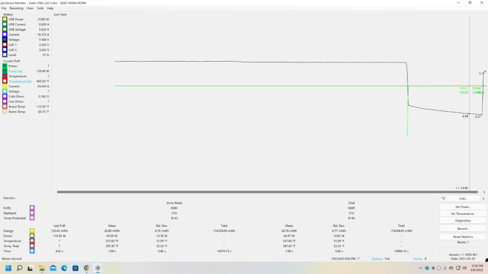

dwcraig1 Posted April 10, 2022 Report Posted April 10, 2022 Is it a weak puff just for the first puff when mod comes out of sleep or is it weak every puff? A screen shot like this one will be most helpful.
FlyingCustard Posted April 10, 2022 Report Posted April 10, 2022 12 minutes ago, dwcraig1 said: Is it a weak puff just for the first puff when mod comes out of sleep or is it weak every puff? A screen shot like this one will be most helpful. It’s every time, I’ll get an actual screenshot in a while but for now this is a potato quality shot from a video I took yesterday while trying other builds etc. as you can see on this it is a 0.20 and set above 90w but drops to 40w every time.
BillW50 Posted April 10, 2022 Report Posted April 10, 2022 The bottom right, it says what firmware version you are running. I can't read it, what does it say?

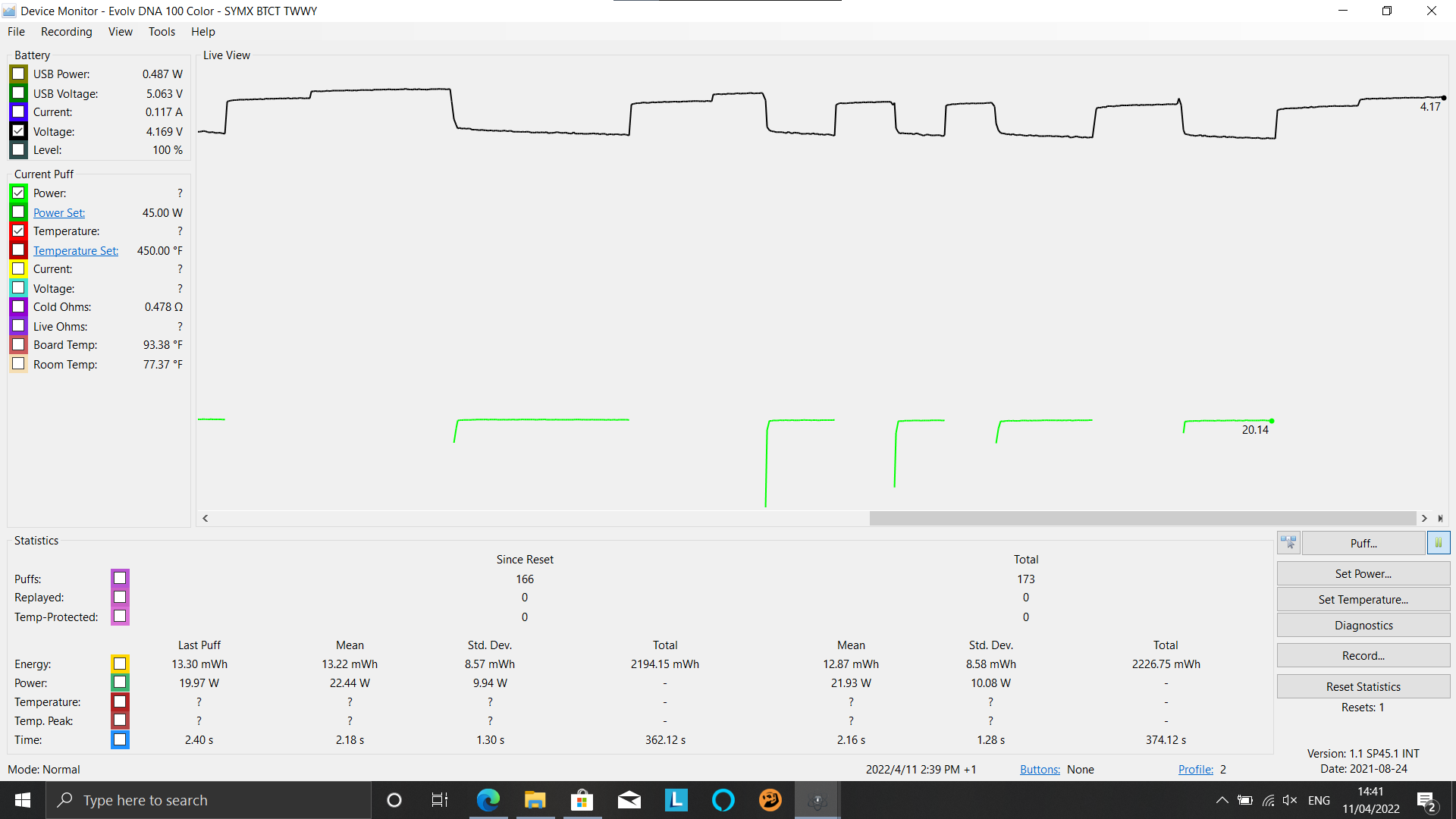

FlyingCustard Posted April 10, 2022 Report Posted April 10, 2022 17 hours ago, BillW50 said: The bottom right, it says what firmware version you are running. I can't read it, what does it say? 1
BillW50 Posted April 10, 2022 Report Posted April 10, 2022 Oh... it isn't using an early beta firmware that had that same problem. Does it putout say 20w if it is set at 20w? I am wondering how low you have to set it before it puts out the correct wattage. The battery is fabulous, firmware is fine (SP45.1 INT)... the only thing left is the board.
FlyingCustard Posted April 10, 2022 Report Posted April 10, 2022 (edited) 18 minutes ago, BillW50 said: Oh... it isn't using an early beta firmware that had that same problem. Does it putout say 20w if it is set at 20w? I am wondering how low you have to set it before it puts out the correct wattage. The battery is fabulous, firmware is fine (SP45.1 INT)... the only thing left is the board. If I set it to about 18w it will mostly seem correct but as an example when it was on 0.71 coil it would act as if it was stuck in some kind of bypass mode and only give 12w-13w I have contacted the modder who says I can send it back and they will check it but at the same time this device was apparently tested before sending….. edit: as one can imagine after spending £150+ to receive a aesthetically flawless device that doesn’t work as it should I am pretty disheartened Edited April 10, 2022 by FlyingCustard
