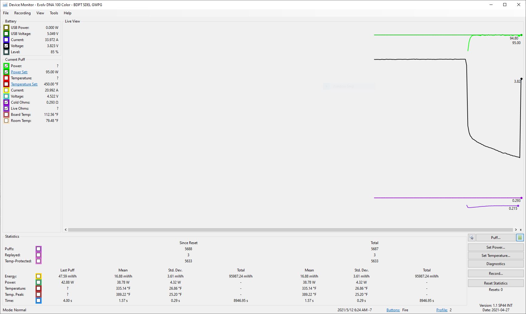

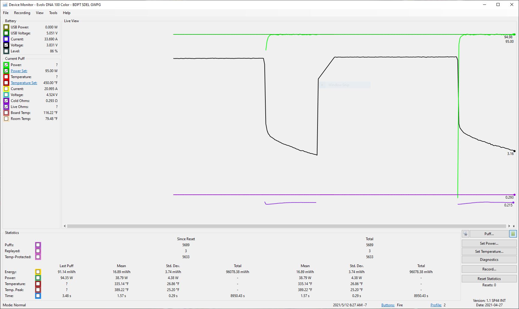

dwcraig1 Posted May 12, 2021 Report Posted May 12, 2021 My DNA100C has an 18650 Samsung 20S (30 amp) at 90% charge here. I don't have any Kanthal or Nichrome heavy enough to get really low resistance so I used some dual core SS 316 Claptons in dual coil configuration. Both firings was with the screen timed out (off) 1

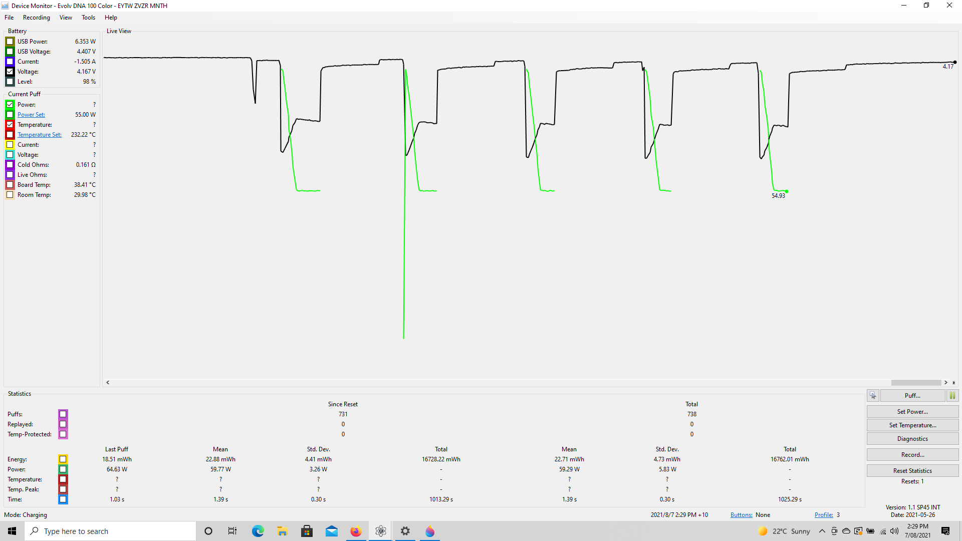

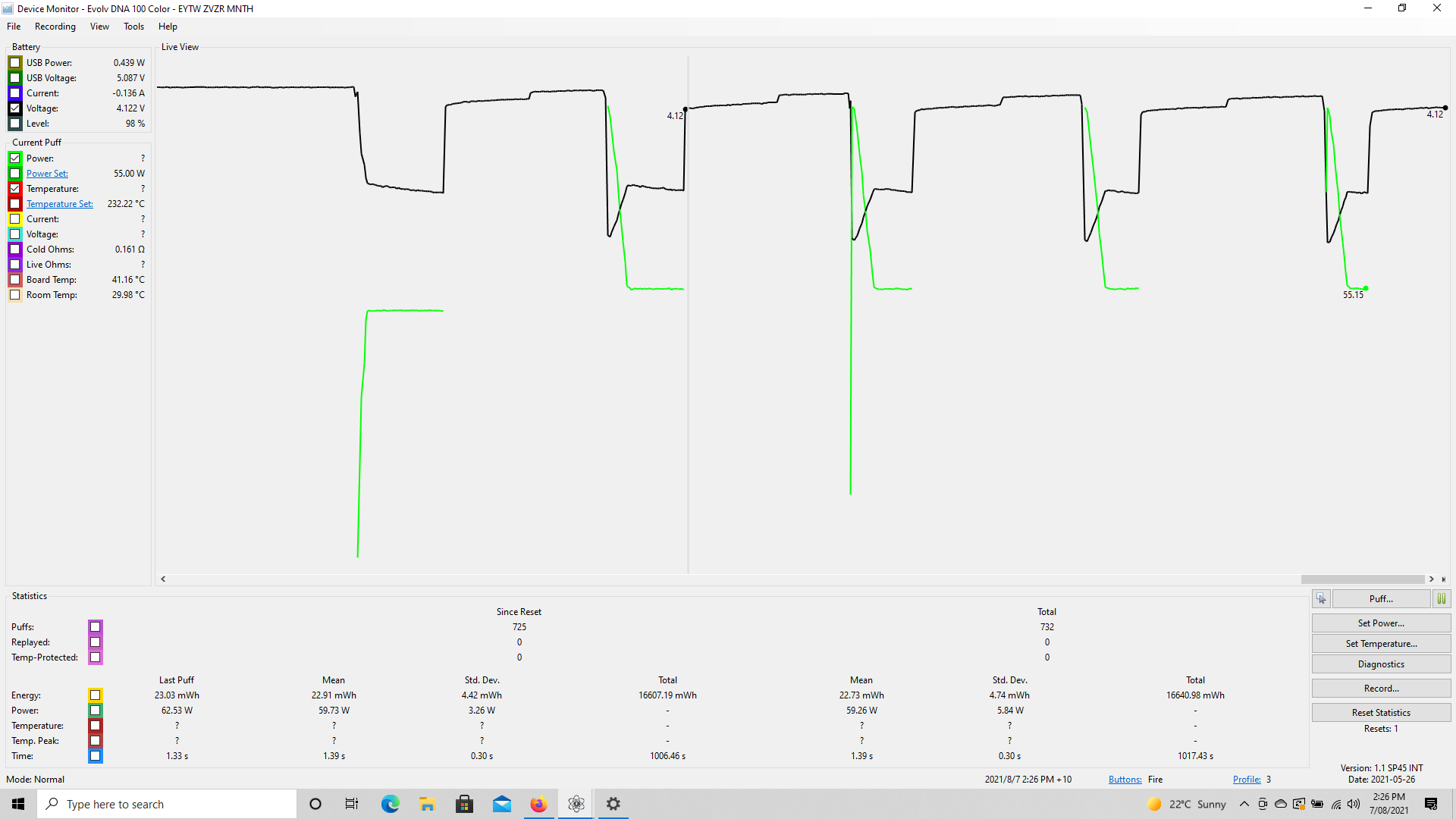

Psyentist Posted August 7, 2021 Report Posted August 7, 2021 (edited) Here are two photos from device manager, the first firing from the screen turned off and the second after clicking the fire button first to turn the screen on. Also, is there a place i can download the previous service pack from? In escribe\tools\apply service pack it only comes up with the current one. Thanks in advance for any help. Edited August 7, 2021 by Psyentist
