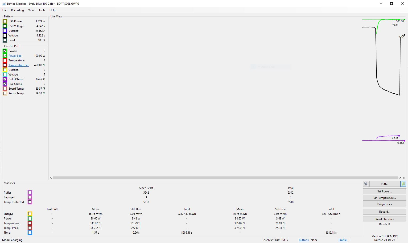

dwcraig1 Posted May 10, 2021 Report Posted May 10, 2021 If you can provide us with a snippet like this we very well may be able to see what's going on. Perhaps tomorrow I'll set up a much lower resistance coil and see if I can reproduce it. 1

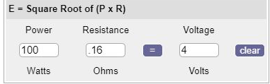

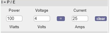

dwcraig1 Posted May 10, 2021 Report Posted May 10, 2021 This is in reference to the coil in the video (0.16 ohms) It will take a good high amperage cell with good battery sled contacts to achieve 100 watts with that coil. I left out the one were it calculated to 4 volts but that's what it came out to. https://www.the12volt.com/ohm/ohms-law-calculators.asp 2

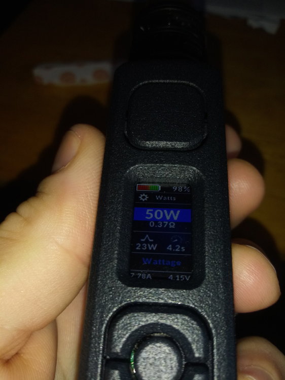

Michael Guercio Posted May 10, 2021 Author Report Posted May 10, 2021 Mine just did it with stealth mode on & a samsung 30T true 35amp batt..
dwcraig1 Posted May 10, 2021 Report Posted May 10, 2021 13 minutes ago, Michael Guercio said: Mine just did it with stealth mode on & a samsung 30T true 35amp batt.. What was the standing voltage of the cell prior to firing? 1
Joshua12345 Posted May 10, 2021 Report Posted May 10, 2021 Yeah that’s exactly how mine will do, it will do it with a fully charged Samsung 40t battery, I will have it set on sixty watts, and once the screen turns black, I will hit it and it will only hit at about forty. And it only does this part of the time. This is why I think it isn’t something it’s supposed to do. 1
Joshua12345 Posted May 10, 2021 Report Posted May 10, 2021 See, fully charged Samsung 40t and it was firing at 69, I had it set on 70.. but after the screen went black i fired it and it only hit at 42watts 1
Michael Guercio Posted May 10, 2021 Author Report Posted May 10, 2021 Yup definitely not suppose to do. Have you tried to contact Ginger Vapor about this. I did and they told me my build is too low lmao (.37)
Joshua12345 Posted May 10, 2021 Report Posted May 10, 2021 Yeah, kinda sucks cause I like realtor low builds, about as low as you can possibly run on 100 watts, but it messes up more the lower the build is. Does yours just do it randomly, or does it do it only once the screen shuts off?
Michael Guercio Posted May 10, 2021 Author Report Posted May 10, 2021 My build NOT low and it should fire a .1 with a 30amp batt. At least until batt hits 3.5ish volts. I understand "we" should be using a higher build in a single batt mod but should stipl work.

Wayneo Posted May 10, 2021 Report Posted May 10, 2021 @Joshua Can you post that theme as well later or under File -save. That'll have a .ecig extension. Device Monitor snip like DW asked. Are your batteries new? 1
Joshua12345 Posted May 10, 2021 Report Posted May 10, 2021 Yeah battery is now Samsung 40t with between 100-90 percent charge right now and problem is occurring. I’m gonna get it on the program when I get home, around five or six, could u give me explicit instructions on how to do this? The program confuses the crap out of me
Michael Guercio Posted May 10, 2021 Author Report Posted May 10, 2021 It did it with screen on, off & stealth. All my 30Ts are brand new via IMR and tried few different one's. Still does it.
Wayneo Posted May 10, 2021 Report Posted May 10, 2021 Start escribe. Go under "File". Click "Save". Post that .ecig file here. At the top of the screen you should see a message to apply a new service pack, click that, OR Go under "Tools", bottom one is "Apply Service Pack" follow directions. 1
