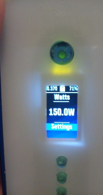

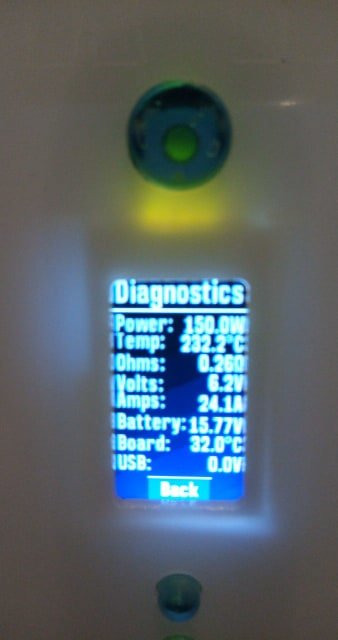

David B. Posted February 19, 2020 Report Posted February 19, 2020 So i just got a newly finished 4s lipo box mod with a dna 250C chip in it. when i put an rta on it it reads the coils at 0.37 ohms. wich is wrong. i know for a fact they are 0.22 when i go into the diagnostics menu on my mod and fire the mod there the ohms read out 0.26 which is much closer to the truth. so im wondering can i use the ohm readings in the diagnostic screen for the front screen in wattage mode by editing the theme in escribe ? or is there a way i can get the ohm reading to just be accurate to begin with? Thanks for any help you can offer me.

Wayneo Posted February 19, 2020 Report Posted February 19, 2020 Are you sure it’s nichrome? Looking at your diagnostics picture I can’t believe I’m seeing any value for temp. Yours shows 232C. 1
David B. Posted February 19, 2020 Author Report Posted February 19, 2020 19 minutes ago, Wayneo said: Are you sure it’s nichrome? Looking at your diagnostics picture I can’t believe I’m seeing any value for temp. Yours shows 232C. Yes, i made the coils myself. using nothing but nichrome. I re soldered all the connections, except for the grounding wire for the 510, as i dont have a 510 tightening tool at hand. but im getting one in the mail from the uk soon hopefully. so i can open it up and re solder it and tighten it firmly again. until then ill just use my other mods. bummer. paid 400 dollars for a mod, and cant even use it. thanks for all the help tho. oh and i did use 3 different attys, one was single coil. and still it showed the same wrong ohms. they all did.

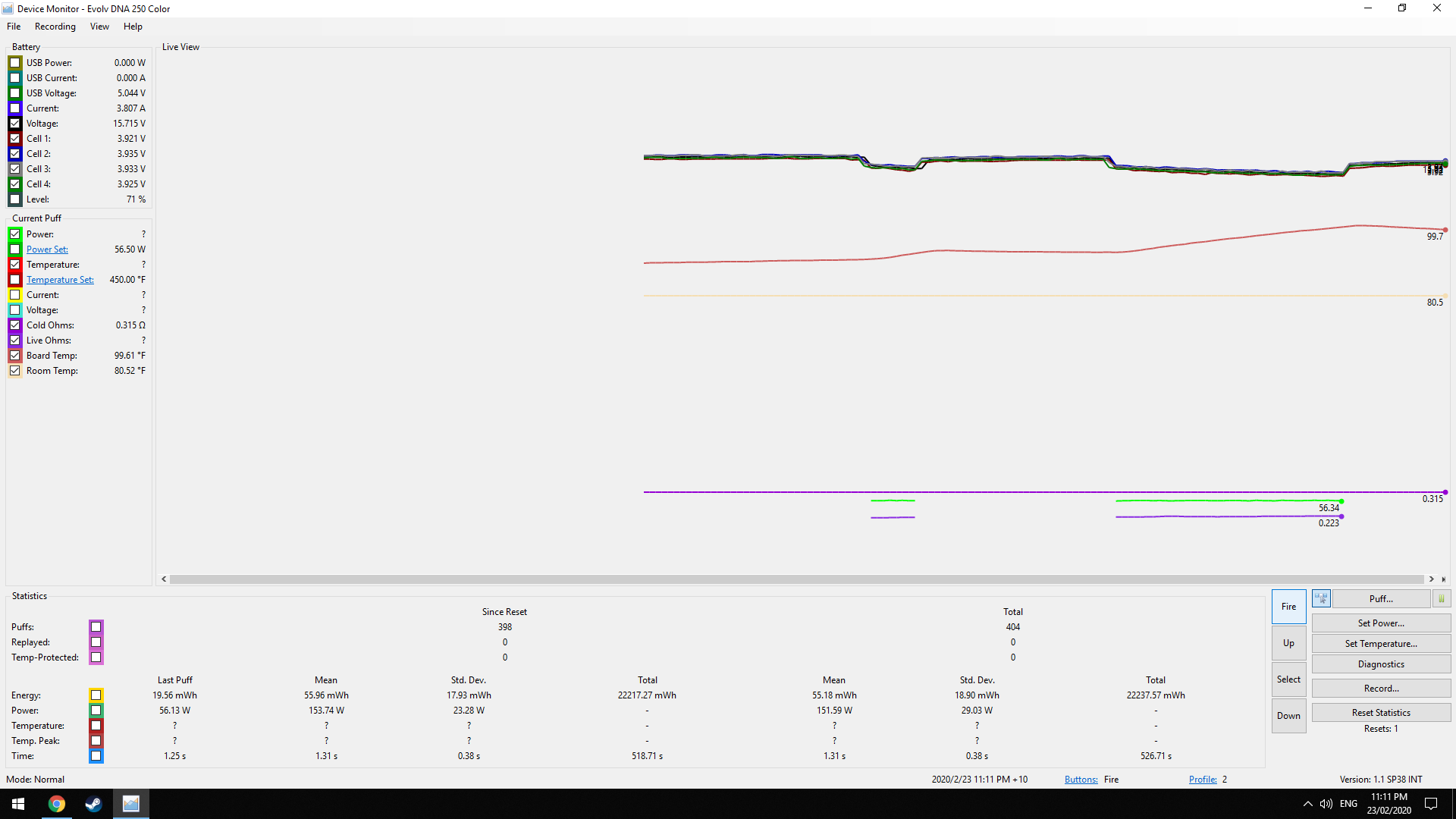

David B. Posted February 23, 2020 Author Report Posted February 23, 2020 Yeah si now i have a single 0.22 ohm alien coil in the mod, its reading the wrong ass ohms, as you can see in atomizer analyzer. But live ohms is correct. does this matter? is it stil "working" correctly or is there any danger to me or my mod or both? all i want to know is if i can stil use it? or is it vital that i get it fixed?
