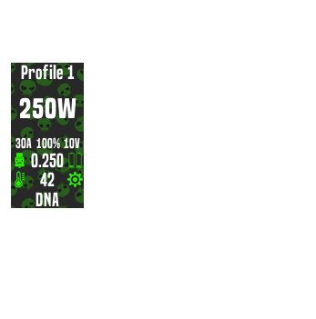

formula 1 Posted May 6, 2019 Report Share Posted May 6, 2019 you can go into escribe and preset the profile setting wattage and pre heat and replay on all other features that the material you choose can start off with like a basic level you cant start from like setting the watts to 50 or 60 and preheat options to a required level before altering them on the device , that's as much as a preset you can do - changing materials or swapping tanks will always trigger the new coil detected which you have to set - as the photograph shows where to alter the default levels 1 1 Link to comment Share on other sites More sharing options...

formula 1 Posted May 6, 2019 Report Share Posted May 6, 2019 (edited) on my theme or where it has the profile tab on top , here in the photo its called profile one where on the device it may say watts , SS316 or replay etc - to select this tab is what you do when altering wattage , you navigate the menu by the 3 buttons or two buttons on your device and the 2 outer buttons act as up and down and the middle is to select or highlight that particular setting as you would do for changing watts and once select you use the outer button again to change values or cycle the profiles Edited May 6, 2019 by formula 1 1 Link to comment Share on other sites More sharing options...
