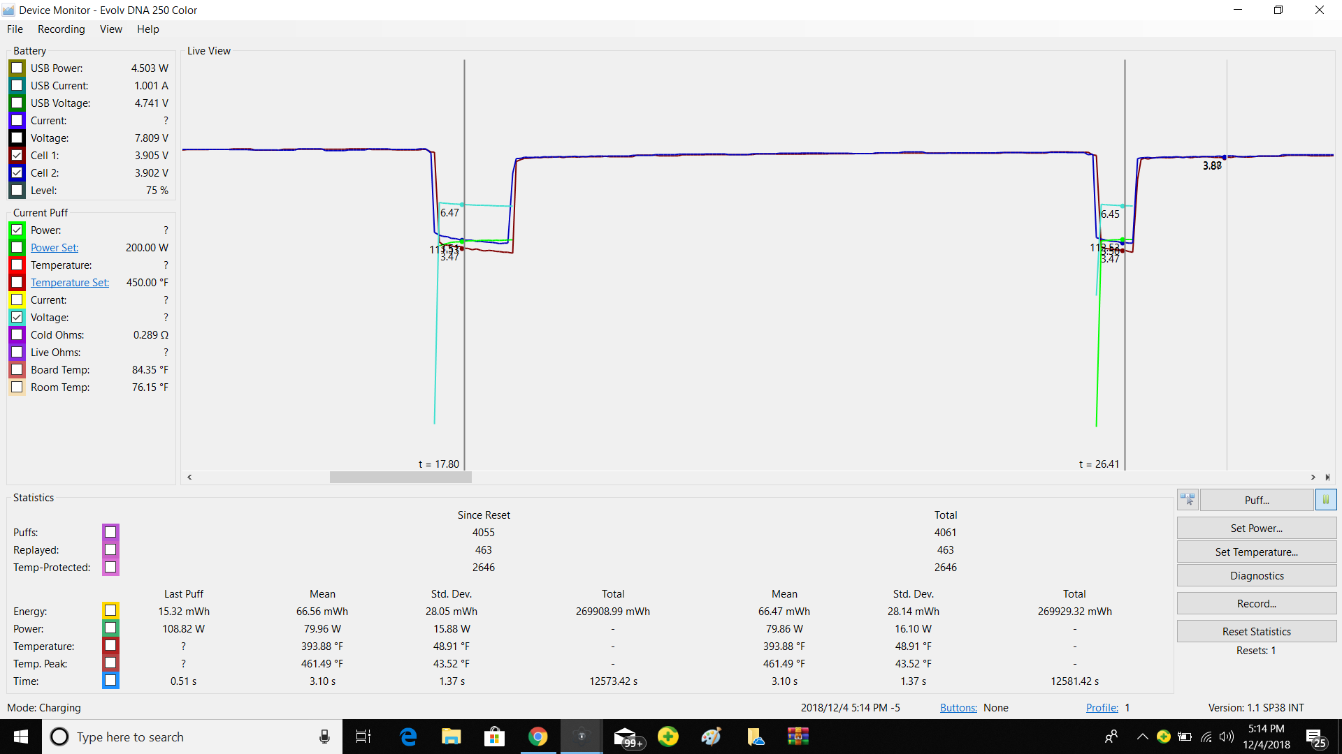

Spector NS5 RD Posted December 17, 2018 Report Posted December 17, 2018 45 minutes ago, S3mj0n said: Good to know. More than I thought. Max output voltage I achieved using a DNA 250C with 2 Sanyo 20070A cells with a .289 resistance = 6.43v. No where near 8.4v. here would be no way in hell there would be 0 voltage drop/sag between the cells board and atty. So you may want to re-ask your question to Evolv in the clearest, most understandable way possible. 1
strikeiii Posted December 17, 2018 Author Report Posted December 17, 2018 (edited) 20 minutes ago, Spector NS5 RD said: Max output voltage I achieved using a DNA 250C with 2 Sanyo 20070A cells with a .289 resistance = 6.43v. No where near 8.4v. here would be no way in hell there would be 0 voltage drop/sag between the cells board and atty. So you may want to re-ask your question to Evolv in the clearest, most understandable way possible. Lol, wow now I'm having even less faith with Evolv if their own tech support can't answer a simple question. I did ask again so we'll see what he says. See my screenshot, I don't know how much more clear I can be with my question. Edited December 17, 2018 by strikeiii

Coyote Posted December 17, 2018 Report Posted December 17, 2018 (edited) The 250C is a buck regulator. It cannot boost the input voltage, so you are limited to what the batteries can supply. This PDF seems to indicate that Look at the Kanthal power limit for 2S batteries. It starts to drop at ~0.35 ohms. Assume this is because max Vout is 8.4v: 8.4v/0.35 ohms= 24A. 24A *8 .4v=201.6 watts Realistically, you'll get voltage sag under load. Edited December 17, 2018 by Coyote 1
strikeiii Posted December 17, 2018 Author Report Posted December 17, 2018 6 minutes ago, Coyote said: The 250C is a buck regulator. It cannot boost the input voltage, so you are limited to what the batteries can supply. This PDF seems to indicate that Look at the Kanthal power limit for 2S batteries. It starts to drop at ~0.35 ohms. Assume this is because max Vout is 8.4v: 8.4v/0.35 ohms= 24A. 24A *8 .4v=201.6 watts Realistically, you'll get voltage sag under load. Yeah that's basically what support responded back to me with the second time around. Thanks.
