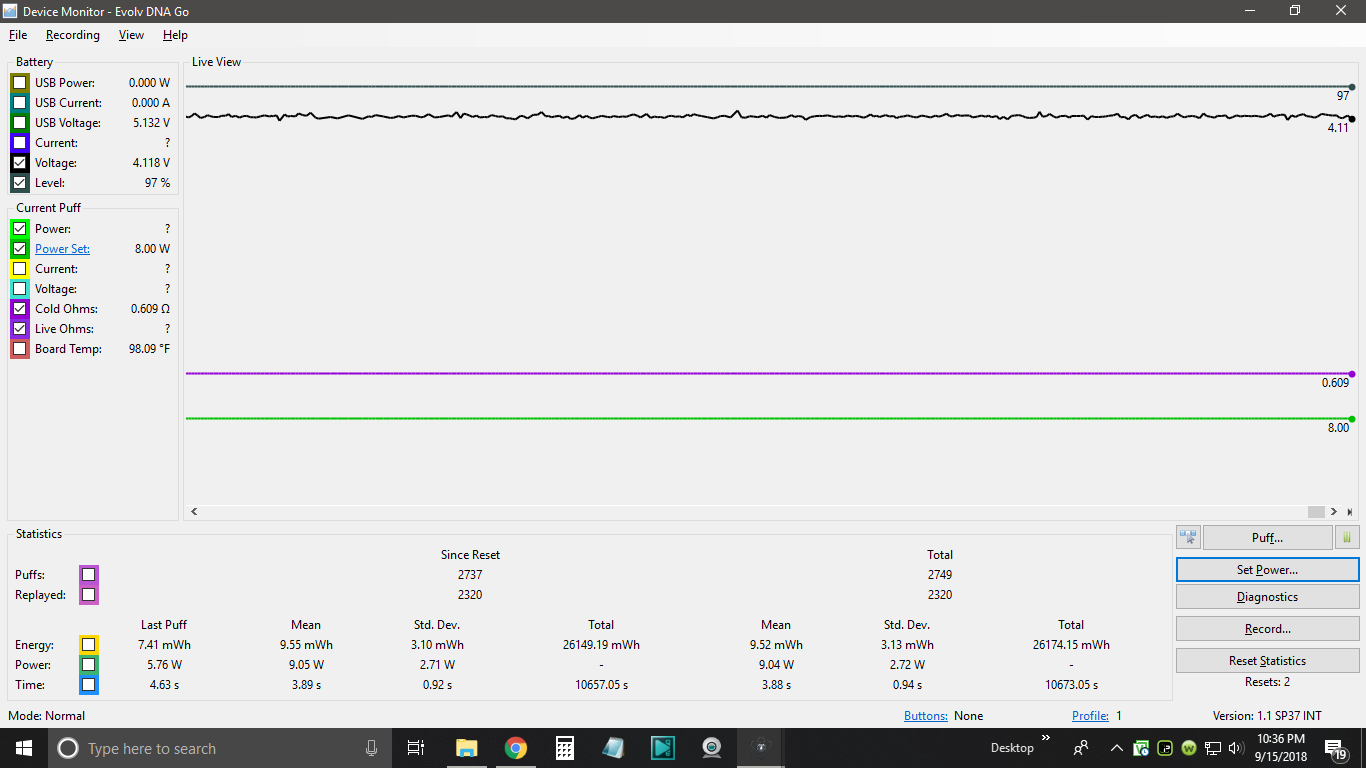

DigitalSmoker Posted September 16, 2018 Report Posted September 16, 2018 (edited) What is going on with this battery? Plug it in to charge and check device manager, battery never stays at 100%. It goes up to 100% then drops to 97% then up to 99% then down to 93% then back to 98%. Is anyone else seeing this as a issue? Here is a pic of device manager, 97%? Edited September 16, 2018 by DigitalSmoker
retird Posted September 16, 2018 Report Posted September 16, 2018 I read this a while back...... " The hysteresis band of the charger chip is 4.1 to 4.2 volts. That is, left to it's own devices, the charger will charge to 4.2, then let the device discharge to 4.1, then charge back to 4.2 in a slow cycle.If it is left to it's own devices. If charging is interrupted for some reason (firing, USB command to stop charging, whatever) and it is above 4.1 volts, it basically says "eh, good enough" and doesn't charge farther. That's half of it. The other half of it is on this chip, the total accuracy of the battery monitoring in he processor is +-2% worst case. Typical is about +-1% 1% of 4.2 volts is .042 volts. So it could actually be charged to 4.2 volts and be reading 4.158.That doesn't hurt anything because unlike the 200 class devices, the charger here is standalone, so the processor's battery voltage monitoring accuracy isn't a safety issue." 1 1

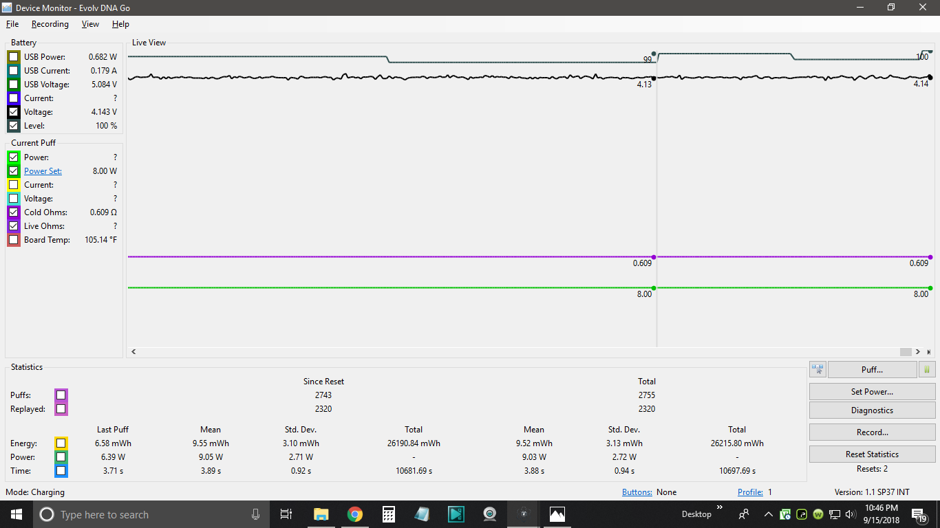

dwcraig1 Posted September 17, 2018 Report Posted September 17, 2018 Check Device Monitor when fully charged, you should expect to see voltage around 4.13 - 4.14 volts area.

DigitalSmoker Posted March 18, 2019 Author Report Posted March 18, 2019 From other posts it's working correctly and is the norm for a DNA GO chip
