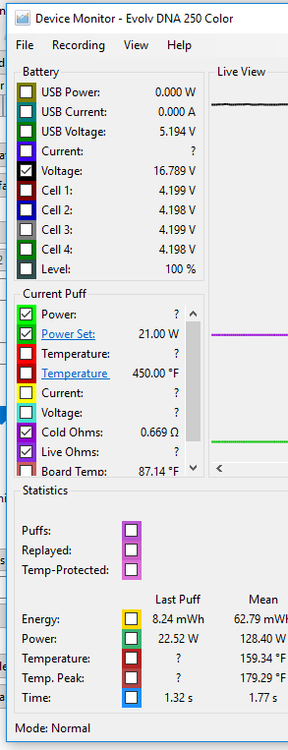

retird Posted August 2, 2018 Report Posted August 2, 2018 hum......, we know that as batteries age they lose capacity. Here is a screenshot showing my 250C Li-Po pack at full charge. It shows 100% charge in Device Monitor and it also shows 100% and "Full Charge" on my device screen with the Theme I use. Run Battery Analyzer or do the quick fix as @Wayneo just posted and see what results you get. FOOTNOTE: From quick Google search...... Charging a battery forces ions from the cathode to the anode; using the batteryreverses the flow. Over time, this process wears out the cathode, which results in reduced capacity. A high-end lithium-polymer battery can lose about 20 percent of its capacity after 1000 charge cycles.

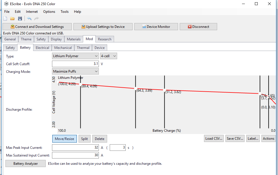

James Posted August 2, 2018 Report Posted August 2, 2018 What are all of your battery cells' voltages? What does your battery curve in EScribe (Mod tab) look like?
retird Posted August 2, 2018 Report Posted August 2, 2018 2 hours ago, James said: What are all of your battery cells' voltages? What does your battery curve in EScribe (Mod tab) look like?

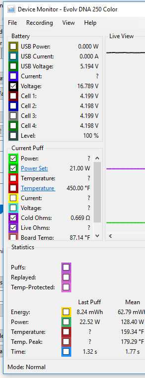

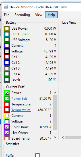

DJT Posted August 4, 2018 Author Report Posted August 4, 2018 Hi, I can't access a 'removable mode' at all. Even though my three batteries I take out and charge in an external charger! Here's two screen shots for you. 99% is the highest it's ever shown and that was since I did the ' turn down the curve to 4.17' trick as explained above. This is a freshly charged set of batteries that are only a month old.
