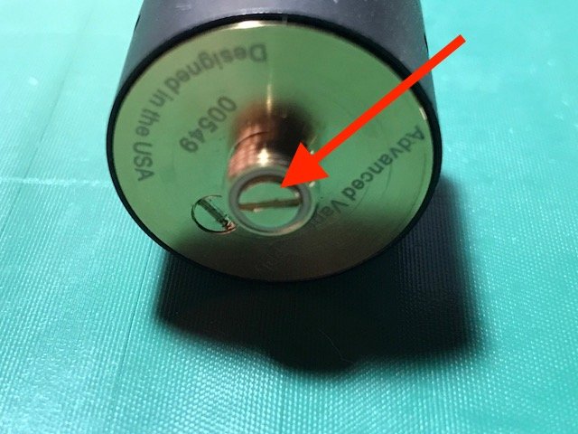

Does it not fire at all? Perhaps the 510 connection is too short. The 520 connector has a slotted screw which may or may not mean its length can be adjusted. So if you are not getting any power to the Boaz, you might contact AVS to see if that 510 screw is adjustable. -
