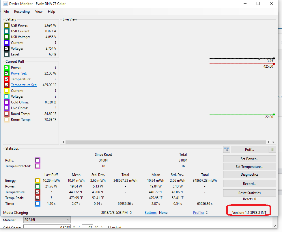

JRH78 Posted May 3, 2018 Report Posted May 3, 2018 20 hours ago, mactavish said: After installing SP15, did you upgrade the mods firmware? In Escribe, you should see an upgrade message, as you need from firmware page: SP33.2! --- DNA 75 Color (firmware 1.1 SP33.2) ---Replay (International Edition only). To use Replay:(1) Apply the Service Pack.(2) Choose a profile to put Replay on. Check "Use Replay on this profile", and name it how you like. (For most people, the easiest way to use Replay is to choose a profile whose material is Watts.)(3) Load on a theme with Replay support. (The default theme has Replay support. Go to the Theme tab and click Default Theme, and upload.) How you find out what firmware I have?
JRH78 Posted May 4, 2018 Report Posted May 4, 2018 57 minutes ago, retird said: Ok, I have the right firmware.
