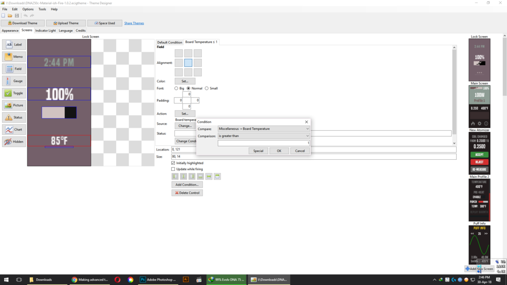

Can you tell me about the condition with "Greater than/Less than/Equal to/Known/Unknown" and the entry that goes with it.

It's a conditional. A little programming knowledge will probably help you. On your screenshot, it's saying if the BOARD TEMPERATURE is GREATER THAN some value (that you enter in the box), then DO SOMETHING.
When you create a condition, it adds a new tab so you can set up a configuration for when that condition is true. In your second screenshot, the tab says "Board temperature <= 1". So whatever changes you make in that tab, will only occur when the board temp is less than or equal to 1 (which probably will never happen, unless it's freezing outside). Maybe you could have it say a warning like "CAUTION: Board temperature is very cold"
One use for the conditionals is with USB. You can create a condition WHEN USB CONNECTED > ADD SOME TEXT TO SCREEN or something like that.
