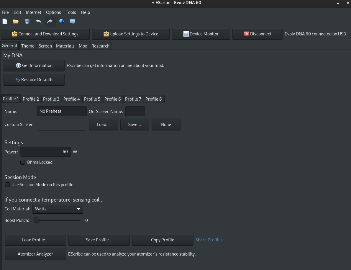

Podunk Steam Posted March 28, 2024 Report Posted March 28, 2024 (edited) On 3/25/2024 at 8:51 PM, James said: I've posted the Linux version of EScribe Suite SP55 with DNA 60 Color and 80 Color support. Let me know if you run into any bugs with it! Thanks! Any suggestions, I mean besides some new 10 amp Sanyos? https://ibb.co/LN8Vt0j Edited March 28, 2024 by Podunk Steam
