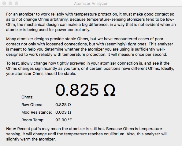

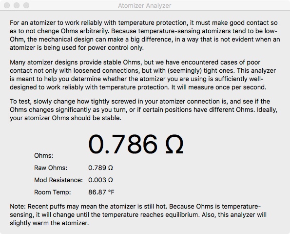

ndb Posted August 3, 2017 Report Posted August 3, 2017 2 hours ago, James said: I've posted beta 10 for Mac. It fixes a number of Mac bugs: Available Materials not saving, ECigStats minimizing to the Dock, some themes not being uploadable, and a few others. Thanks, James. I can confirm now Available Materials are correctly saved. After upgrading the two 75C, Therion and the ERM, with the SP25, I noticed cold ohms seem systematically read again a bit lower (tried atomizer analyzer right before and right after applying the service pack). On the therion I have an SS316L coil that was reading ~0.682 with SP24 and went to 0.662 right after applying SP25. On the ERM another SS316L coil went from 0.859 on SP24 to 0.843. The weird thing is that the vape doesn't seem to be affected too much, as far as the very few puffs I've taken since upgrading. So I think I need some more time to be sure of the vape quality, but I wanted to put this out as soon as possible to check if this could be an expected effect of SP25?
James Posted August 3, 2017 Author Report Posted August 3, 2017 Interesting. Looking into that. @JBood: Give beta 11 a try. 2

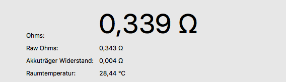

Lowbytes Posted August 3, 2017 Report Posted August 3, 2017 Thank you for making a dream come true ! No more need for parallels B t w i can confirm that with SP25 regulation has changed - to get the same vaping experiences i´ve to manually set Ohms to 0.33 on sp25 on sp24 0,345 so still different to other DNA´s Measured room temperature still way to high (dig Thermometer reads 23,0°C) - looks like still something wrong in my case thermals Regards Mikel
James Posted August 3, 2017 Author Report Posted August 3, 2017 No, room temperature is just not preserved across firmware updates. They revert to the board temperature. Doesn't mean anything is wrong with your thermals. That's on my (very long) to-do list, don't worry. 1
James Posted August 4, 2017 Author Report Posted August 4, 2017 @ndb, @Lowbytes: Give beta 12 a try. Thanks!

Lowbytes Posted August 4, 2017 Report Posted August 4, 2017 Hi James same coil - same room temps - looking promising
ndb Posted August 4, 2017 Report Posted August 4, 2017 7 hours ago, James said: @ndb, @Lowbytes: Give beta 12 a try. Thanks! Wow! I'm currently out and only have with me the ERM 75C with a SS316L, so I can't do too much testing, but I run atomizer analyzer just before and after applying this beta 12's FW and you can see the difference in the attached screenshots. By the way, since it is still called SP25, to be perfectly clear: the "BEFORE" picture refers to the SP25 that came yesterday with mac escribe beta 10, the "AFTER" picture refers to this latest SP25 that came with mac escribe beta 12: The first room temperature ~87F is almost exact, the second one appears higher probably due to the effect of FW update that you mentioned in your previous post (i.e. it resets to board temperature after an upgrade) Needless to say, this even seems too good to be true... ;-). I could even back-off temperature down to 380F maintaining smooth regulation. I can't currently do any further (e.g. cotton burn) testing as I'm out and about, but when I'll get home tomorrow I'll compare these readings with what I can get from my DNA200/75 and report back. BEFORE: (SP25 FW from mac beta 10) AFTER: (SP25 FW from mac beta 12)

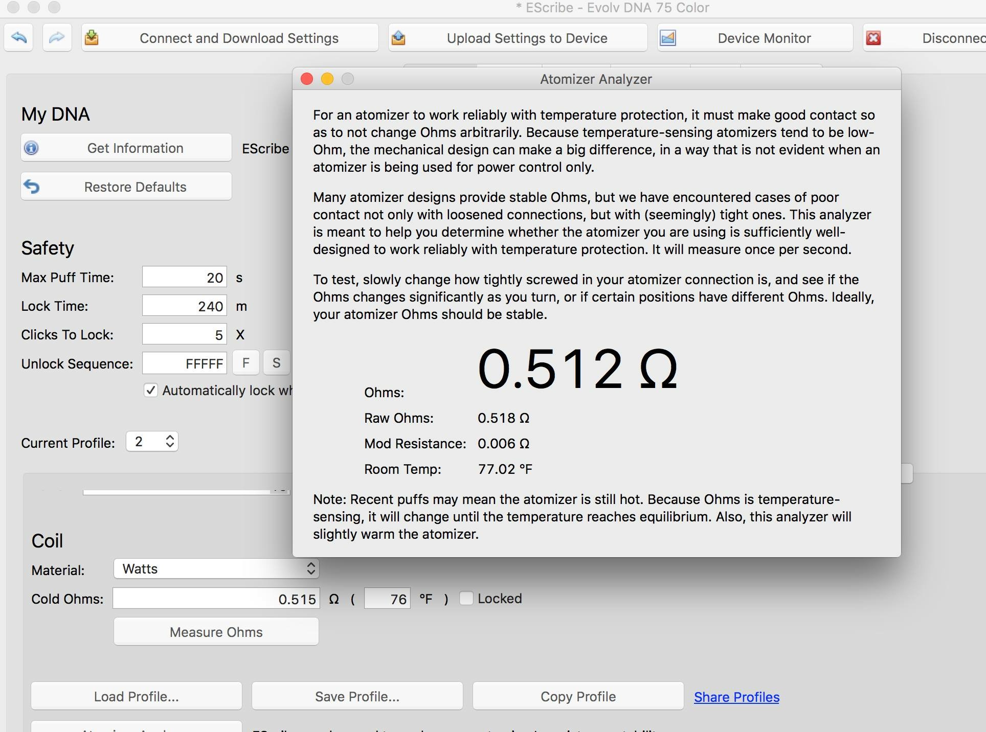

KISS V. Posted August 7, 2017 Report Posted August 7, 2017 @James In the picture below (General/Profile): I had a 0.000 internal mod resistance when I measured. In atomizer analyzer I had input a mod resistance of 0.006 obtained with a shorting slug. (The slug was freshly cleaned with acetone and turns were counted to mimic RDA depth.) I used 130mm of 22awg Kanthal A1 (cleaned) which should be really close to 0.500. In fact I used a reference mod that I know to be pretty accurate and running on a pre-color release of eScribe and measured a 0.454. I don't have the tools or the indepth knowledge to go much deeper than I have, but from my notes through the various releases the errors have not been linear. I can get a bead on any kind of compensation I can use to offset and get a correct reading. I have just had to override to whatever the coil actually is and then vape. Anyways just a heads up.
