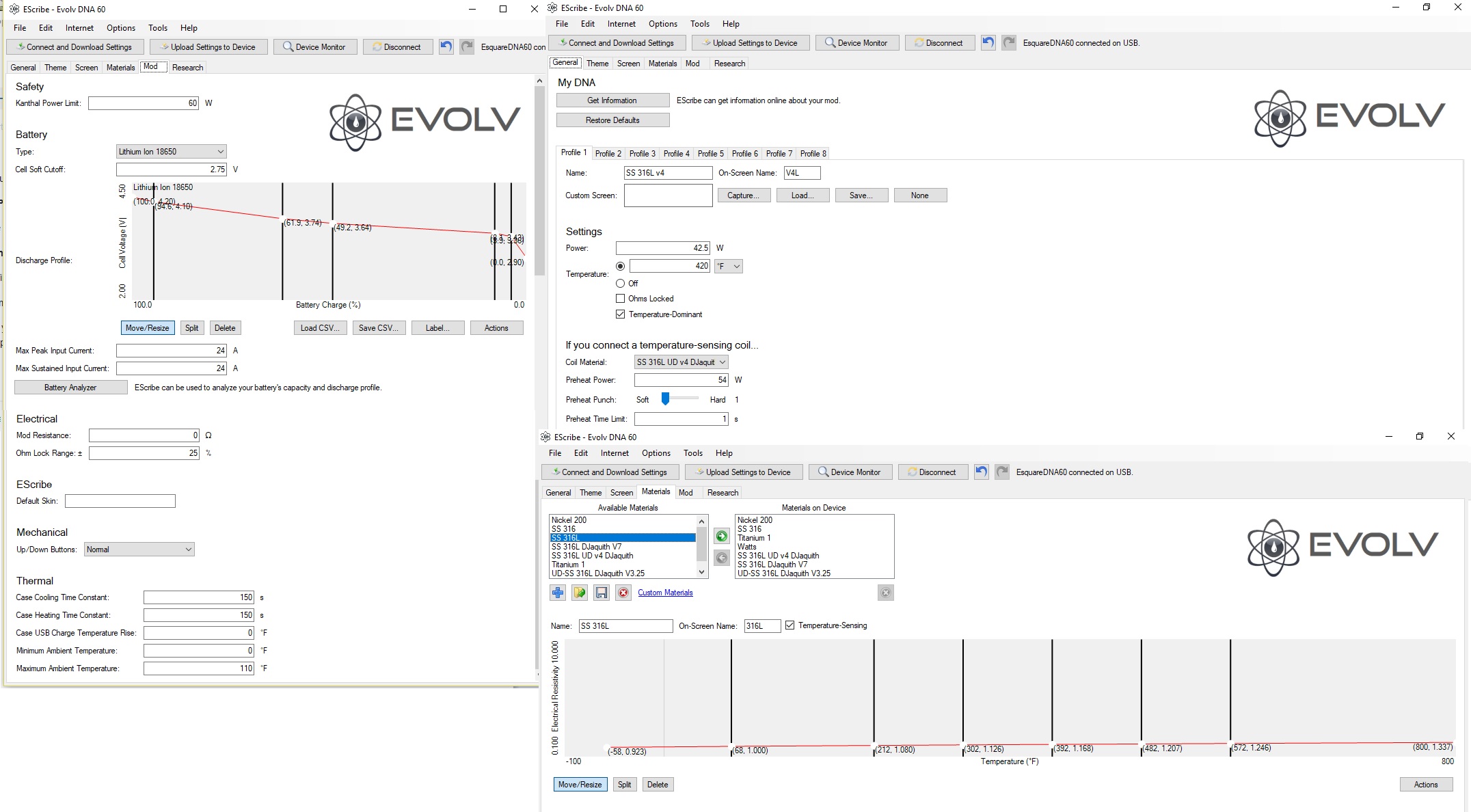

dnk Posted June 9, 2017 Report Posted June 9, 2017 (edited) I got my esquare yesterday and I've been messing with it pretty much ever since. Background: I have an Alien 220 and a goon 24mm i run as my normal set up. Got a merlin mini RTA with the esquare and have been playing with them both. The alien can be finnicky with the TC, but it is pretty good about not giving me a dry hit. Materials: I'm using 24x36 single core clapton SS 316L with single coils in both my Goon and Merlin. In the Goon i tried first it with 5 wrap spaced 3.5mm twisted coil. Now i am running a single coil 6 wrap, 3.5mm spaced coil, ohming around .33-.36. On the Merlin i started with a simple 6 wrap, 3mm contact coil. Now i have a 3mm 6 wrap spaced coil in it. Both times it ohmed around .30-.34. Settings: I ran stock 316 and got whispy airy hits. Uploaded the steam engine 316L profile. Still whispy. Made a profile (we will call 316L2) with the TCR set instead, tried .000895 - .00095 with better results around .00095. 20-30W pre power, 1-.25s preheat, 5-9 punch. 375-475F. 42-60w. The situation: Now, when i first coiled and wicked the Merlin and turned the esquare on, right out of the gate i got a decent hit. Then i got a dry hit. I tried again and got another. Broke it down, the Merlin's wick was wet at the bottom but dry at the top. Simple, too much wick. Rewicked, tried again and that is when the whispy hits started. They were at least DECENT, but my alien definitely does better. Try my goon, same problem. Fiddle with temp and watts, nothing. So i pop open escribe and start reading about it. Create a 316L csv on steam engine, but nothing. Once i tried the 316L2 profile with the set TCR, i cranked up the temp to 475F and it was working better. Essentially it would kick into temp protection at like 25W max, but it went up to about 35W at 475F. Keep in mind i had prepower and power set 52-60W, but it never hit those wattages. Start fresh today. Put the second set of spaced coils into each atty. Same problem. Take off the attys after a weak hit, replace it and it asks if its a new atty (which it only does sometimes on my merlin but always on my goon). New .33 (.35 on the goon) old .31, same on both attys basically. So i take the new, freshly fired coil resistance. Now i get a hit similar to my alien, but i notice now that the TC mode isn't throttling the wattage at all and not hitting TP. On my goon with saturated coils, this is fine. But with the merlin it is giving me CONSTANT dry hits. It is firing like it's in watt mode but it's in TC mode still. I rewicked the merlin again, thinking maybe i messed up wicking again. Use even less wick and cut shorter than i had been. Still the same problem. Dry hit city. It is just awful. I am at a complete loss as to what i am doing wrong. If i wanted a VW mod that had janky TC, i woulda just gotten another alien. And there is NO WAY my alien should be doing better than my DNA60 with the exact same settings in each. But, sure enough, it is. I took the dry hitting merlin straight off the DNA and put it on my alien, and i can hit it for like 5s with no dry hit. TC hits just fine on the alien. Any help you guys could offer would be greatly appreciated. If you need more info, let me know! Cheers and happy vaping! Edit: Just tried to dry hit my goon and i got it to where it would dry hit, but i didnt push it over the edge to see. I've had too many today and its making me fill icky. But i noticed the temp doesnt even get near the limit of 400F. it barely breaks 300F. It over throttles watts when its cold resistance and then doesnt throttle watts at all warm resistance. Something isn't right. Edited June 9, 2017 by dnk adding and tags
Wayneo Posted June 9, 2017 Report Posted June 9, 2017 Before we start .......... MOD tab -> Options (menu bar) -> User Interface -> Manufacture Can you post a complete Printscreen of that mod tab ensuring you have scrolled to the bottom of the screen. Printscreen of the Profile you're using And finally a complete Printscreen from 'Device Monitor' with Power, power set, cold ohms, live ohms, and the 2 temperature options, while firing. Trash whatever 'material' files were on the mod, and download your own from steam-engine (like I believe you did). Couple things about DNA mods You should not lock your resistance unless you have a janky build or connection Your coils before vaping should be at the ambient temperature

dnk Posted June 10, 2017 Author Report Posted June 10, 2017 So, I was asking around on reddit and someone suggested i try the DJaq 316L profiles (V4 V7 and V3.25). Updated my escribe to the 1.2 SP5 version, somehow i was using the 1.2.0 version. It still had the same Dec 22, 2016 SP3 for the DNA60, but i reapplied the service pack from the updated escribe anyways. It seems like everything has gotten better since i switched the preheat power and the power and started using the DJaq profiles. For some reason i was thinking the higher value went in the power and lower in the preheat. doesn't make much sense now that i think about it though. It SEEMS that the problem was the stock 316 profile, the 316L profile i made on steam engine and the preset TCR .00095 profile i tried. I don't understand really why the DJaq profiles work better, but they do. dnkEsquare.ecig V4DJaq316L.csv 1
dnk Posted June 10, 2017 Author Report Posted June 10, 2017 I just did these and i got a dry hit off my Merlin. The V4 csv's were on my goon. I'm gonna rewick it and see if that changes anything. I'm gonna pop it on my alien and try it out too to make sure it isnt the atty. But as i look back, it wasnt throttling the watts on my goon at all. merlinV3.25DJ.csv merlinV4DJ.csv V4DJaq316L(uppwatt).csv

retird Posted June 10, 2017 Report Posted June 10, 2017 Thanks for posting your *.ecig file for your esquare.... I compared your thermals with the latest Lost Vape downloadable *.ecig file (downloaded from their web site just now) . Lost vape shows 0.003 (default from Evolv) as the mod resistance and yours shows 0. Also I noted both files are using the default Evolv Thermal numbers thus is seems that Lost Vape did not run Case Analyzer on the esquare. You might run Case Analyzer and I think your temp's accuracy should be better. 1
dnk Posted June 10, 2017 Author Report Posted June 10, 2017 (edited) On 6/10/2017 at 8:36 AM, retird said: You might run Case Analyzer and I think your temp's accuracy should be better. Expand It seems i don't have Case Analyzer as an option on the mod tab. I have it on Manufacturer and it looks the same as a screenshot i saw, but the button is missing. using escribe 1.2 SP5 Should i just set the mod res to .003? Edit: set it to .0011 and it actually works noticeably better. Will update tomorrow once ive used it more. goonV3.25MR0011.csvFetching info... Edited June 10, 2017 by dnk update

Wayneo Posted June 10, 2017 Report Posted June 10, 2017 On 6/10/2017 at 4:56 AM, dnk said: It SEEMS that the problem was the stock 316 profile, the 316L profile i made on steam engine and the preset TCR .00095 profile i tried. I don't understand really why the DJaq profiles work better, but they do. Expand Because LV's is just plain wrong and why I suggested this .... without naming names. On 6/9/2017 at 2:52 PM, Wayneo said: Trash whatever 'material' files were on the mod, and download your own from steam-engine (like I believe you did). Expand From your excellent Printscreen's move your preheat punch value to 11, and work slowly backwards to the ramp up you prefer. And finally a complete Printscreen from 'Device Monitor' with Power, power set, cold ohms, live ohms, and the 2 temperature options, while firing. Finally follow @retird info to set your mod resistance
