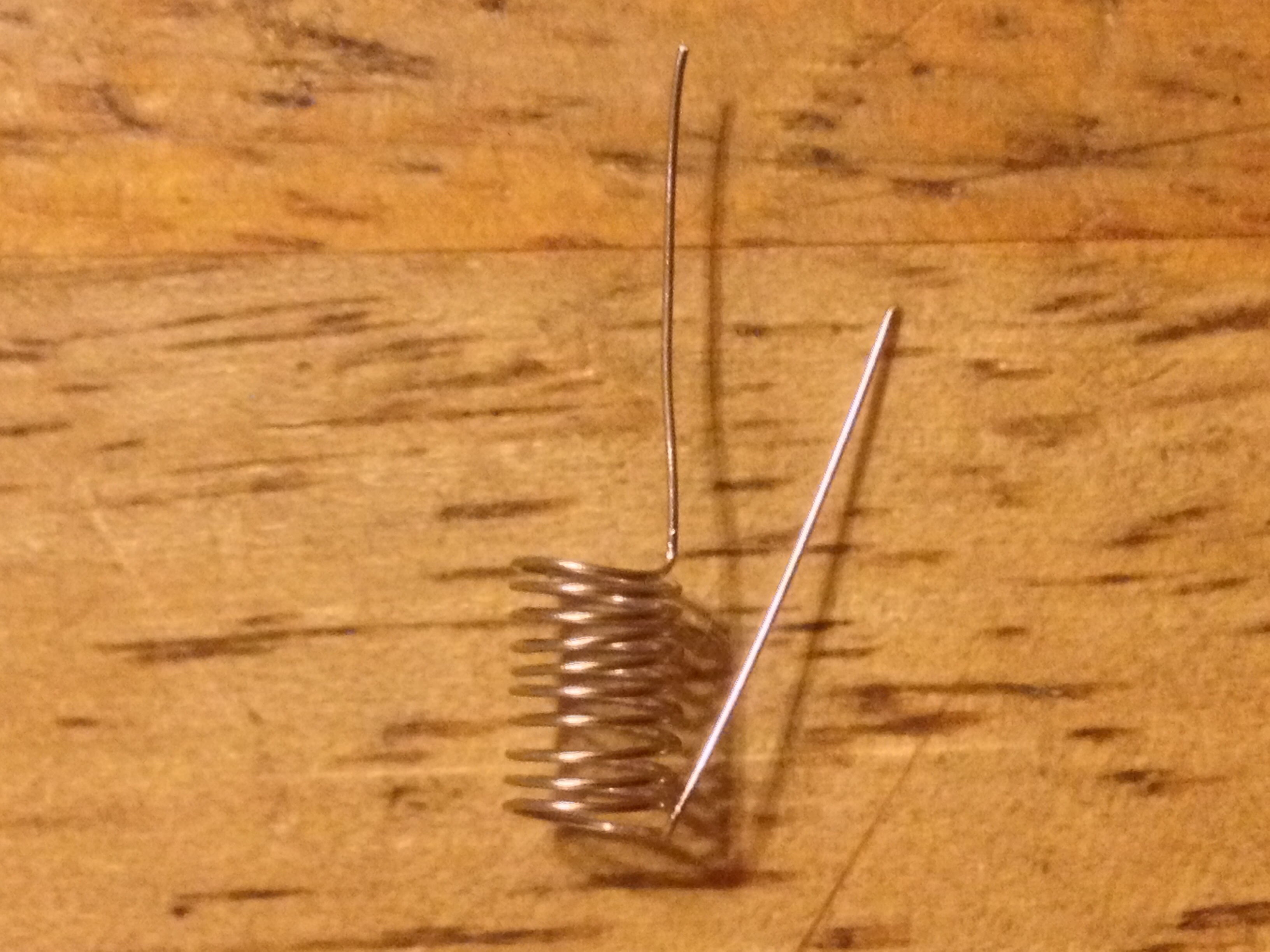

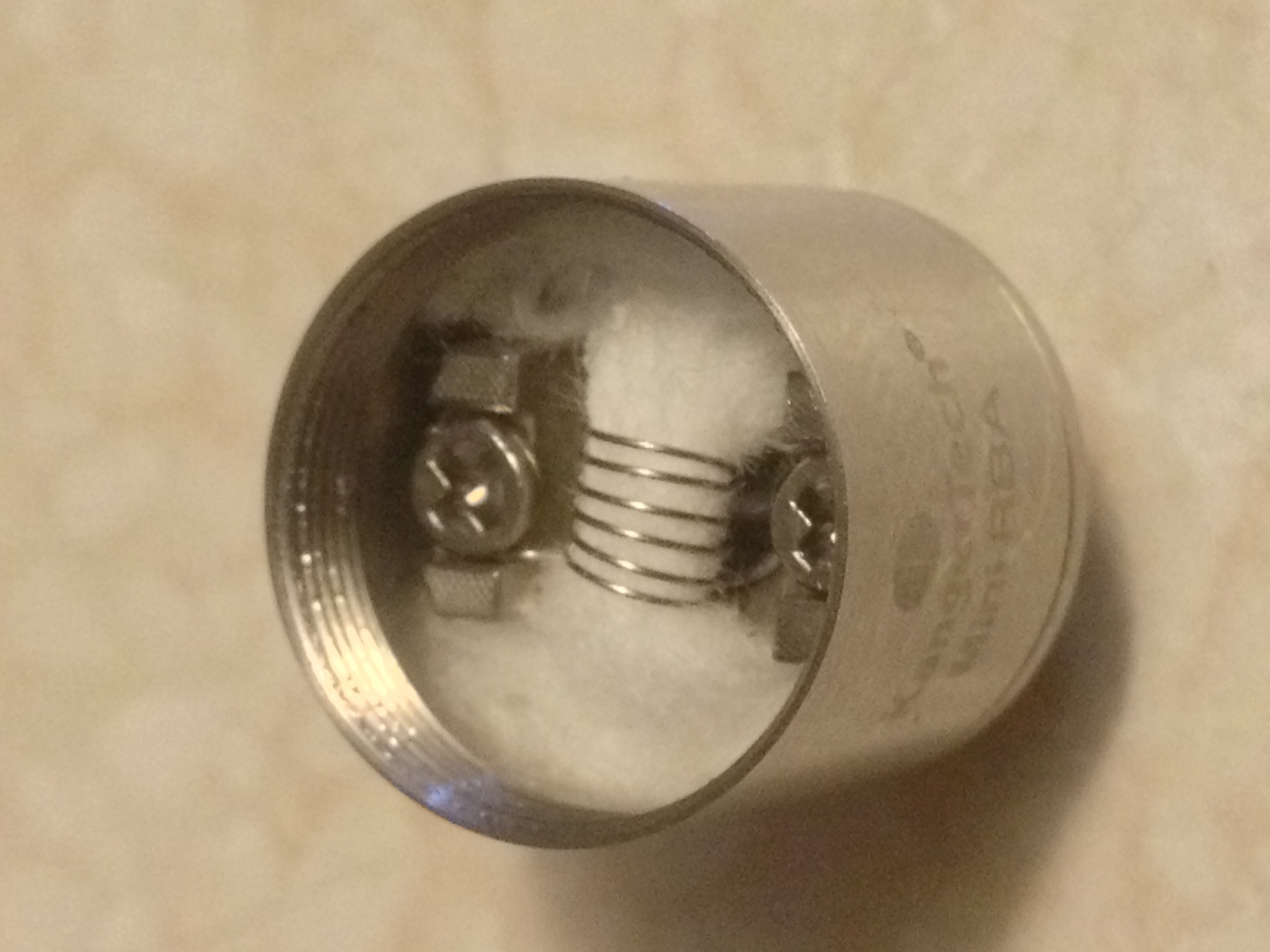

Guest Posted August 7, 2015 Report Posted August 7, 2015 Here's my single coil build 32 gage .2ohm and a vertical coil 30 gage .2ohm for my nonrebuildable kanger coil head
