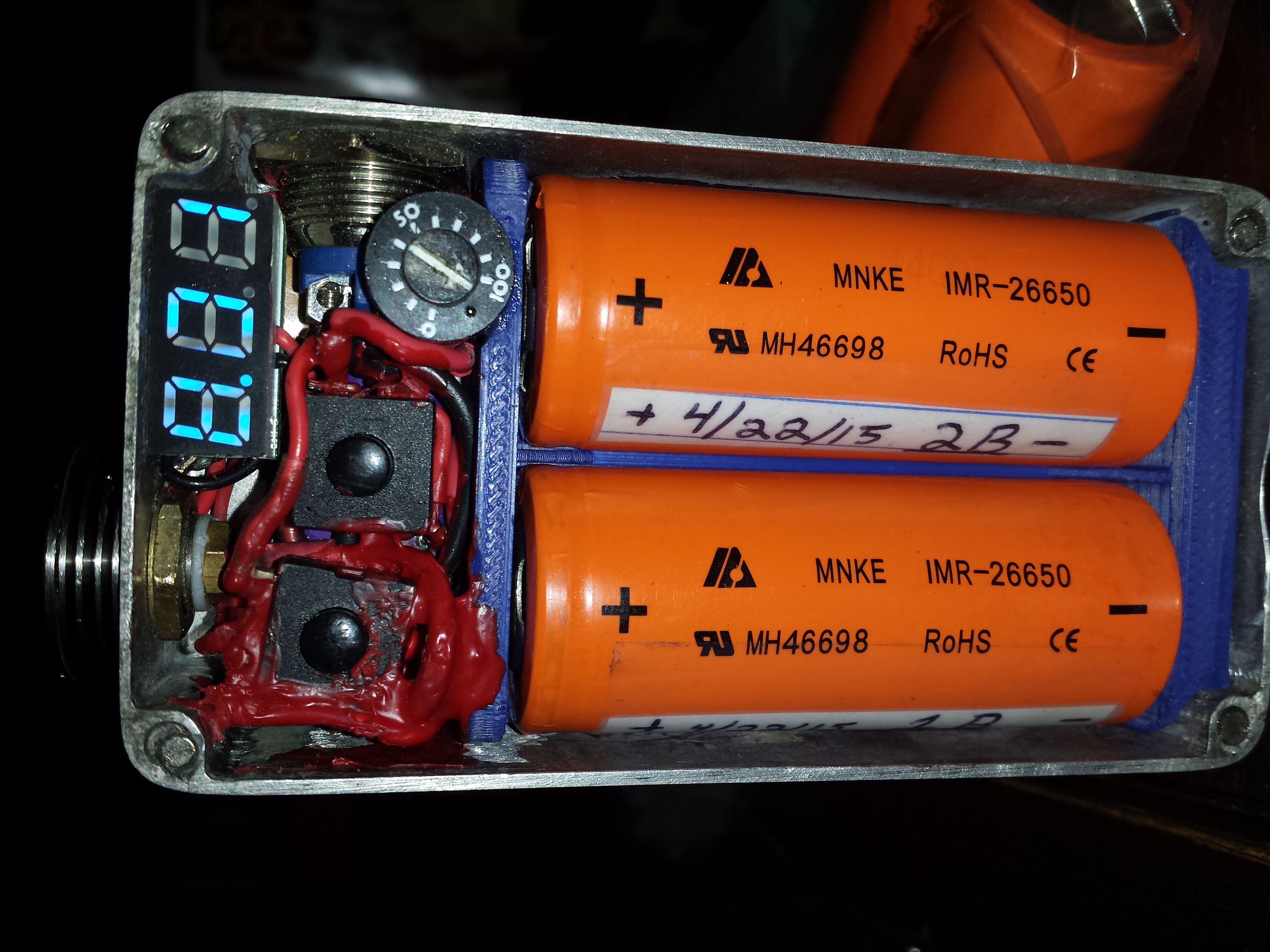

Hi. Trying to find an all day battery for my needs. Right now I use a 120w raptor with 2 mnke 26650 3500 mah (thanks for the plans on ecig mamu) that last me all day running about 75 to 80 watts. Have a pic of it below (yea I know it's ugly) What i found confusing was reading in another thread here that mah isn't as critical for run time with the new chip. what battery spec would give me a similar experience? If anyone has a recommendation or could point me in the right direction it would be appreciated Thank you

2 3500 mAh batteries are 25.2 watt hours.
For a similar run time, you'd want a 2200 mAh 3s pack. That is 24.42 watt hours, which should give you equivalent results.
Or sit tight for a couple hours and we'll have a 2s compatible firmware up for testing here, then just use your same 2 26650 batteries in series.

So with the 2s firmware how would you charge or monitor the cells? I don't charge inbox anyways as I swap and charge batteries on rc lipo charger.  I would love to have the option to use a 2s battery even if it limits the power to a lower amount.  I wouldn't want to use anything but a lipo still though.
Posted
You connect the cell 3 tap and the cell 2 tap wires together, set the settings, and otherwise it runs just like normal. It limits to 133 watts, 6 volts max, but still does cell by cell monitoring and still does a balance charge.
