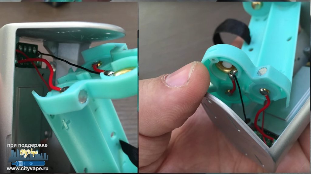

Out of interest and as I'm waiting on one of these, if the battery connection wires don't conform to the Evolv specs, as they don't by the looks of that image, what redress does a customer have with the vendor/manufacturer if any.

I know there's a lot of scaremongering on the web, but even without actual measurements just looking at the pics (there even seems to be an anomaly between the + & - ) it's plain to see that the battery wires are much thinner than they should be, especially compared to the output ones, this leads you to believe they don't meet the specs. Can someone take the measurements please to confirm this.

[QUOTE=Jaquith]The wire 'looks' like 18 gauge silicone encased, the small wires are for cell monitoring and 1A charging to the Balancer. Voltage drop for such short lengths is negligible

[QUOTE=Jaquith]The wire 'looks' like 18 gauge silicone encased, the small wires are for cell monitoring and 1A charging to the Balancer. Voltage drop for such short lengths is negligible <0.03V / lead. The most important 2 wires in the Mod, any, are the two output. Read the specs again and read the info printed on the wire. LOL you can use 20 gauge silicone wire for the battery.
If you look carefully the b- wire is not the same as the b+.. They're using the same wire for b- as they are for balancing..[/QUOTE]
I thought that they had disconnected the main -ve wire, but as you say the pics on photobucket show some skinnier wire for the -ve while the battery tray is being removed.
I'm not sure you can tell by looking at the pics that the wires are silicon!
All the wires are important for the efficient and safe operation of the device.
As Gm11 states and I mentioned earlier there is an anomaly between the + & - wire gauge.
it is obvious from the pics that something is amiss.

I think they connected B- at another spot, the small diameter black wire seems to be for just balance.
Gee, if they are 18 gauge already, well I ordered some 18 gauge silicone wire this morning.

Silicone wires with flexible cores are more flexible and typically with more sheen than PVC counterparts. Wismec has a team of Engineers and they can read. I'm confident the Reuleaux is built to spec. Evolv has published their specs since day one. I'm confident they read them. If the Reuleaux is bad with bad wiring then prove it. My box wiring is overkill http://i.imgur.com/waQ0wmnh.jpg

[QUOTE=dwcraig1]It just doesn't look like 16 gauge to me.
[image]
where are the balance leads? whats soldered on the four balance taps.[/QUOTE] Wow .. then either pull yours apart or look at all of the images posted. Now while I'd prefer to see 3 black and 1 red, maybe they chose the colors as they did to reduce production errors. Count them .. 4 .. see http://smg.photobucket.com/user/djs61/media/The%20Reuleaux/Wismec%20Reuleaux%2015.jpg.html
Posted
It only needs 2 balance wires, 4 is better but if they take 0 & 3 from the battery pads, need better photos, but you would expect to see a thin wire from each battery pad to the nearest balance pad and the 2 centre balance pads connected to the battery cradle.  I suspect that is what they have done plus taking the negative from the cradle to one of the screw points and common grounding to the chassis, but it is all conjecture from the photos.
draw me up a diagram kid. im pickin up what yer layin down, but  a diagram would make my night. thanks.

can you figure out where the balance leads are?
Wow look for the little wires (2) red + (2) black = 4. Two from the top and 2 on the bottom .. all 4 balance are there and accounted for.
Yes on a 3S you need ALL 4 wires; positive and at the end of each negative:

[QUOTE=VapingBad]It only needs 2 balance wires, 4 is better but if they take 0 & 3 from the battery pads, need better photos, but you would expect to see a thin wire from each battery pad to the nearest balance pad and the 2 centre balance pads connected to the battery cradle.  I suspect that is what they have done plus taking the negative from the cradle to one of the screw points and common grounding to the chassis, but it is all conjecture from the photos.
draw me up a diagram kid. im pickin up what yer layin down, but  a diagram would make my night. thanks.[/QUOTE]
Not very good, just lashed up in M$paint
This is not a recommendation, but it could be how the Reueaux is wired, just saying don't shot the messenger.

[QUOTE=ChunkyButt200]can you figure out where the balance leads are?
[Identical ecig file and identical dual Ti/Kanthal Atty] Next 18650's sag (voltage drop) more that LiPo's. Here's a 2S DNA 200 (133W) with fully charged batteries (2) vs Reuleaux with 3S and nearly depleted (~10%) vs a 2000 mAh LiPo 60% vs 900 mAh LiPo fully charged:
[/QUOTE]theres two red and one black, dunno where yer seein the fourth wire. but @vapingbad drew up a sweet diagram to help me understand. thanks @vapingbad.
