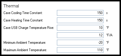

Thinking out loud:  Might run Mod Analyzer and check the Thermal settings shown in EScribe.  If the board was not configured by Lavabox (sent out with default settings) then the temps may be off.  Just a guess.

Those are the default setting of the Evolv board as sent to the device makers.  The enclosures are different depending on the design and material etc. and the Mod analyzer is used to properly tune the settings for the board to the device so the most accurate temp can be delivered.  At least that is what I understand.
I'm thinking this may play a part in what you are seeing.  James can correct me if I'm off base and miss-informed.
