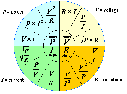

Since Power = Resistance x current^2 the most you will be able to get out of 50 amps output with a .05 ohm load is 125 watts (you said low ohm Claptons, to me .05 is low ohm). Do you think a 2 x 18650 is going to be outputting more than 50 amps? Some of these companies coming out with 2 x 18650 mods claiming 200 watts and above have no shame when it comes to marketing or over promising and under delivering. When you think about it, most credible companies cap there single 18650 mods at 75 watts. With double the power source available the output capability doubles not triples or more.
If these mods could actually produce what they claim it would be with a very limited resistance range for a puff or 2 then the bottom falls out from there. These boards aren't magic, they don't create power, they step up or down voltage and do the inverse with the current minus the boards inefficiency (no board is 100% efficient, but the DNA200 is one the most efficient, if not the most I know of).

It depends. Wattage isn't really a physical quantity. Voltage and current are. There is a minimum and maximum voltage the board can supply (.5-9V). There is also a maximum current the board can supply (50A continuous). The wattage max is really just the maximum you can set the device to. Remember, the board doesn't apply wattage to the coil, it applies voltage. Given the resistance, you can determine the current needed to apply that voltage using V=IR.
So if you had a .1ohm load, the board couldn't apply its maximum voltage (9V) because it would draw 90A. So it is limited to 5V, which requires 50A. W = VI, so this is 250W. The board can't do that (see what James said, it actually can go over 200W to some extent). This limitation is just part of the firmware, not hardware. So there is no physical reason the board can't apply 250W in this case (it actually might if your mod has a high resistance).
If you had a 1ohm load, the maximum voltage you can apply is 9V. This draws 9A. This is only 81W. This is due to the voltage limitation.
If you had a .01ohm load, the maximum voltage you can apply is .5V. This draws 50A. This is only 25W. This is due to the current limitation.
So, I probably said too much but in the first case a higher amp fuse isn't required to increase up to 250W (after that yes). In the second case, the fuse is nowhere near maxed out but more than 81W requires the board to be able to apply a higher voltage than it can. In the third case, getting more than 25W would require more current, thus a higher fuse. So sometimes a higher amp fuse isn't needed to increase wattage, sometimes it is, and sometimes it wouldn't make any difference.
Btw, we are assuming increasing the maximum current the board handles means the fuse needs to increase.
