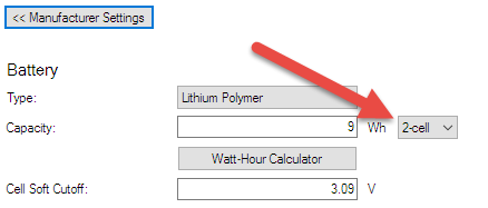

Ampule Posted May 6, 2016 Report Posted May 6, 2016 Hi just caught up with this thread. I had exactly the same issue, turns out I had changed the battery cell number in Escribe during some battery testing and forgot to change is back to the 2 cell setting. Instant fix
