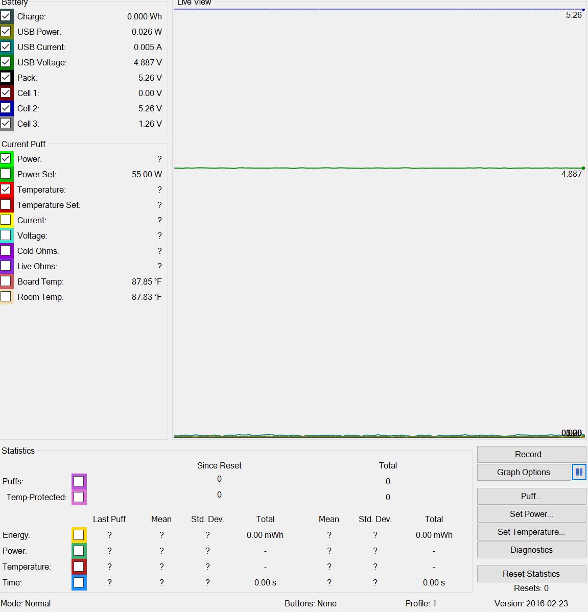

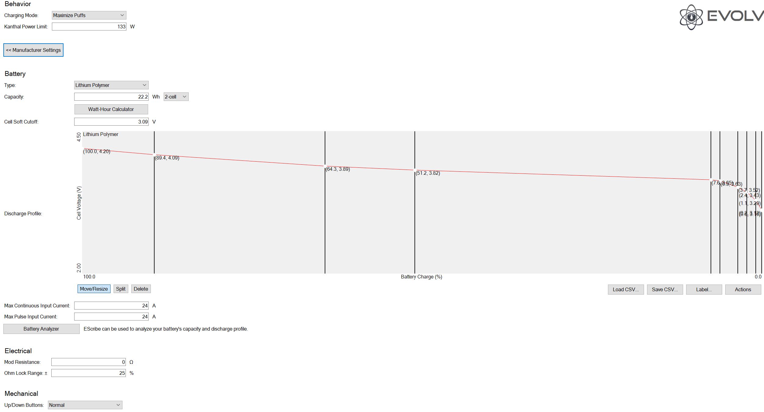

Attached are pics of escribe.
Thanks in advance for any help and suggestions.
Oh that shows cell#1 as 0v, cell#2 as 5.26v, cell#3 as 1.26v. Something seems wrong on the balance connections. Pin 1 should go to the positive of cell 1 and pin 2 should go to the positive of cell 2 (plus pin 3 and B+ should go there too). The VT133 might be wired non-standard because of the reverse protection.
Your watt hours is set on 22.2Wh. That sounds way high. I would think it should be around 14 to 18 range. This only controls the battery meter accuracy and not part of the problem.

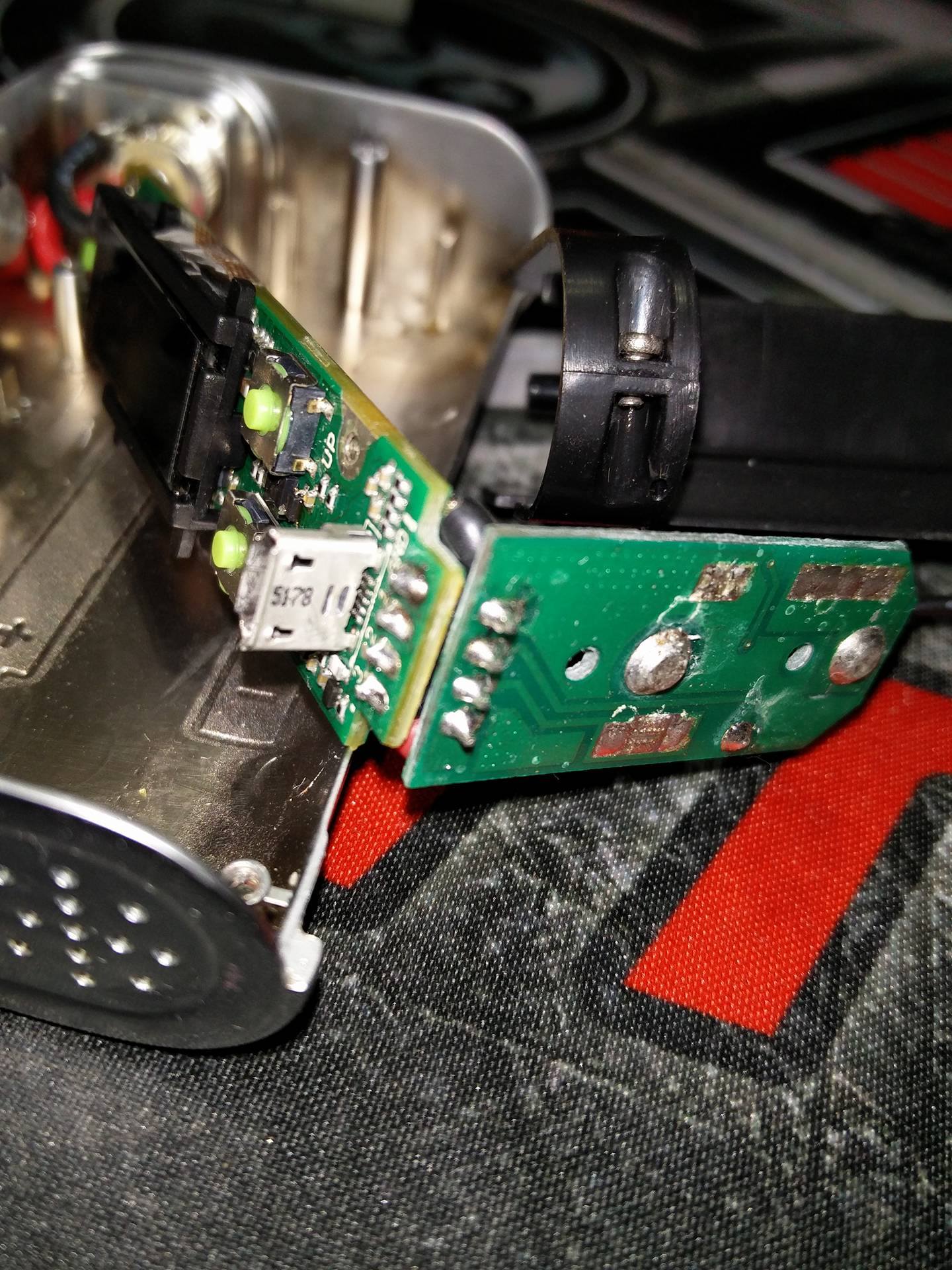

Yes, I can see it is labeled as GND, 1, 2, 3. Pin 1 should go to the positive of cell 1 and 2 plus 3 should go to the positive of cell 2. You can ohm it to see if it does. Something looks funny from here on the reverse protection traces. Could be nothing, hard to tell.

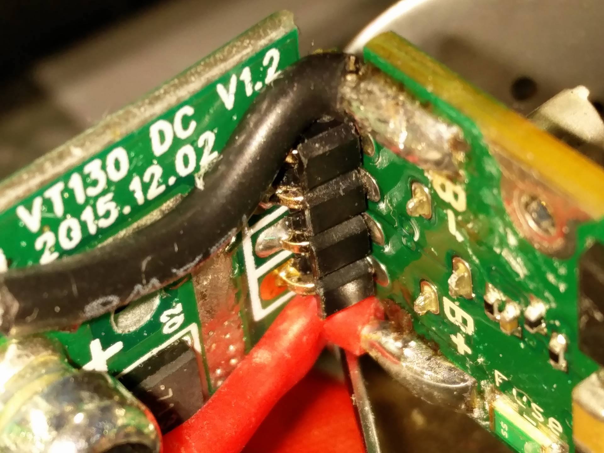

VapingBad said:
This looks like a dry solder joint to me and fits the symptoms.

Vaping Bad - Just opened it up and looked fine. i verfied with multimeter from the reverse protection board to the chip and its a clear path.
