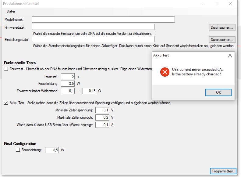

rsrider Posted July 8, 2016 Author Report Posted July 8, 2016 yes 2 cells and when i make the batterie test it failes. I Set the A to 1 and nothing happens
Spector NS5 RD Posted July 8, 2016 Report Posted July 8, 2016 rsrider said:yes 2 cells and when i make the batterie test it failes. I Set the A to 1 and nothing happens i have never seen this screen before when using escribe, lol. where is this particular "functional tests" page? is this somethiñg you made?
rsrider Posted July 8, 2016 Author Report Posted July 8, 2016 this page is under tools -> production utility
Spector NS5 RD Posted July 8, 2016 Report Posted July 8, 2016 rsrider said:this page is under tools -> production utilitynever noticed it. go into device monitor and try what i said. set your usb current to 1 amp. what is your battery's watt hour? total. anyone else feel free to chime in with any ideas.

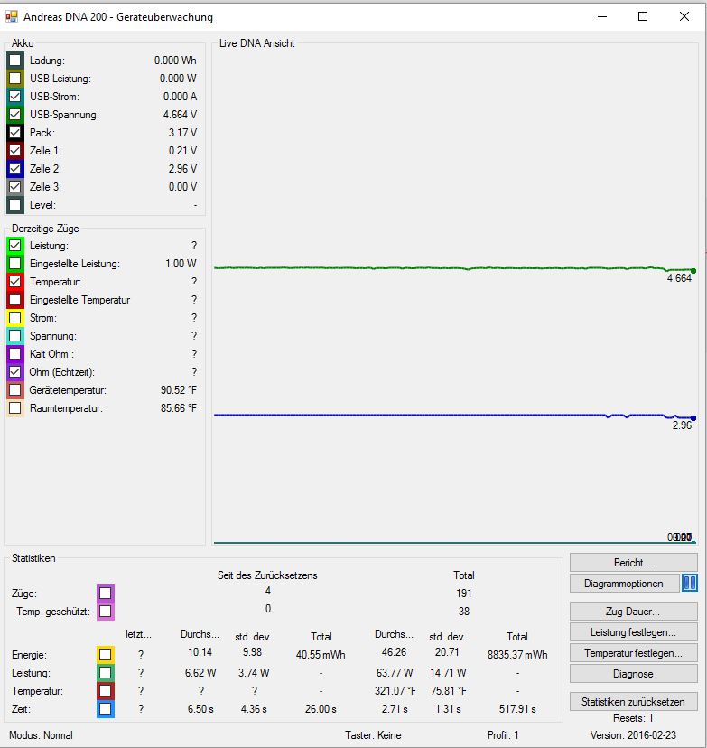

rsrider Posted July 8, 2016 Author Report Posted July 8, 2016 i did the amp limit to 1A but nothing happend.my batteries are 2x 18650 Sony Vtc5 2600mah each Set to 17,77 Whmy wiring is like that https://s3-us-west-2.amazonaws.com/cdn-nonameboxmods-com/dna-200-dual-18650-wiring.pdf
Spector NS5 RD Posted July 8, 2016 Report Posted July 8, 2016 as long as you're positive your wiring looks like this, then it's correct.did the mod ever charge? try a few other usb cables. you could also double check what you input for your watt hours, make sure you typed it in correctly. try a soft and a hard reboot.

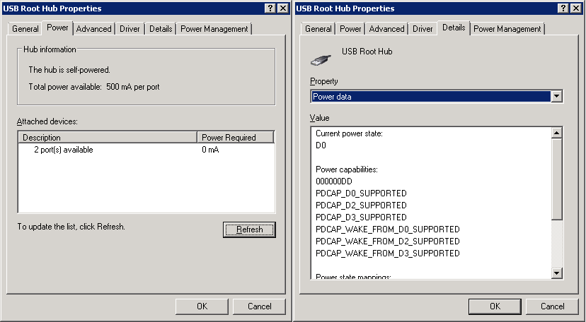

VapingBad Posted July 9, 2016 Report Posted July 9, 2016 It will probably not ever reach 1 A off a PC most of them restrict the current to 500 mA and your battery should be below 4 V. I see yours were < 4 V and current was 0 so it not those. I tend to turn this test off on the Production until as I only occasional make a mod to sell and always test it vaping for a while. Does it charge normally from a USB supply?
dwcraig1 Posted July 9, 2016 Report Posted July 9, 2016 Just to add to the above ^^^When the mod sees a data path the max amperage is 500 ma.

VapingBad Posted July 9, 2016 Report Posted July 9, 2016 BillW50 said:I don't think most computers restrict ports to 500ma. At least the many that I have seen don't. Like this machine has four USB2 ports. And I have seen over 900ma being drawn over one port. I think most machines are like this one and supplies 2A (500ma times the USB ports) total.But when you connect up a DNA, it always charges at 500ma. While my USB TV tuners, USB DVD drives, etc. will draw 900ma or more from these same individual port. My two XTAR VC4 battery chargers act very similar to the DNAs (like most devices that charge through the USB). Although my VC4s will only draw about 150ma max from the USB from this machine. Yet connect them up to XTAR's own USB power adapter and it draws 2A max.Up to Win 7 (IIRC) you could set the max USB current in control panel applet, now the setting is gone and it seems limited to 500 mA with most drivers. There have been a couple of people that posted they got the full amp, but that is rare.I think you need better USB cables Bill, unless it is in the finall stage of charging I get >490 mA from the laptop and >995 mA from USB supplies & my 2 powerbanks, but I weeded out the cables with high loss ages ago.
dwcraig1 Posted July 9, 2016 Report Posted July 9, 2016 My laptop has 3 usb ports, one is integrated with an eSATA port. With a power only cable I got .5 amp with one, .8 amp with the other and 1 amp from the one that's integrated.With a data cable it's .5 max on all three.Oh, I checked the cable using a 1 amp wall wart and it can due 1 amp OK.
BillW50 Posted July 9, 2016 Report Posted July 9, 2016 VapingBad said:Up to Win 7 (IIRC) you could set the max USB current in control panel applet, now the setting is gone and it seems limited to 500 mA with most drivers. There have been a couple of people that posted they got the full amp, but that is rare.I think you need better USB cables Bill, unless it is in the finall stage of charging I get >490 mA from the laptop and >995 mA from USB supplies & my 2 powerbanks, but I weeded out the cables with high loss ages ago.That is very strange about saying there is/was a Control Panel applet that controls the limit of USB ports. I have been using Windows since '93 and many other OS before that and I must have more than two dozen Windows machines here. And only Vista and Windows 10 I haven't ran. But the rest from Windows 3.1 and up I have. And I don't ever recall that applet. I am not saying it wasn't there, I just never ran across it. Sounds like it is one of those manufacture dependent drivers to me.As for better USB cables... those were using the very same USB cables. I can get 2A from them without a problem. I do have one data power cable that came with one of my cell phones that I never saw anything higher than 120ma going through it. I have been meaning to check those wires for resistance because they must be quite high. The data side works quite well though.
VapingBad Posted July 9, 2016 Report Posted July 9, 2016 By applet, I mean a tab on the device properties, I know it's the wrong word, this is from a Vista machine for v cheap mb's USB hubs (via mstsc), but IIRC some driver hw combinations did allow setting max current and have seen others posting the same. Later versions of windows do not have the power tab at all and the only instances I have of these are in hyper V so would not be real world hw related.
