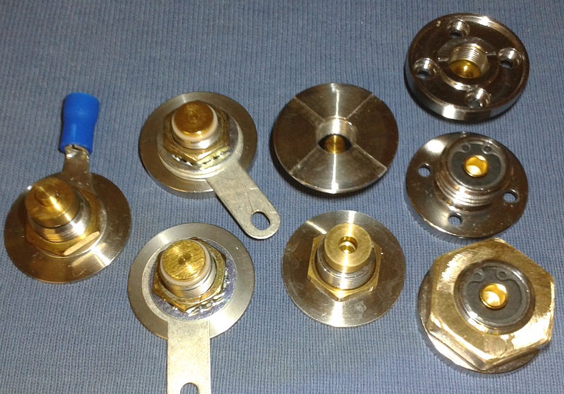

VapingBad said:
No they are different the Evolv connector is half inch 20 pitch (1/2" UNF in the UK) and IIRC the FDV is 10 mm 1 mm pitch (not 100% sure of the thread pitch of the FDV).
Correct me if I'm wrong but sounds like the mounting hole is about the same or slightly larger for the evolve. The evolve has the option of fastening it with the 4 screws. I'm thinking if I used a fdv for now to get up and running I shouldn't have to worry about a sloppy fit if I upgraded to the evolv. I would just have to bore it out a little possibly and then drill and tap the 4 mounting holes?
Yes, the Evolv is larger and you can enlarge the hole and tap to the correct thread, the 4 holes in the top are really for a pin wrench although you could use them to bolt it down
The Evolv 510 is on the rhs
Is the evolv as deep or deeper then the standard fdv models. I have a new ceramic fdv and it's really shallow. My tugboat v2 doesn't sit flush on it and that's a pet peeve of mine. If it's not at least as deep as the standard fdv v4 or whatever the last version before the new ceramic ones was then I'd probably not even bother upgrading it.
The Evolv is a lot shallower than the standard FDV or VT connector, the top is about 3 mm and the part the goes into the mod less than 8 mm.
Evolv 510
The thread is 1/2"-20 threads (1/2" National Fine Thread) and requires a 29/64 hole if you tap it, or a 1/2" hole,  Pin wrench 1 5/8", 4.2 1/6" mm 0.16" pins 2.36 mm inner
Evolv 510
