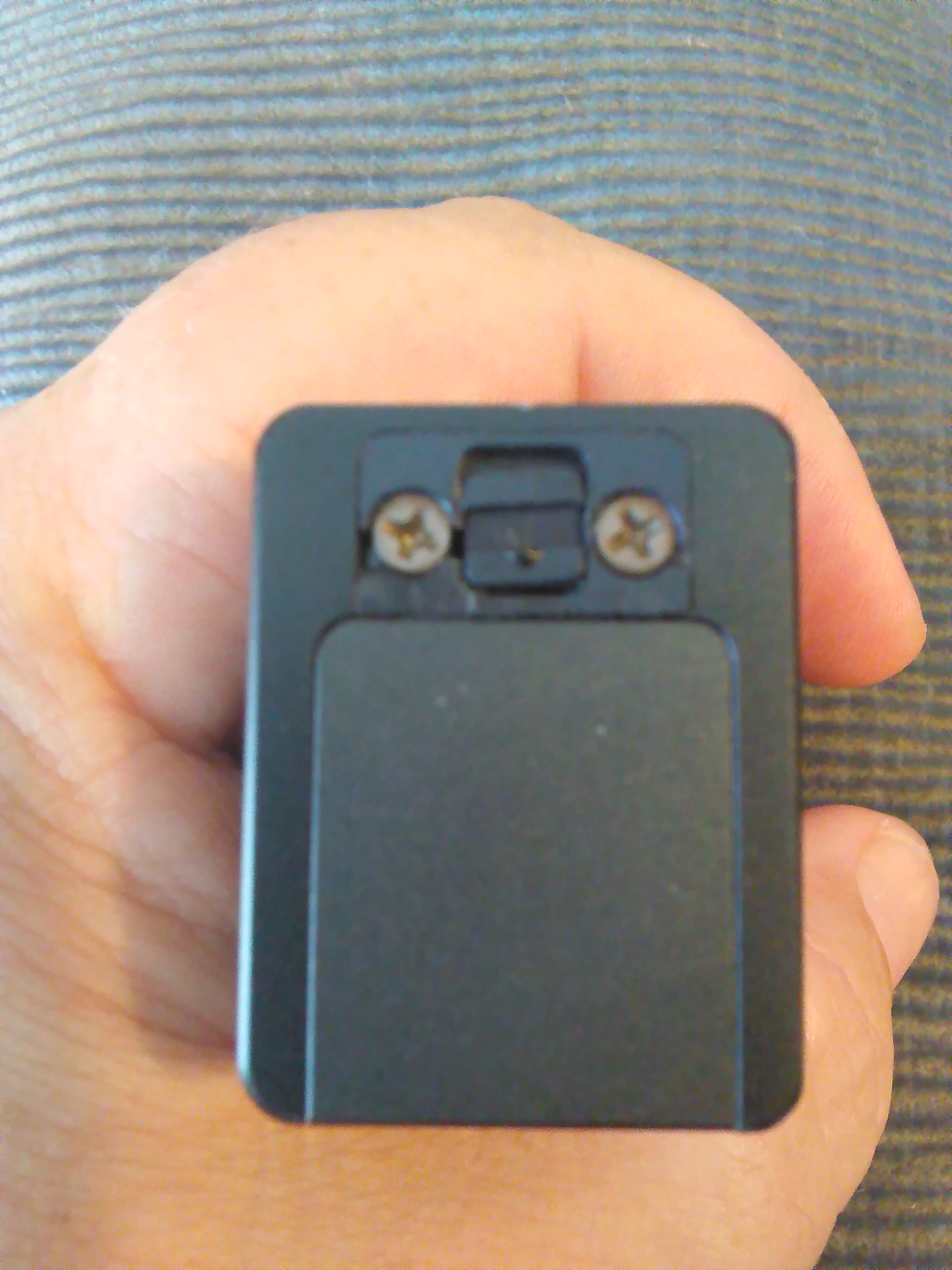

Rob_H Posted July 23, 2016 Report Posted July 23, 2016 nystyletaco said:No updates on their FB page for quite awhile, no response from their service e-mail address.I have one of their DNA 200 models and the screen has pretty much stopped working (usually black, sometime glitches a bit and shows some info before turning off again). I'm suspecting its the screen cable getting pinched but I don't trust my (de)soldering skills to try and fix this damn thing. The mod still works fine, just no screen.Am I SOL here unless I buy a soldering kit and get to work?I just dealt with them on a issue on a Dna40. Latch on the battery door cracked and they shipped one out right away. From the first email to when I had a tracking number was 3 days I think and the part will be here tomorrow.In the subject line of a email be direct about the problem and they should read it and get back with you. I have noticed if I ever ask about stock on devices or anything general they do not answer. If I say its a broken part they are pretty prompt in reply.
Tattoo75 Posted August 1, 2016 Report Posted August 1, 2016 Been trying to get ahold of um for 3 months many Facebook messages, emails with no response. My v4 DNA 40 battery latch broke the first week I had it .lol
Rob_H Posted August 2, 2016 Report Posted August 2, 2016 Tattoo75 said:Been trying to get ahold of um for 3 months many Facebook messages, emails with no response. My v4 DNA 40 battery latch broke the first week I had it .lol I emailed them here hanamodz1@gmail.com in the subject line of the email I put "V4 broken part" explained to them what was wrong and included a picture so they could see what was wrong.If you try that and cannot get a answer from them. I have two extra of those parts, if yours broke where mine did I would send you one of mine. You can install the part pretty easily as it has screws that hold the whole latch together. I think maybe they are just not answering on Facebook anymore.edit: I have three of those parts here they sent me. That part of the latch is plastic and if you over tighten the screws they split.

Tattoo75 Posted August 3, 2016 Report Posted August 3, 2016 I rigged mine since I didn't get a response and needed to use it. I solder the ground wire to the brass and super glued the door closed and just charge tho the usb . I know method is jankey but it worked.
