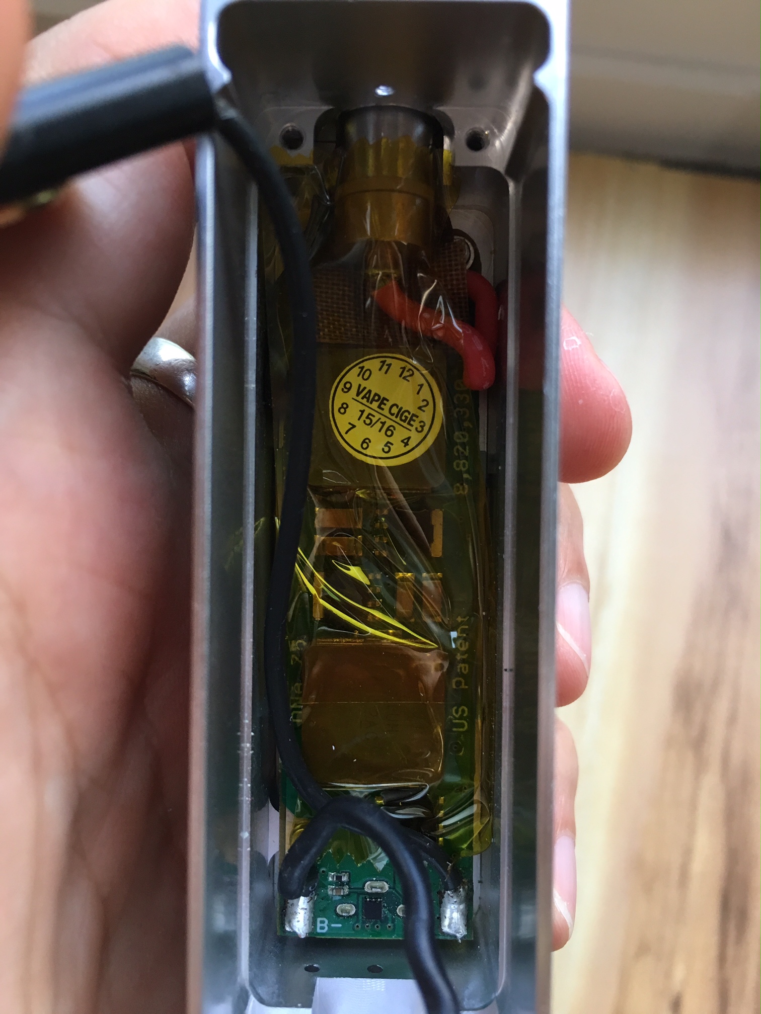

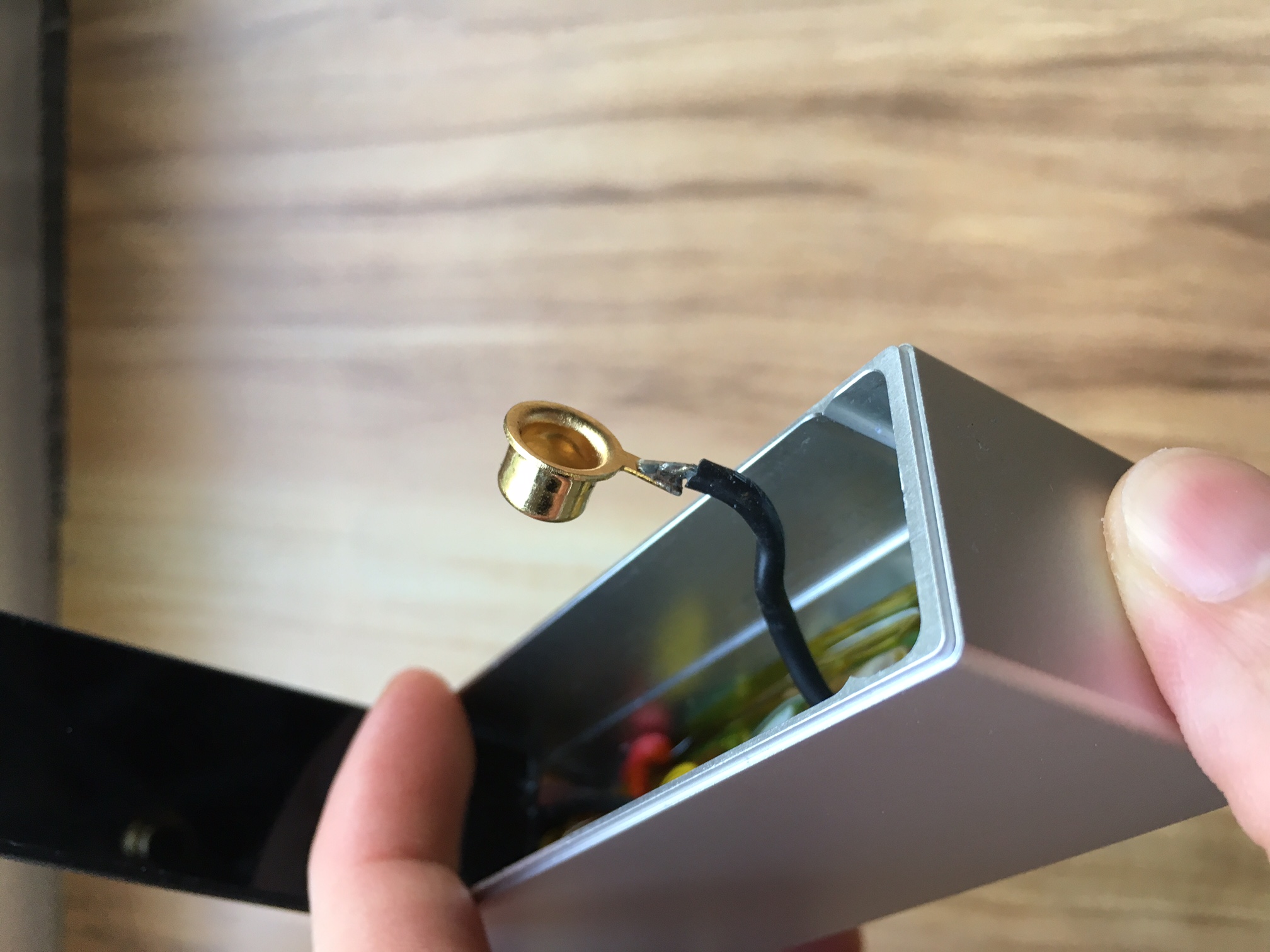

something is wrong with the mod/chip. i've now tested it with different attys and it's consistently reading the ohms at least .02 low (the one time it read the ohms as higher seemed to be a fluke). once i go into escribe and adjust to make the resistance .02 ohms higher then everything works much better.
i took apart the mod to look at the connections. let me know what you guys think. it's kind hard to see the 510 connection cause of the tape.

so i reset the mod back to factory defaults and i'm still having the same issue. i have a resistance reading of .56 and its hitting temp protect immediately and a cold vape at 23 watts. if i override ohms to .58 then it vapes way better and isn't aggressively hitting temp protect. could this be a bad 510 connection?
Link to comment
Share on other sites
could be a dirty 510. try cleaning her out with some iso alc. however, usually when a 510 is making a poor/weak connection to your atty the ohms will be higher, not lower. maybe there is a tiny piece of something metallic inside of the 510 slightly shorting it. you also have to make sure you're using the correct csv material curve/TCR for the wire you're using. keep in mind not all wire is created equal. there are varying grades of all TC wires. make sure you know what you have. i find i have to tweak the SS 316L  TCR of .00092 to .00096-.00098 to get the vape i like. using .00092 at 600°F doesn't quite do it for me so i bump the TCR up a smidge.
