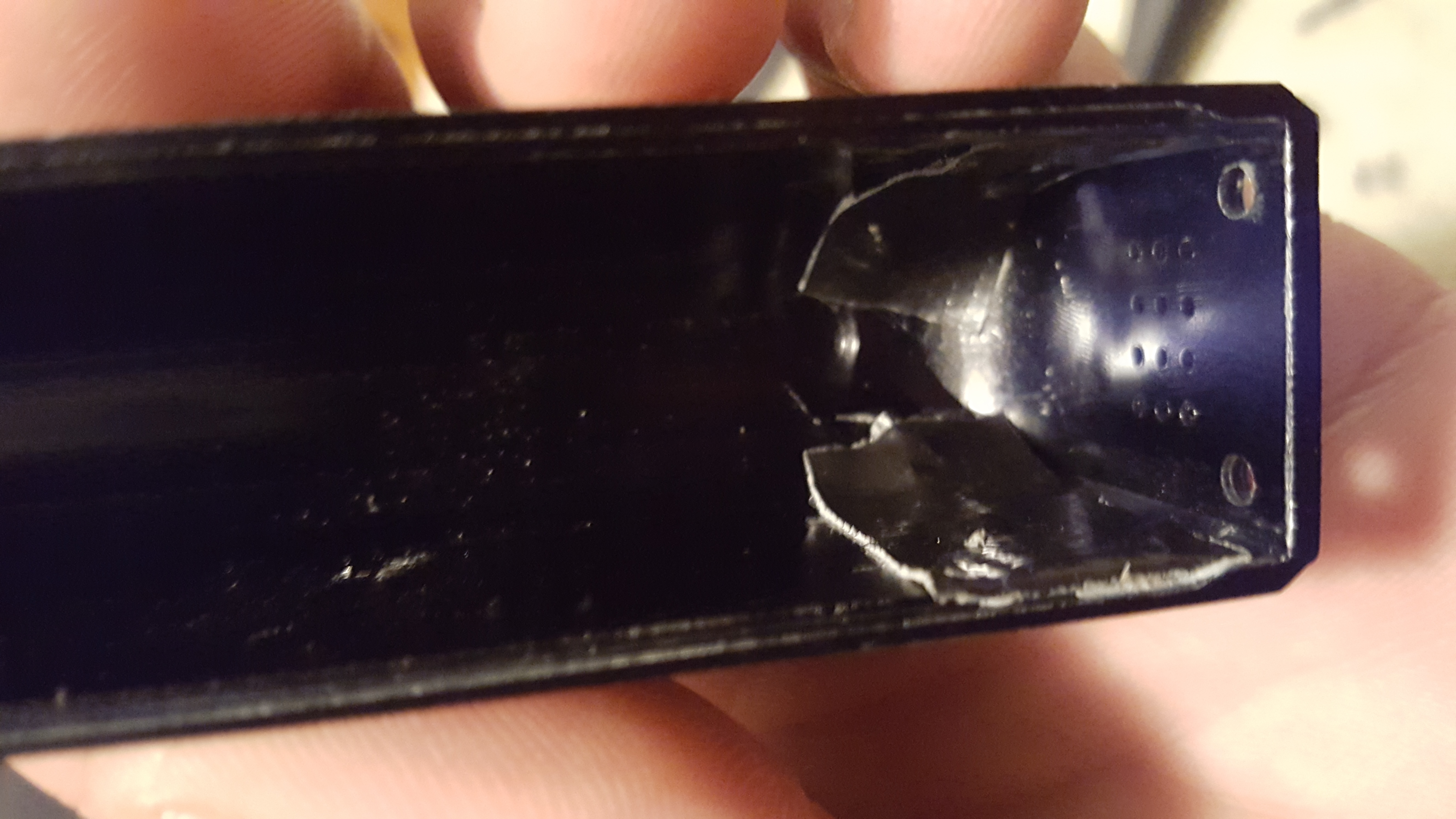

Nope. Didn't think I'd be doing a write up on this. Background. I bought the Hcigar Thinking it was a above average battery, above average form factor and i was sold on the DNA200 after using a Vaporflask DNA40. DNA200 Day one, I threw a dripper on it and it blew the flask away at 40%+ battery. When it dropped into the 30% range something changed. I charged it over night and I was back to total bliss. I noticed when it got into the 30% battery range it got weak. I learned to start charging in the 40% range. I checked online, correct battery setting for 1300mah battery should be set to 14.43 and confirmed in my escribe. Suspicions of Hcigar using 1000mah battery is found on the web and it makes sense. I got a wild hair and measured the VT200 battery and compartment. Battery size is .780x1.158x2.565. Compartment size is .825(21mm)x1.44x2.7 estimated. Searched and found Turnigy was a popular brand and the 25c nano tech 1300mah was the closest fit. Unfortunately when received it didn't fit. At 22mm thick this was going to require some tinkering. Out came the Dremel and soldering iron. Once I made the swap i was surprised to find I was the first to put a 1300mah battery in a Hcigar VT200 and even more surprised to find 20mm thick 1300mah battery from a better brand was easily available. ;) Post swap notes. I was vaping between 450f to 530f with the stock battery and between 3pm to 5pm it was time to recharge to keep above 40% on the battery meter. Now I'm vaping between 400f and 430f and blowing thicker clouds, going through more juice and haven't needed to recharge until bedtime. Last night I vaped down to 3% on the battery meter and it was still hitting strong. Tonight I'm giving up at 7%. I'm looking forward to doing the escribe battery analyzer with this battery.

That's a good one but I was actually thinking of the Thunder Power mentioned earlier in this thread. Thunder Power RC LiPo 3S 11.1V 1350mAh ProLite+Pwr 25C http://www3.omnimodels.com/cgi-bin/woi0001p?&I=THPA1140&P=SM But I'm no Lipo guru. If I was I wouldn't have bought a battery that didn't fit to start with. ;) Last night I did the Escribe Battery Analyzer with the Tunigy 1300mah nanotech 25-50, same as sy5tem has pictured above. Results ended up a disappointing 13.892. Perhaps it was because I smashed the battery in a vise 3 or 4 times trying to get it to fit :) or Perhaps it was my redneck test setup. I used one strand of 24 gauge kenthal 8 3/4" long for 1.5 Ohm on a Dark Horse RDA set to 40 watts with a simple 12" house fan blowing on it to keep things cool. If anyone can make a logical suggestion on a better setup without buying resistors and large heat sink, I welcome it. Two days ago I vaped this battery down to 3% trying to get a weak battery warning (3.11 volts) and it still hit fine at 430 degrees, 0.08 Ohm Ni200 build, at 50 watts and battery capacity set to 14.43. That's what makes me suspicious it was not an accurate test. I've seen the Hcigar battery test 11.07, 10.93 and 10.77 in this thread: https://forum.evolvapor.com/topic/65611-topic/ And the Turnigy test at 14.83 in this thread. https://forum.evolvapor.com/topic/65816-topic/?do=findComment&comment=890993 I would like to see mine test better. I may try varying the Ohms load and see if that changes the end result. Maybe she just isn't a good test taker... :)

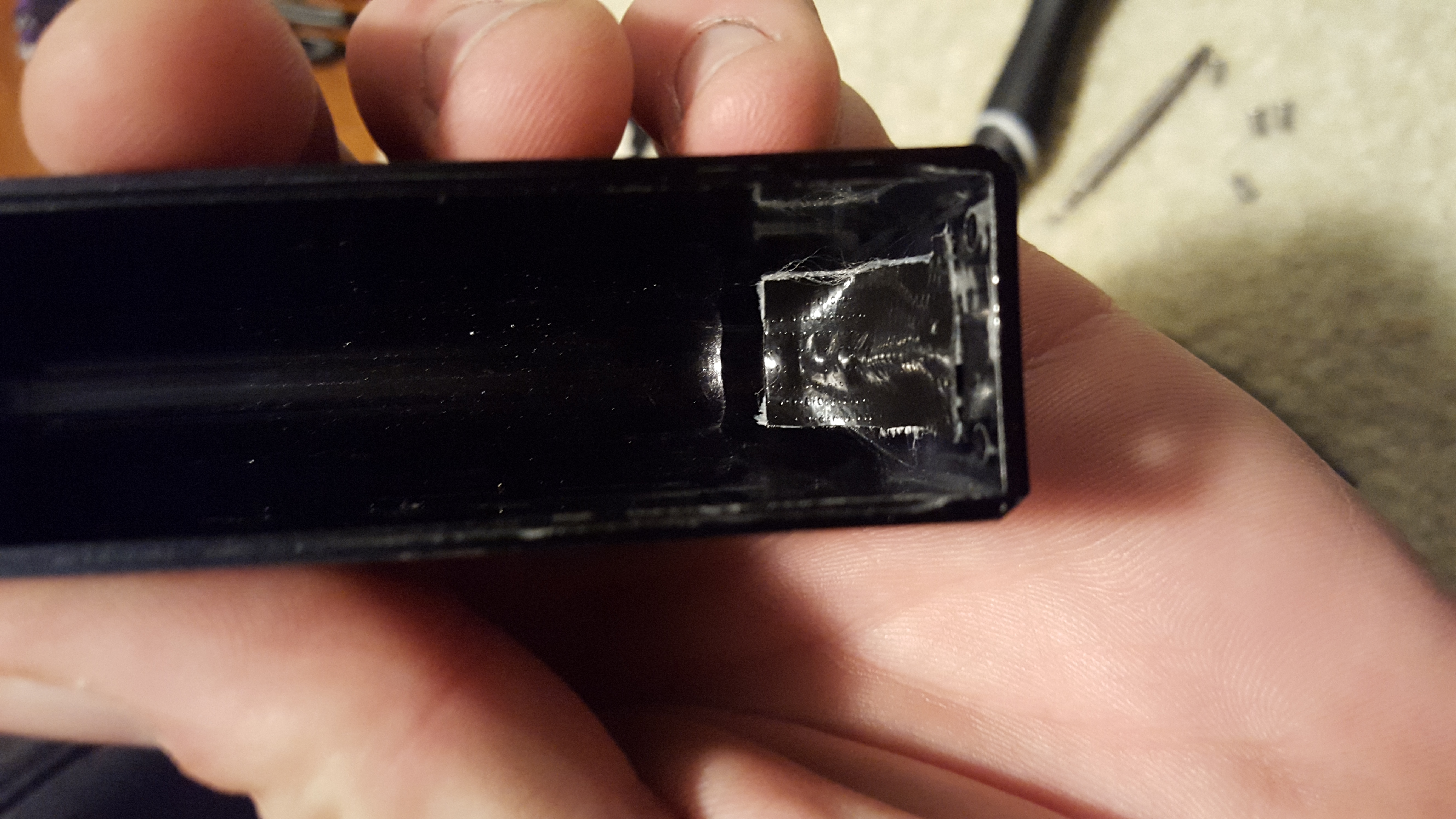

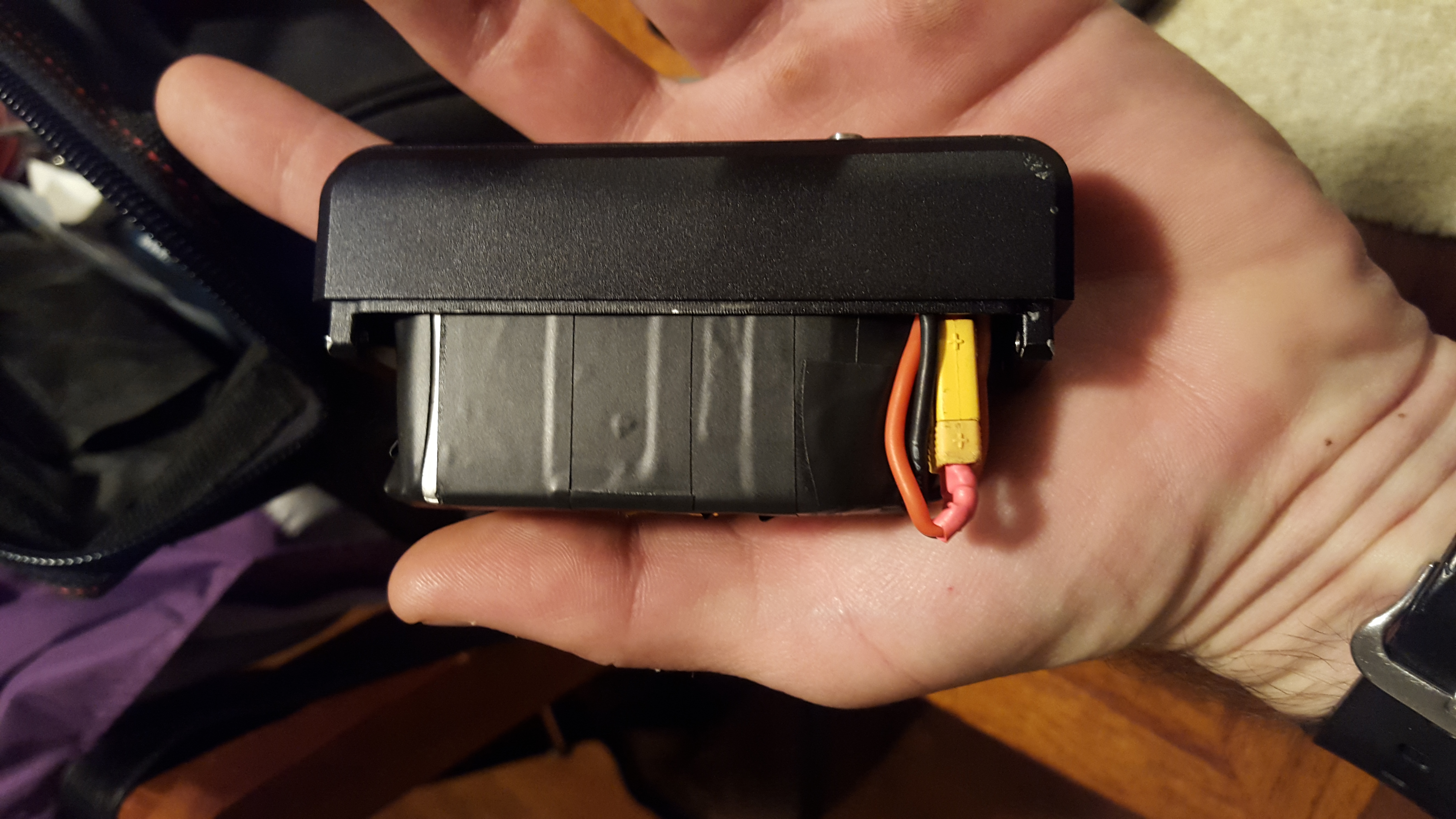

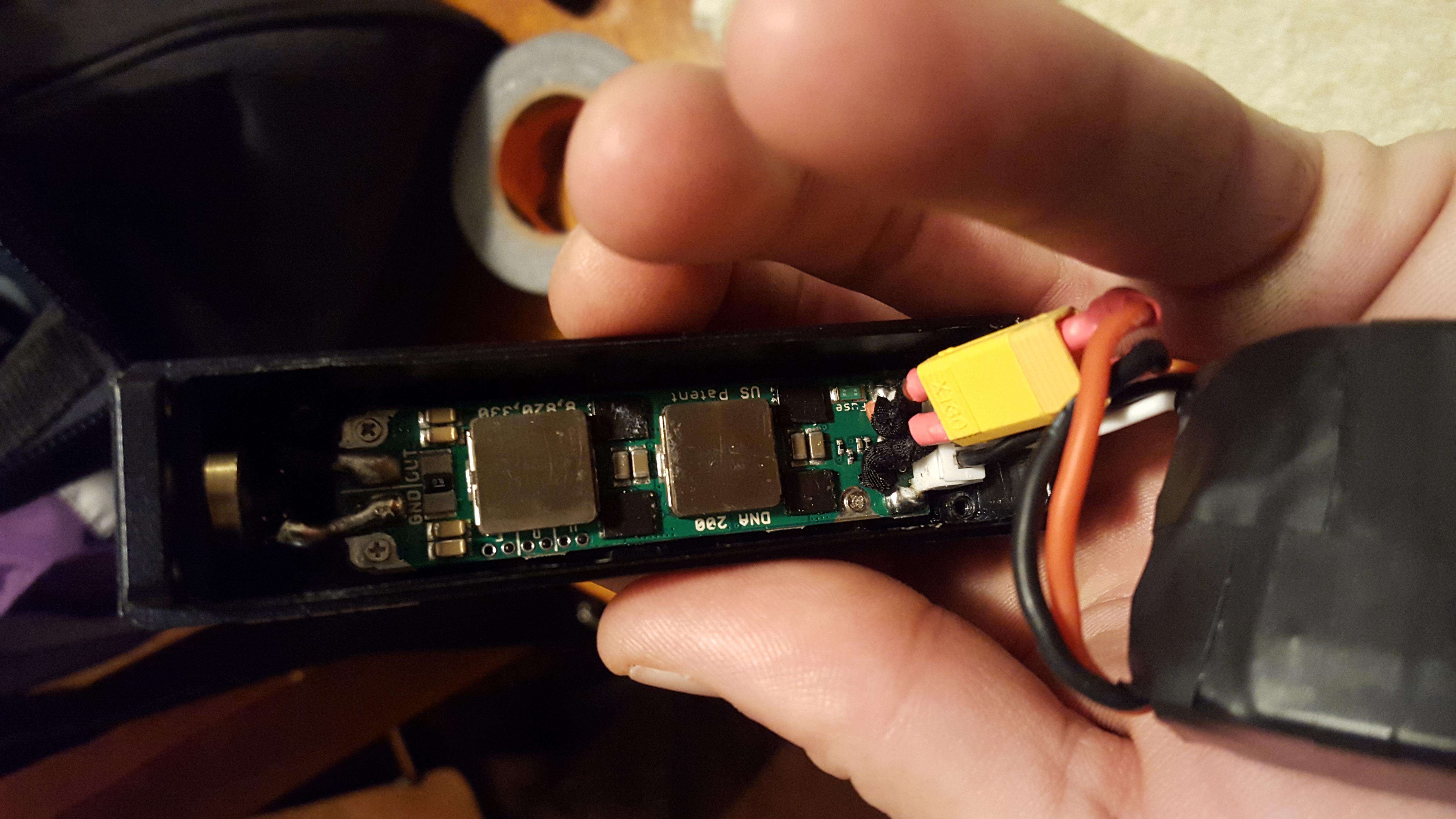

i just installed the thunder power 1350 in my vt200. had to remove the plate separating the chip and battery compartment . had to shorten the leads from the chip and change the plug on the battery. i removed the tabs on the battery side of the case also. i removed the lipo wrapper and rewrapped it with electrical tape. fits good and i got 14.23 for the first analyser test 20151111_223727.jpg  20151111_223742.jpg  20151111_223851.jpg  20151111_223858.jpg
Outstanding kraze6548! That looks GREAT! Good news is at least now people have choices. Bad news is they both require a dremel. :( How long did it take to modify yours? I just completed my second battery analyzer test. First time I used a 1.5 Ohm loop and scored a disappointing 13.892. This time I made four 1 Ohm loops for a .25 Ohm load test as suggested by John from Evolve at the end of this page. https://forum.evolvapor.com/topic/67481-topic/
