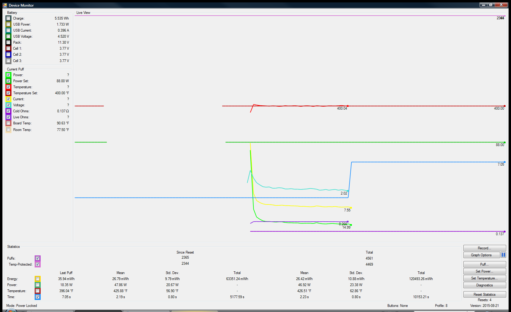

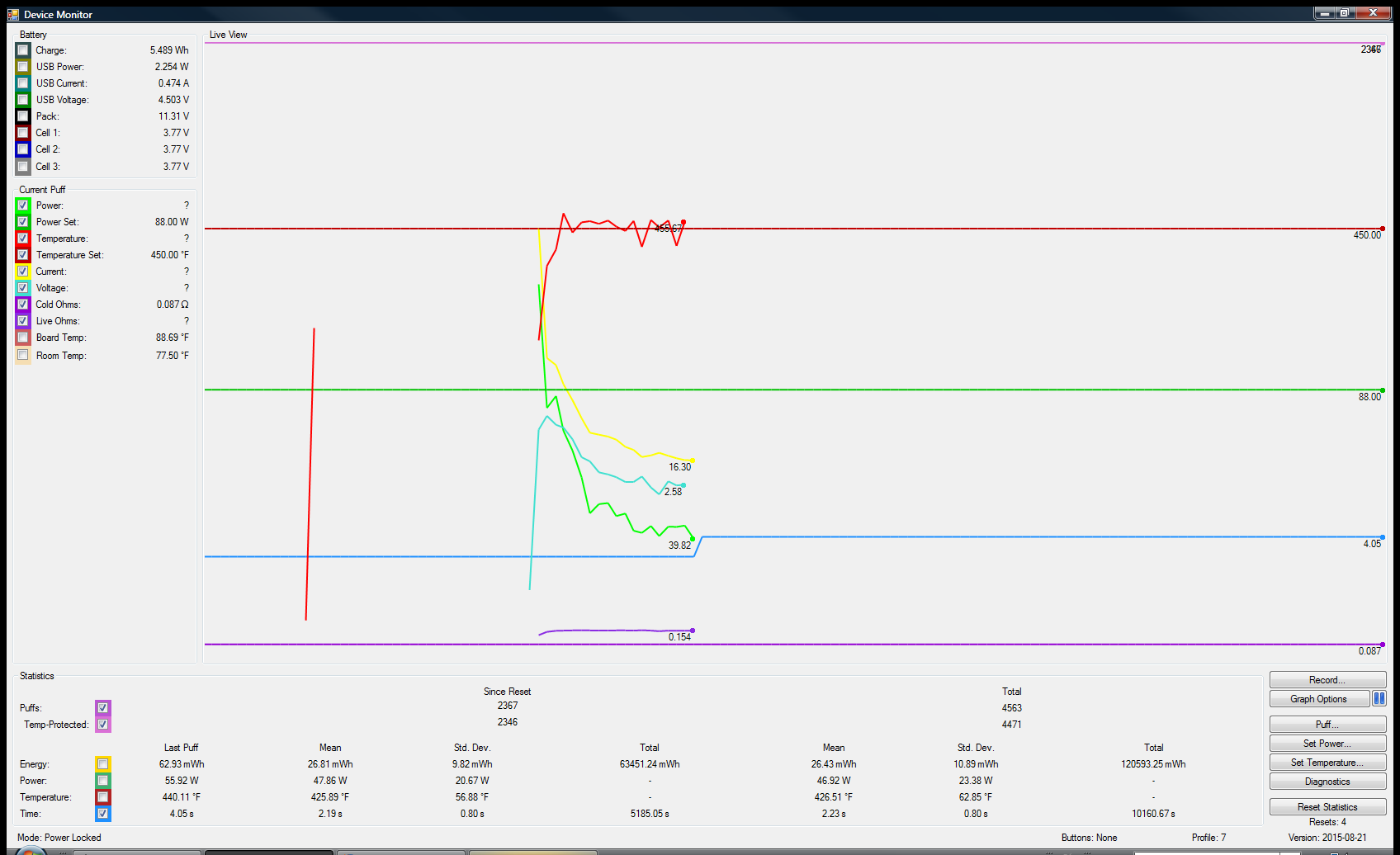

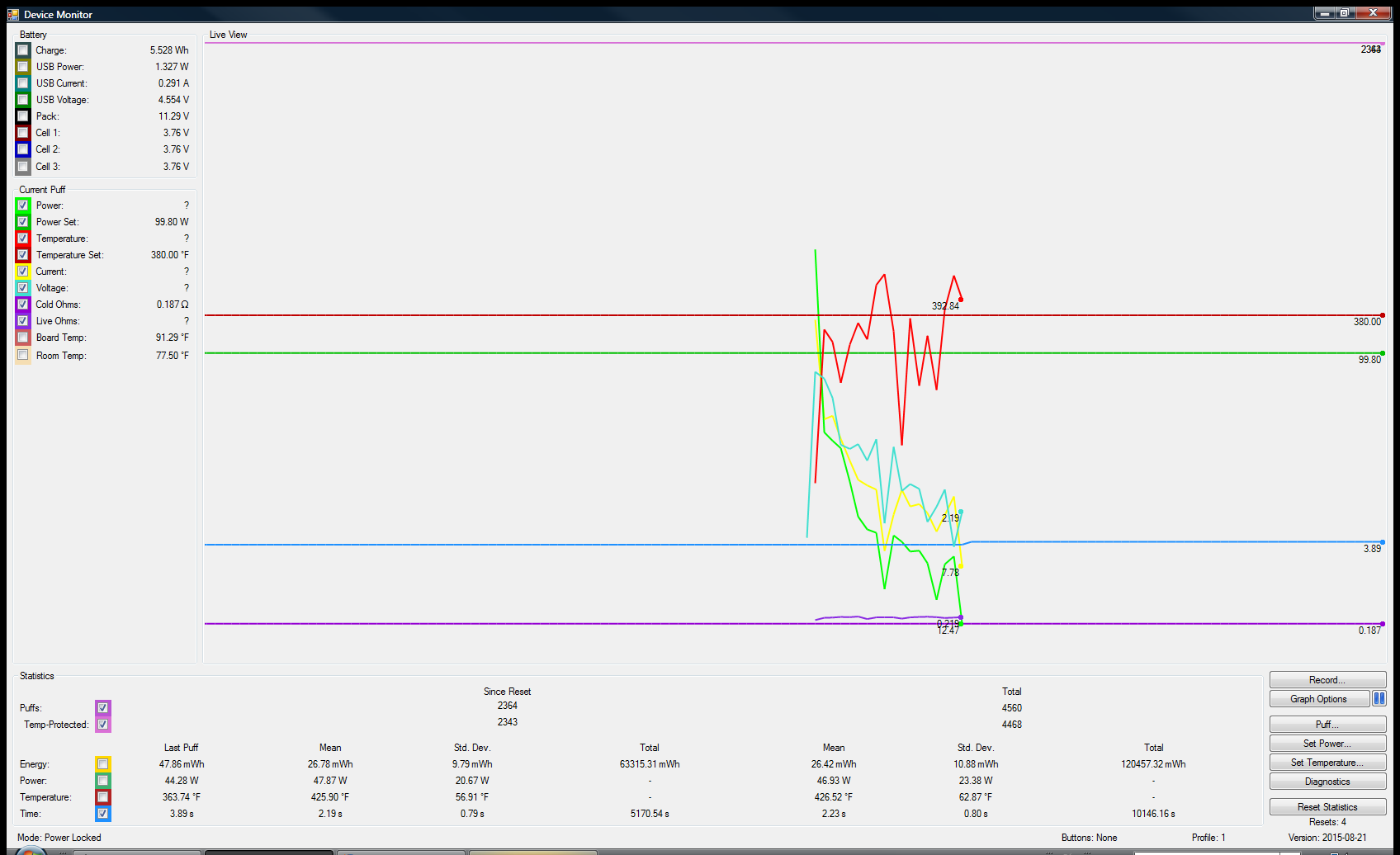

lewisss Posted September 20, 2015 Author Report Posted September 20, 2015 Hi, just wanted to share some screens from device monitor, and wonder if anyone can tell me what is going on here.with NI200 the selected temperature is hit and it remains there nice and steady,with titanium it gets to the temp and then fluctuates a littlewith 317L Stainless it gets to the temp then fluctuates quite wildlyNow the vape on all three is very good so i have no complaints, in fact i prefer the taste of the SS out of all three, and it is a dream to work with.I am presuming the difference in the charts is because the temp coeficient chart gradients are a lot shallower on the SS therefore the resistance difference between two temperatures is a lot smaller than ni200 or titanium, which would also explain the slight variation on the TI coils.am i correct in thinking this ?Thanks in advance

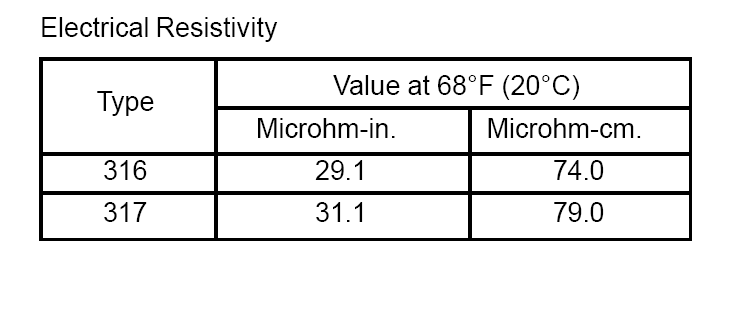

lewisss Posted September 21, 2015 Author Report Posted September 21, 2015 quote "mknight8 hours ago Could it be that you need to use tcr for 316l? I noticed most ss out there is 316 or 316l. Getting killer performance with dual coil, 24g at 0.2 ohm. Setting tcr to 0.001"317 and 316 should perform pretty much the same as each other, 317 is just a bit more corrosion resistant than 316 (which should mean safer possibly)I have downloaded the 317l csv from steam engine which should match the difference in resistivity between 316 and 317The 'L' just means there is less carbon in the alloy which just means they are more resistant to intergranular corosion when used for welding......I trust we are not vaping at those temperatures!!for anyone thats interested here is the difference in resistivity:-

VapingBad Posted September 21, 2015 Report Posted September 21, 2015 SS covers a large number of alloys, resistivity is no the same at the Temperature Coefficient of Resistance that the DNA used to gauge temperature. The simple answer is if temp limiting is not working you almost certainly have non matched alloy and TCR. Hopefully wire vendors will start to provide TCR curves in the near future.IIRC the video Brandon did on the DNA40 launch with PBusardo he explained that a difficulty with ss was the variance in the alloys.(ss will not be nearly as accurate as Ti wish will not be as accurate as NI)

VapingBad Posted September 22, 2015 Report Posted September 22, 2015 I think that the specs for ss are more about corrosion resistance and hardness so allow those variances in make up which could change the TCR considerably, I am no expert. This is why I feel that wire vendors should be providing the TCR in an ideal world.

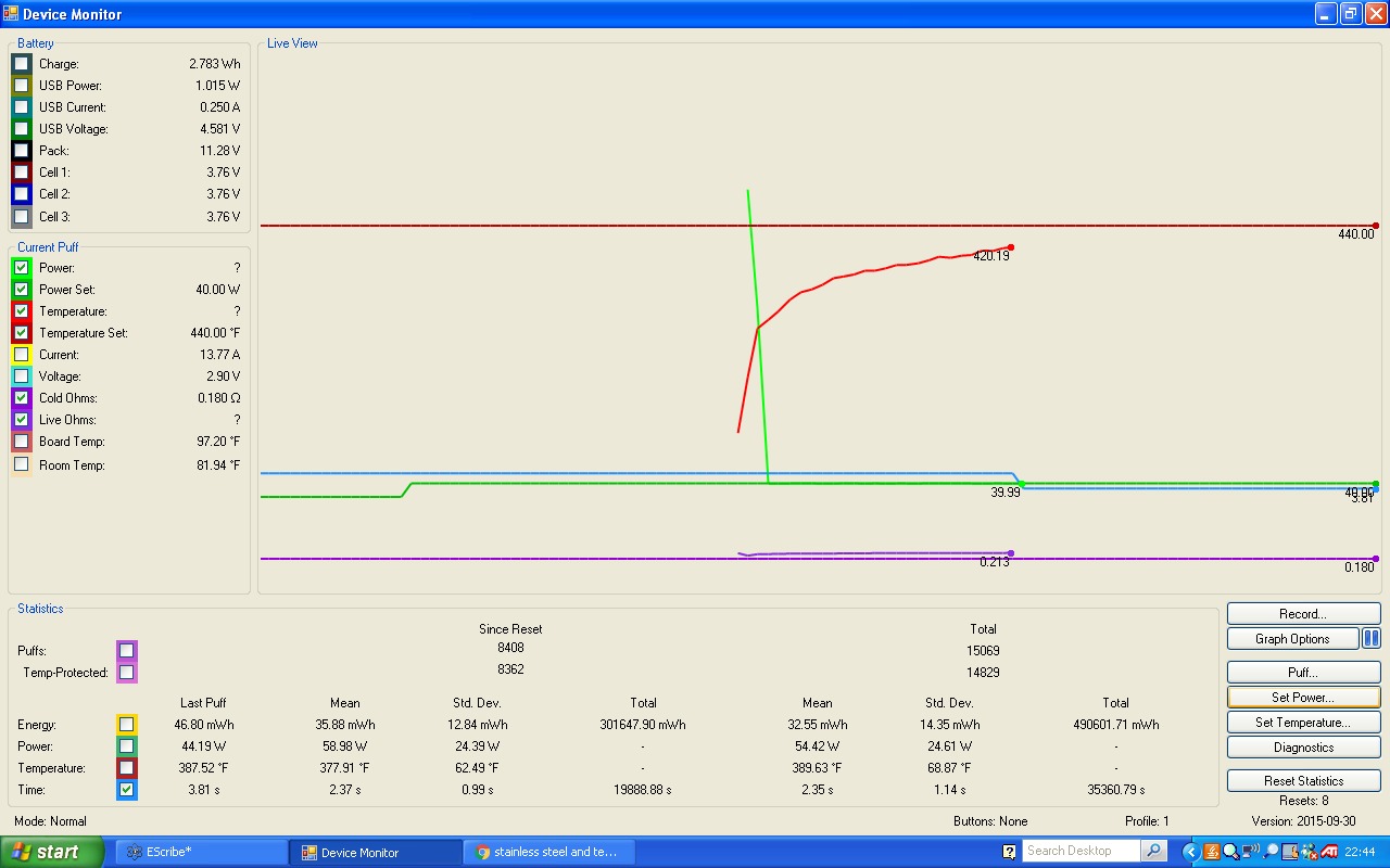

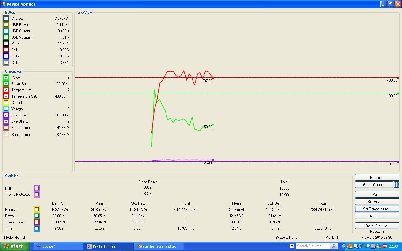

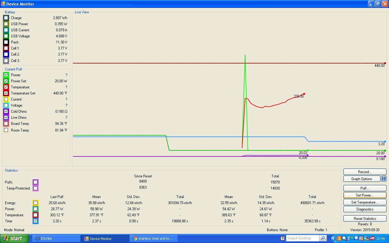

lewisss Posted October 22, 2015 Author Report Posted October 22, 2015 Hi I have been struggling too with stainless steel for a while as it is a dream to work with and I do have a work around where I have got the vape exactly how I want it! It does involve using escribe and it is just a way of changing the settings slightly on my ss profile so that the device makes the chip and temp control work a different way. When I get home tonight I will get some screen shots and run through some examples of what I do. Currently running a 2.5mm 9wrap dual spaced coil of 317L .5mm 0.18 ohms at 440f and 55watts. On a velocity and Hcigar vt200 And it is great! I am using the steam engine ss317 csv With this system you should be able to do any ss coil and get the same results. Sorry to make you wait , but I am working at the moment. Will post back in about 8 hours
lewisss Posted October 22, 2015 Author Report Posted October 22, 2015 Sorry I am late but this is what i have found works best for me!now I know there will be those of you that will say i am not using this in temperature control, but when my dripper runs out of juice i can feel it backing off so the temp control is working.Ni200 I can quite happily set my temp and put the power at 200 watts and know that when the temperature reaches my setting the curve will flatten out and stay level at that temp till the juice runs out.MY THEORYStainless :- we have seen that as the csv for stainless is such a shallow curve a very small increase in resistance = a large increase in temp . so the dna 200 has to keep cutting out and adding power leading to ss being an inconsistent vape.not so much inconsistent but more ''thin'' , NI200 has practically a constant power going through it once it reaches the set temp whereas with SS the DNA 200 chip is just not fast enough to keep up with the minute changes of resistance.So we need to work around this. and this is what i have done.below there are three screenshots from device monitor.the first one {ss100JPG} is how i would normally set up NI200. temperature where i want it 400f, and power at 100 watts. and as you can see we have the usual unstable pattern when we reach temperature which leads to the thin, weak vape.the second one[ss20} is dropping the power to 20 watts and increasing the temp to 440Fhere the temp and power jump up with the preheat punch and then the temp dips before climbing again. This also leads to a thin weak vape.the last one {SS40} is the point i have found with this coil and this juice a get excellent result temp 440f power 40 watts. although the temp never reaches my target temperature it hits immediately with the preheat punch and then just climbs steadily till i stop drawing on it. So yes I know it is a bit of a PITA but it is worth working with the tools we have to get this result.why? because not only am i getting a nice consistent thick vape. I am also getting back the subtleties of flavour in the juice as the heat ramps up. something I didn't realise I was missing until i tried this.**the graph was set at 15 seconds and the average puff was 3.5 seconds**Have a go if you have time. I think it is worth it. ss 100.bmp ss20.bmp ss40.bmp
techbearus Posted October 23, 2015 Report Posted October 23, 2015 Thanks for sharing @lewisss .. makes a lot of sense now.. was testing DNA200 @ 40W power and same for preheat to simulate a Dicodes and it is a lot smoother compared to 100W preheat with 54w power settings.. I can now better understand how the SS profile can be better tamed with optimal (lower) power .. it doesn't hit the temperature or give warm/hot vape but definitely gives a smoother vape, so I keep these two in different profiles and use them as my mood dictates ... (smooth and silky) or (rowdy and warm) ..
