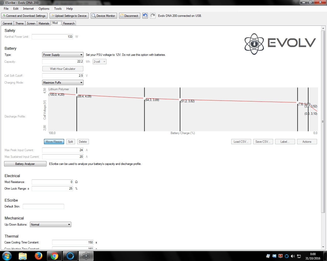

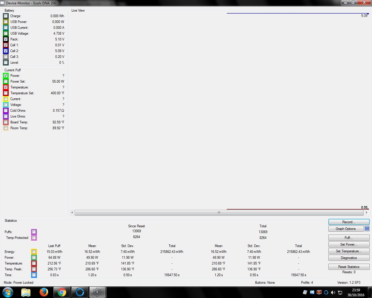

galuh Posted October 30, 2016 Report Posted October 30, 2016 help 133 finder suddenly die, but when firing long press turns on and off the firing button to die, try to check the battery indicator escribe cell 1 '0.0v' and cell 2 '5.09v' and replace the battery setting type 'POWER SUPPLY' normal and willing in firing but the battery indicator is empty, so please his problem where? 1 again whether it is safe by setting the batteries 'power supply' is? thanks
VapingBad Posted October 31, 2016 Report Posted October 31, 2016 Using power supply you turn off all the battery safety features so you should no run it like that, does it still say the voltage is 5.1 in power supply mode? It could be your battery connections, reverse battery protection board or the connections from that to the board. All you can do really is clean the battery connections and check they are making contact properly especially at the positive end where there is a raised ring.
