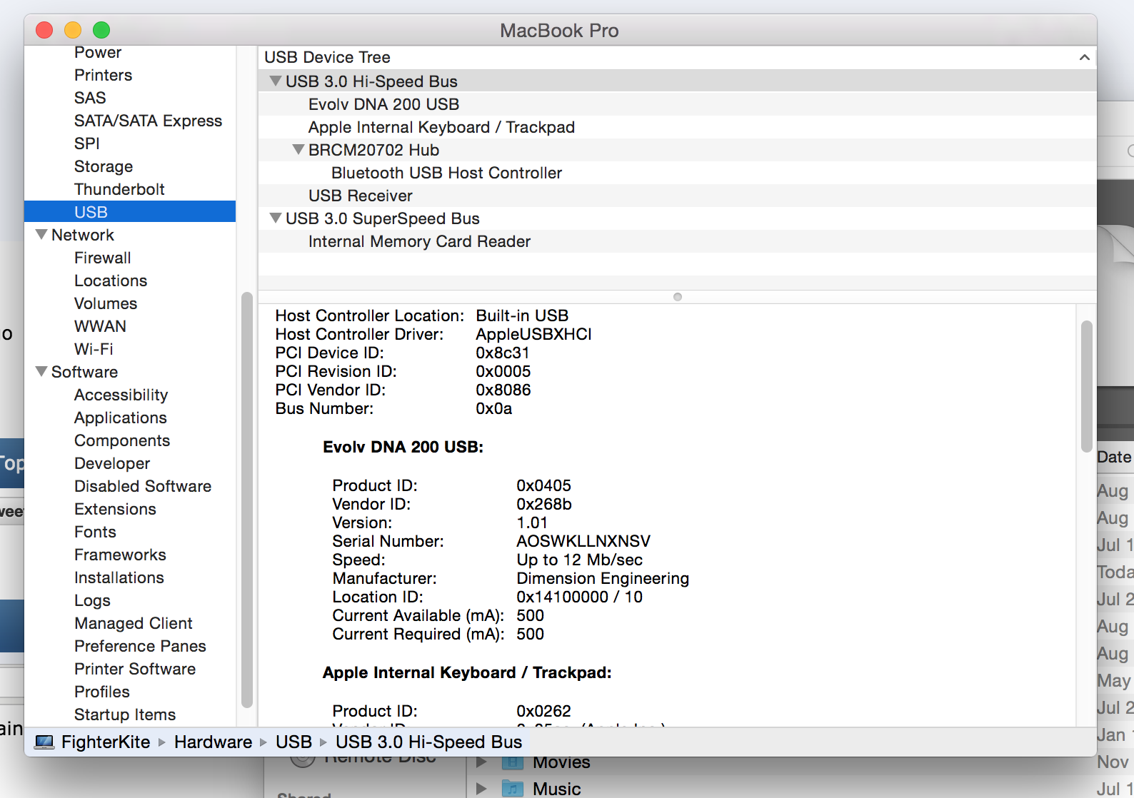

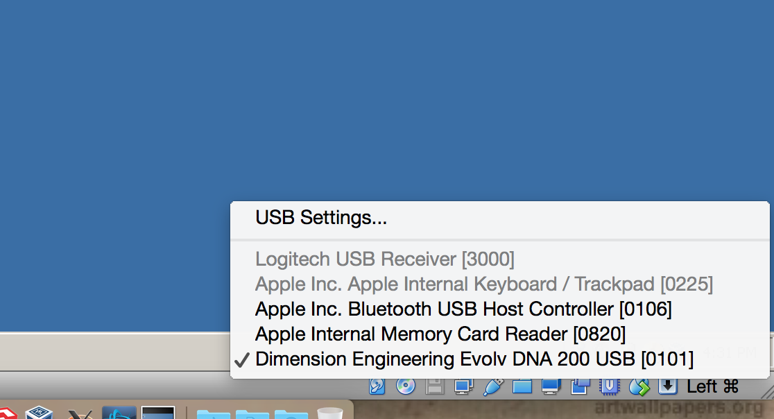

blueridgedog Posted August 13, 2015 Author Report Share Posted August 13, 2015 Step one is to make certain your DNA200 is seen by the mac:Click the apple icon in the top menu, then "about this mac" then "system report" then view your USB devices. You must see the DNA200 from the mac such as: From there, open virtual box and go to the USB settings area for the machine you are configuring, click the plus sign and enable the DNA200 as a USB device on the virtual machine: Start the virtual device and prior to running escribe, make certain the guest OS can see the DNA200 by clicking the USB icon at the bottom right: Link to comment Share on other sites More sharing options...
moibarzi Posted August 13, 2015 Report Share Posted August 13, 2015 i did that like three times to make sure and nothing happened, i tried one from a friend and it worked perfectly, i dont know whats wrong with mine Link to comment Share on other sites More sharing options...
blueridgedog Posted August 13, 2015 Author Report Share Posted August 13, 2015 So the Mac and the guest OS see the mod, but escribe won't? Link to comment Share on other sites More sharing options...
moibarzi Posted August 14, 2015 Report Share Posted August 14, 2015 exactly, please help me out because i really want to use the program Link to comment Share on other sites More sharing options...
blueridgedog Posted August 14, 2015 Author Report Share Posted August 14, 2015 If escribe in your guest OS sees your DNA200, and sees your friends DNA200, will open your friends DNA200, but will not open your DNA200, then I am inclined to think it is something specific to your chip. My only thought is to use another computer to put the latest firmware on your chip. Link to comment Share on other sites More sharing options...
laadam Posted August 14, 2015 Report Share Posted August 14, 2015 I ran into a similar situation trying to connect a second mod. I did several things so I'm not exactly sure which step or combination of steps solved the problem!- Disconnected/removed Evolv from the USB settings menu- Restarted everything- Added Evolv in USB settings- Restarted everything- Opened device manager in guest OS (Win7)- Searched for new hardware- After verifying Windows recognized the mod, I opened EScribe- Connected!Like I said, far too many steps but it worked in the end... Link to comment Share on other sites More sharing options...
blueridgedog Posted August 14, 2015 Author Report Share Posted August 14, 2015 It may be that you need to install the USB port in the guest OS for each mod due to variations in port assignments. To test, I would delete the USB port assignment from the Guest configuration then set it up again with the new mod. Link to comment Share on other sites More sharing options...
laadam Posted August 14, 2015 Report Share Posted August 14, 2015 blueridgedog said:It may be that you need to install the USB port in the guest OS for each mod due to variations in port assignments. To test, I would delete the USB port assignment from the Guest configuration then set it up again with the new mod.I may have gone the long way doing it but that's essentially what was accomplished.In the end, it did work. Link to comment Share on other sites More sharing options...

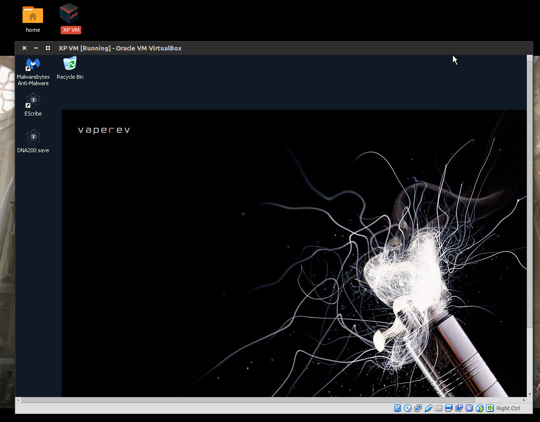

acorpcop Posted August 19, 2015 Report Share Posted August 19, 2015 James said:lsusb just gets a maintained list of VIDs and PIDs. It doesn't query the device. Whether it shows or not isn't related to whether USB is working.268b:0405 is the DNA 200, yes.Thanks James. Well, I have a work around. Installed virtualbox and made XP virtual machine. Enabled the USB etc in VB.I feel dirty for having to do this but at least I don't have to "actually" boot into windows just to diddle with my mod. Every thing seems to work just fine. Link to comment Share on other sites More sharing options...
