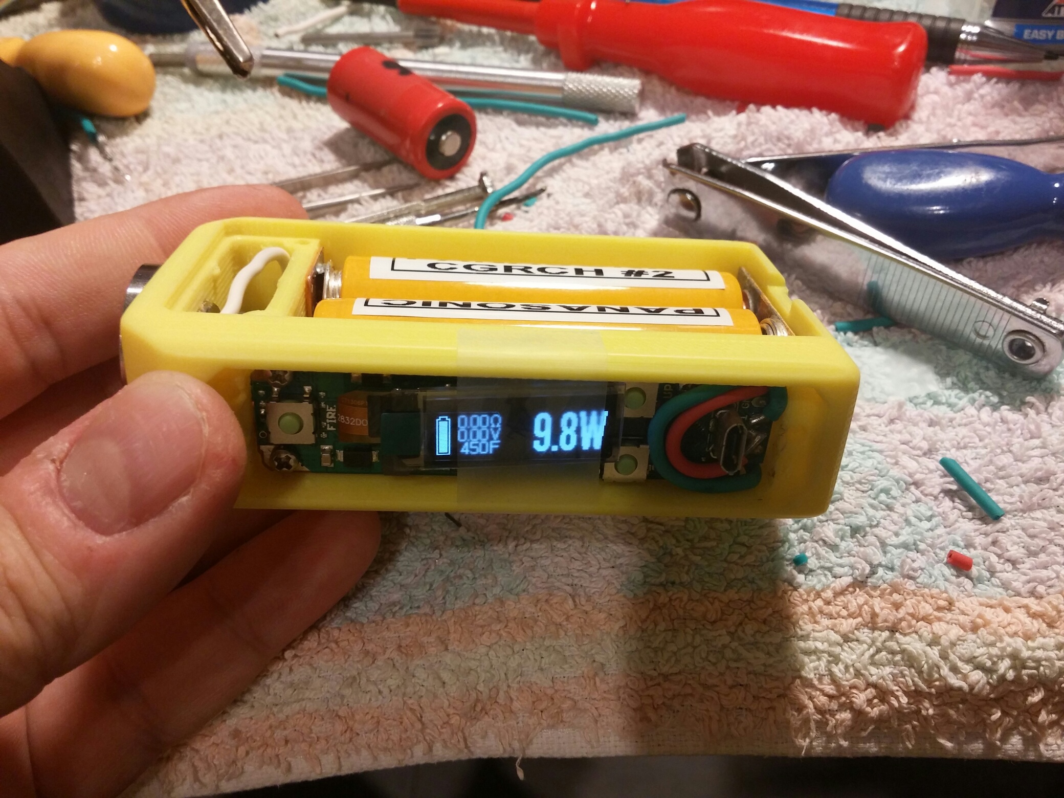

Mad Scientist Posted August 31, 2015 Report Posted August 31, 2015 For the benefit of anyone else reading this thread whose mind works the way mine does (scary thought lol) the numbers referred to are not pin numbers, they are cell numbers. Bridging 2 and 3 means cell 2 and 3 at pins 3 and 4, etc. Ground doesn't seem to be worthy of a number. Luckily the board is very forgiving of screwing that up (guess how I know lol). My latest DNA 133 creation is now done except for the 510. Hope to finish that up tonight. Pics will be forthcoming.
mandro Posted September 6, 2015 Report Posted September 6, 2015 I also messed mine up on first attempt, originally I bridge the two centre pins. I also wired the balance tap using turbo's idea with ground and pin 2/3 going directly to the board, leaving just pin 1 connecting to the battery, it's working great.
