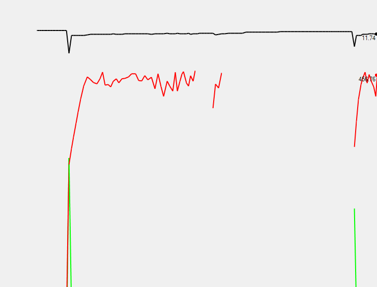

Voku Posted October 19, 2016 Report Posted October 19, 2016 plcockrell said:I just received my Hana Modz DNA 200 today. I had been using it for about 3 hours when the screen went blank on me. The mod is still working normally but the screen is just blank. If I plug the device into my computer and then bring up the device monitor I can see it working. This happening completely randomly. I was using the mod, went to re-drip, and the screen just stopped working normally.When I try to restore the default settings, the screen will come on with the Upload Settings text so I know the screen is working. It will also come on with the Evolve DNA 200 logo when you reboot the device and when I tried to flash the firmware again. The only other time I can see the screen is when the device is locked it will flash the device locked screen quickly if I hit the power button.I have also tried putting the device into stealth mode and then turning it off. No luck.I have not been able to find anything else on this issue and I hope it is just firmware glitch. I am loving this chip to much to have to send it back already!Below is the device monitor screen shot.Edit: Also if I press capture screen it comes up blank as well. Which is making me think this could be a firmware issue?I have the same problem.
