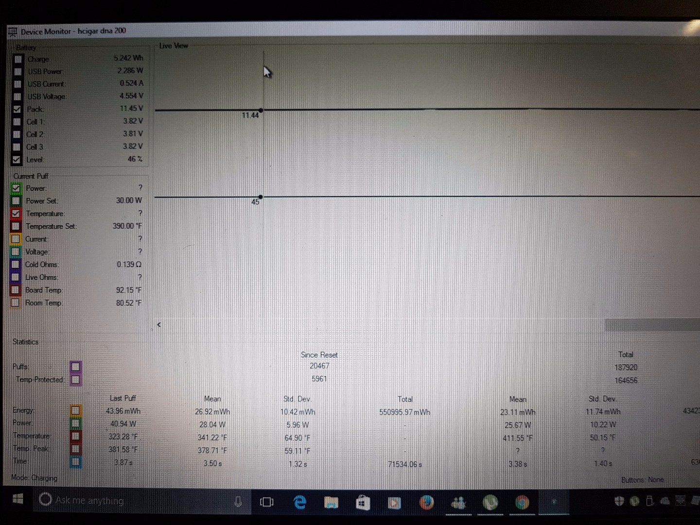

John la Posted February 2, 2017 Report Posted February 2, 2017 Just want to put this out there I love the dna 200 board best mod I have ever had almost at 190 000 puffs on my hcigar dna 200 board
