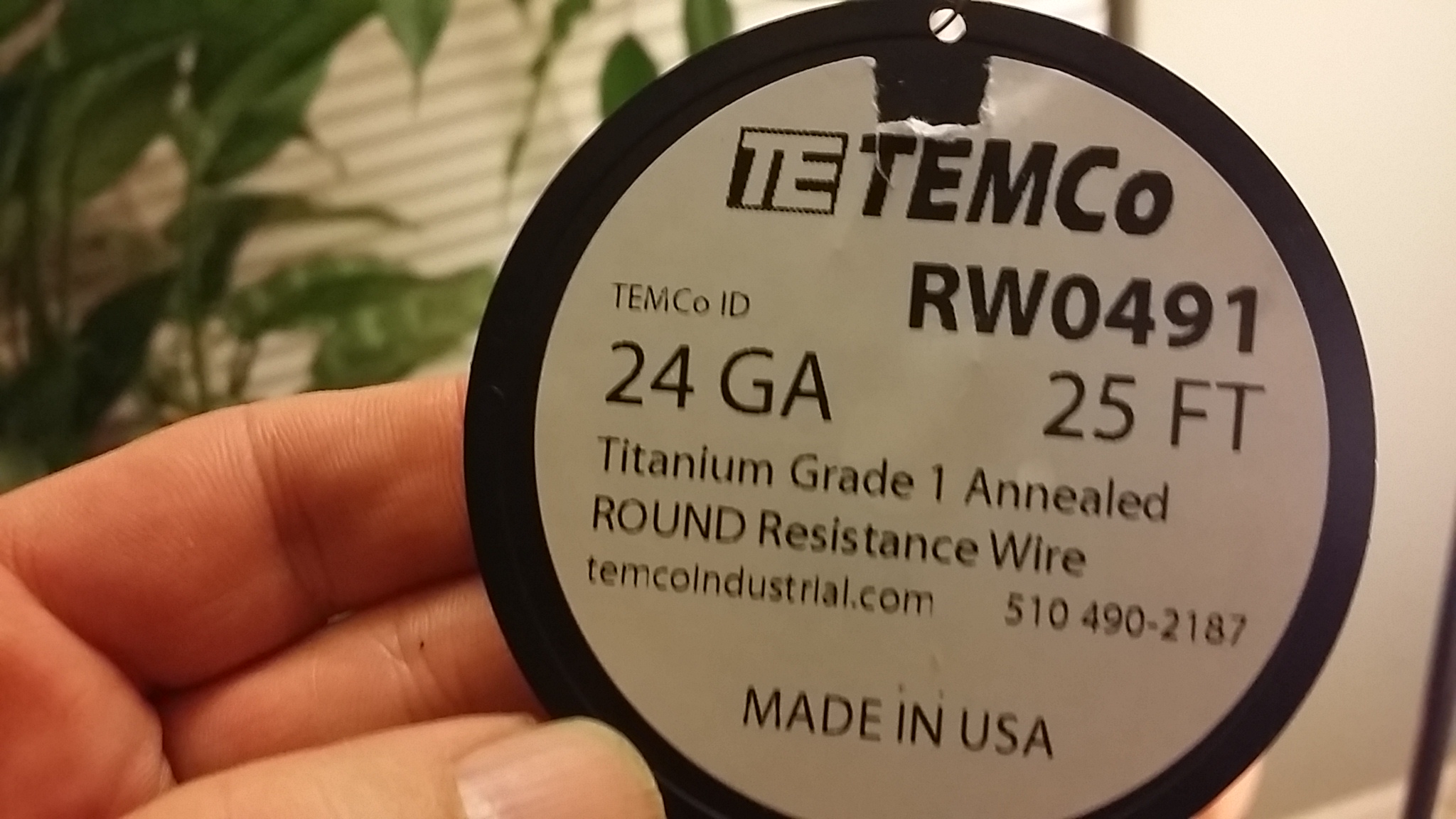

liquid_strat Posted February 12, 2016 Author Report Posted February 12, 2016 I decided to try some Temco Ti grade 1 wire. This is annealed wire, which I did not notice when I ordered it. I searched all over the forums for info on Temco titanium wire and found no mention of it other than questions being asked which were completely ignored. So, for $6 wire (25ft/24awg), I thought why not. The wire arrived and was slightly dull silver in color and not shiny like some of the other Ti wire being sold as vape specific or"specialty". The color/appearance would be due to the TiO2 layer and was otherwise clean and not as oxidized as some of the reference pics I have seen. I've outlined my experience below: 1. I cleaned the wire with alcohol/cotton and wiped it dry before use. 2. loaded the Steam Engine CSV for Ti grade 1. I could not find any other standard Ti CSV files for testing as those that have been discussed were pointed towards dead links. The setup was the following: Freakshow RDA; Wismec Reuleaux DNA 200; Settings were 35-45w with a 60w preheat, punch set to 5 (420 - 500 degF) The coils were 9 wrap/3mm-ID dual coils: 1 spaced set; 1 set of contact coils With a temp limit of 420 degF: Temperature went to limit within 1 or 2 2second pulls. Bumping the temperature limit up to around 480 seemed to work better where I could take several (4 or 5) 2-3sec pulls, but the DNA 200 was pulling the wattage back some to keep it there. Neither set of coils seemed to have the perceived power of SSV Ti using the same settings. Also, the SSV wire hit temperature as I would have expected, when the cotton began to become dry from use, whereas this wire had the tendency to hit the temp limit quickly. Obviously I will need to order non-specialty Ti grade 1 wire from a few other vendors to know how Ti is going to perform. For me the SSV Wire works very well, but I would like to have a less expensive option. Also, from what I have gathered, grade 1 Ti is not commercially available as 100% Titanium and is only 99.2-99.5% pure. I have seen the 100% pure and surgical grade descriptor thrown around by a several vendors. The surgical aspect would certainly appear to be simple marketing, as all grade 1 Titanium is surgical grade as are several other grades of titanium. So for now, I'm going to leave this wire alone, at least until I find out if this is safe to use or not.
liquid_strat Posted February 12, 2016 Author Report Posted February 12, 2016 As a quick update: After letting the mod sit for a while with the Ti wire build in it, the DNA board seems to have "refined" itself. The vape seems to be working fairly well @ 480 deg F. and is not having to pull back the wattage to stay below temp. Still I would like to find out how this particular wire will perform over time and also how safe it is to use.
Spector NS5 RD Posted February 12, 2016 Report Posted February 12, 2016 liquid_strat said:I decided to try some Temco Ti grade 1 wire. This is annealed wire, which I did not notice when I ordered it. I searched all over the forums for info on Temco titanium wire and found no mention of it other than questions being asked which were completely ignored. So, for $6 wire (25ft/24awg), I thought why not. The wire arrived and was slightly dull silver in color and not shiny like some of the other Ti wire being sold as vape specific or"specialty". The color/appearance would be due to the TiO2 layer and was otherwise clean and not as oxidized as some of the reference pics I have seen. I've outlined my experience below: 1. I cleaned the wire with alcohol/cotton and wiped it dry before use. 2. loaded the Steam Engine CSV for Ti grade 1. I could not find any other standard Ti CSV files for testing as those that have been discussed were pointed towards dead links. The setup was the following: Freakshow RDA; Wismec Reuleaux DNA 200; Settings were 35-45w with a 60w preheat, punch set to 5 (420 - 500 degF) The coils were 9 wrap/3mm-ID dual coils: 1 spaced set; 1 set of contact coils With a temp limit of 420 degF: Temperature went to limit within 1 or 2 2second pulls. Bumping the temperature limit up to around 480 seemed to work better where I could take several (4 or 5) 2-3sec pulls, but the DNA 200 was pulling the wattage back some to keep it there. Neither set of coils seemed to have the perceived power of SSV Ti using the same settings. Also, the SSV wire hit temperature as I would have expected, when the cotton began to become dry from use, whereas this wire had the tendency to hit the temp limit quickly. Obviously I will need to order non-specialty Ti grade 1 wire from a few other vendors to know how Ti is going to perform. For me the SSV Wire works very well, but I would like to have a less expensive option. Also, from what I have gathered, grade 1 Ti is not commercially available as 100% Titanium and is only 99.2-99.5% pure. I have seen the 100% pure and surgical grade descriptor thrown around by a several vendors. The surgical aspect would certainly appear to be simple marketing, as all grade 1 Titanium is surgical grade as are several other grades of titanium. So for now, I'm going to leave this wire alone, at least until I find out if this is safe to use or not. two questions for you.1) do you notice a significant difference between the SSV and tempco brand? in terms of flavor, temp stability, and durability?2) do you find contact coils perform better, worse, or the same for Ti TC? i find slightly spacing all of my coils, even kanthal, seem to last longer. in terms flavor being muted due to contact coils. my theory is the tiny spaces in spaced coils don't allow the crud to build up around the coil and choke off, or choke in, the vapor as the coils racks up mileage.
HugeEgo Posted February 12, 2016 Report Posted February 12, 2016 liquid_strat said:As a quick update: After letting the mod sit for a while with the Ti wire build in it, the DNA board seems to have "refined" itself. The vape seems to be working fairly well @ 480 deg F. and is not having to pull back the wattage to stay below temp. Still I would like to find out how this particular wire will perform over time and also how safe it is to use. It's titanium, so it will be as safe as any other titanium. TEMCo is reputable and sells high-quality (usually made in the USA) wire. Their Kanthal, for instance, is made by Sandvik themselves.You can e-mail them and ask. They usually respond to e-mails very quickly.
kraze6548 Posted February 12, 2016 Report Posted February 12, 2016 ssv wire wire is great. i been using it for months. few extra dolllars, but they provide custom csv and have great customer service. it performs better than the other ti wire i tried . everyone has their own opinion so not everyone will agree but i love it and use it on everything . i got 50 ft for 30 bucks and i am still on the same roll since september when i got my first dna 200
liquid_strat Posted February 12, 2016 Author Report Posted February 12, 2016 Chunky, the temco provides the same flavor, at least to me, as the SSV wire. Temp sensing appears to be working fairly well with the slight increase in temp limit, 480 vs 450 for SSV. I haven't had time with the wire and escribe long enough to work out more favorable settings for performance. After I have more time to work with it, I can have a more detailed description. I enjoy the spaced coils more so far. The flavor, vapor, and temp performance seems better, however, I need to work with the contact coils more before I can say definitively. I will say the spaced coils are way easier to build and use quickly.
mactavish Posted February 12, 2016 Report Posted February 12, 2016 Doing ones homework should be mandatory or at least logical. The SSV wire has been discussed and beaten to death, do a search on the ECF site. It's NOT grade #1 titanium, hence its own special TCR profiles. You pay more and get less, but folks simply ignore the facts. However, the news that Tempco is finally carrying G1 Titanium is great news, even better that's it's ANNEALED (soft)! The Rio Grande titanium (soft) has only been available in 24 gauge, which works great, but now there are more choices in gauge with Tempco. Breath whatever you like, if I'm doing Titanium, then I want GRADE #1, nothing less, especially a hyped grade 2, with whatever else is included. Finding the proper TCR for G1 titanium on SteamEngine is quick and easy.
