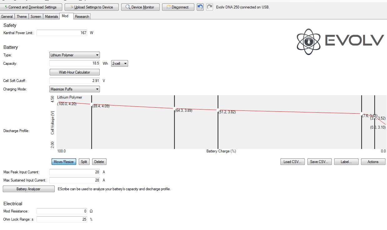

Evo1340 Posted February 13, 2017 Author Report Posted February 13, 2017 I'm not sure what you mean The only power limit I find is in this pic. Besides I am running with 2 18650's.
Evo1340 Posted February 13, 2017 Author Report Posted February 13, 2017 Evo1340 said:I'm not sure what you mean The only power limit I find is in this pic. Besides I am running with 2 18650's.Oops, now his post is gone.

Spector NS5 RD Posted February 14, 2017 Report Posted February 14, 2017 "Ohms too high" means you're exceeding the maximum voltage output the board can provide. this means, the wattage will automatically be adjusted down to level it can output. it goes as follows....6.2 volts MAX for the DNA 75 6 volts MAX for the DNA 133 / DNA 167. 9 volts MAX for the DNA 200. 9.3 volts MAX for the DNA 250my suggestion to you is, build a lower ohm coil. this will help you avoid the "ohms too high" message.
Evo1340 Posted February 14, 2017 Author Report Posted February 14, 2017 Well that is with .2ohm coils. I do still get the step down in wattage and voltage without any error message while firing when the new batteries are draining. You guys know more about this stuff than I would so I don't try to come across as though I understand it all. I just feel like it doesn't give me what I thought it would.
dwcraig1 Posted February 14, 2017 Report Posted February 14, 2017 0.3 ohms (hot if TC wire) @ 6 volts =120 watts0.2 ohms at 6 volts would be 180 wattsHere I'm seeing around 3.65 voltshttps://forum.evolvapor.com/topic/65896-topic/?do=findComment&comment=892026
Evo1340 Posted February 14, 2017 Author Report Posted February 14, 2017 dwcraig1 said:0.3 ohms (hot if TC wire) @ 6 volts =120 watts0.2 ohms at 6 volts would be 180 wattsHere I'm seeing around 3.65 voltshttps://forum.evolvapor.com/topic/65896-topic/?do=findComment&comment=892026What I'm using they call Hive wire with Kanthal. With the new batts I turned it down to 105W with .2ohm dual coils but unless the batts are fully charged..... Anyway, I get the point. No more reason to talk about it. I understand the board in the DNA250 is made to protect itself and batteries which protects the user so....
Spector NS5 RD Posted February 14, 2017 Report Posted February 14, 2017 there should be some message that flashes across the screen, unless you have your error flashes set 0 or 1 times. my guess is your hitting your "cell soft cutoff" limit. if you know you are using the correct cells (cells that have an amp rating capable of providing the power you're asking from them) and still getting a reduction in power, i would email Boxer and describe your problem. you have some bad wire soldering. Boxer would be the people who would fix that for you. it should still be under warranty, right?im curious, what kind of cells are you using?
