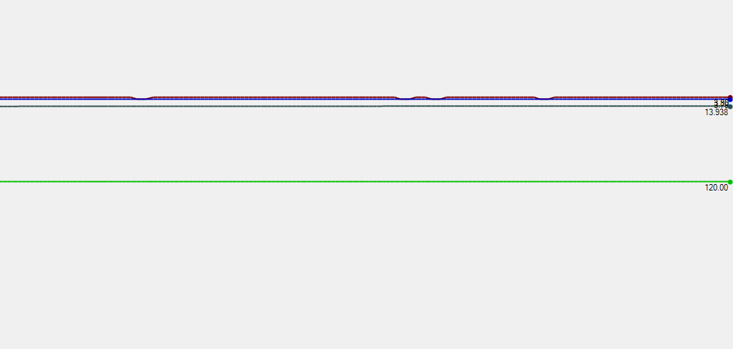

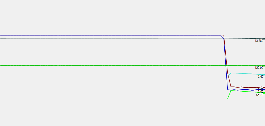

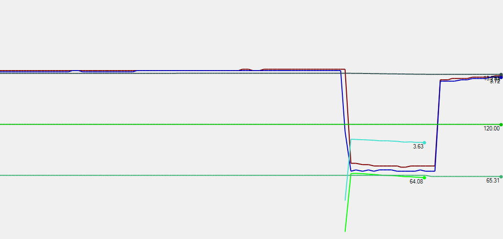

retird Posted February 11, 2017 Report Posted February 11, 2017 Can you post a screenshot of Device Monitor showing the wattage, power set, power while firing the device.... check those boxes in the list on the left side of Device Monitor

Evo1340 Posted February 11, 2017 Author Report Posted February 11, 2017 retird said:Can you post a screenshot of Device Monitor showing the wattage, power set, power while firing the device.... check those boxes in the list on the left side of Device MonitorHere's a few shots
Evo1340 Posted February 11, 2017 Author Report Posted February 11, 2017 Evo1340 said:Here's a few shots
dwcraig1 Posted February 11, 2017 Report Posted February 11, 2017 It looks to me as you are hitting the soft cell cut off, either battery, battery connection or both aren't cutting it. Sag under load looks excessive.

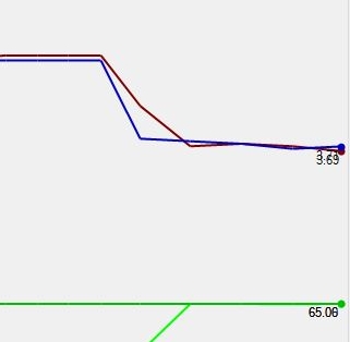

dwcraig1 Posted February 11, 2017 Report Posted February 11, 2017 here's a screen of my vt133 firing @ 65 watts. cells is are about 4.1 volts unloaded, 3.69 volts loaded. They are Samsung 25r's
