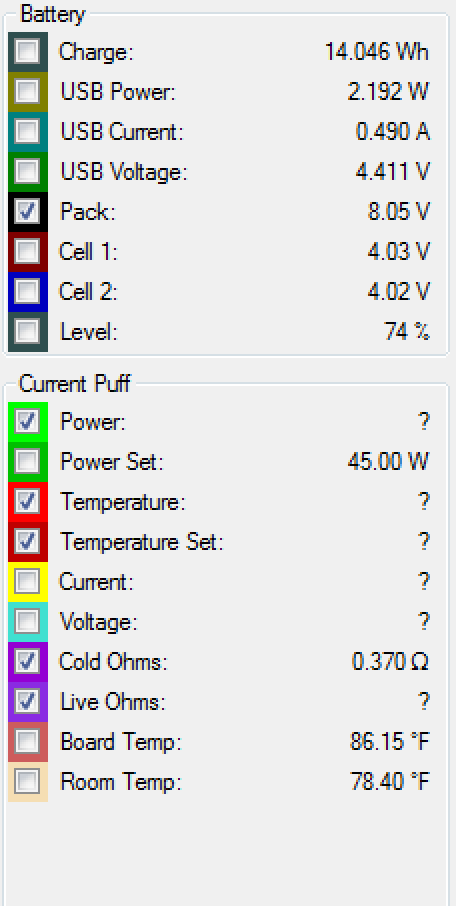

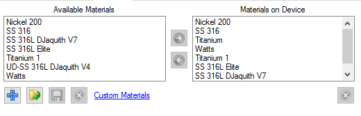

Wayneo Posted March 2, 2017 Report Posted March 2, 2017 Was your coil description accurate? Dual coils I presume?Did you remember to upload (the material and profile settings) to your mod?If that's 3 "yes's", can you post a printscreen of your profile and device monitor while firing. Ensure you have the following 'checked'.
Damob9k Posted March 2, 2017 Author Report Posted March 2, 2017 Hi Wayneo,Sorry , yes it's dual coil.And yes to the other questions.I tried it again this morning before going to work, switched the profile on the Mod to my Snapdragon prof, now it's doing something different .. when I fire it, it's now saying Temperature Protected, even if I put the temp up to max 300c ?Also I noticed that the resistance has gone up to 0.25ohms.I don't have the snapdragon with me now as I only use it when at home.I'll do a screen capture on Device Monitor tonight.CheersDamian BTW I'm having issues with the Device Monitor, as you may have spotted in my other post, ChuckyButt200 is currently doing His/her ? best to help me with that, so it may be a bit tricky to give you the necessary data but i'll give it a go !

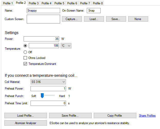

giz_60 Posted March 2, 2017 Report Posted March 2, 2017 Being that SS material is a finicky critter in TC, it is imperative that your device is set up properly for it to function correctly, so you might want to post a screenshot of you 'Mod' tab as well as the settings for the SS profile you are using.
Damob9k Posted March 2, 2017 Author Report Posted March 2, 2017 Here ya go giz_60 & Wayneo I've tried all 4 SS material versions I have, all do the same.Just looking for another USB cable to try, once found I'll try to do a dump of the monitor.CheersDamian
giz_60 Posted March 2, 2017 Report Posted March 2, 2017 Try raising your preheat power, preheat punch & time limit...I usually max out the power & punch for 3 secs...then let the board do its magic...Edit: and also raise the power in Settings...the board will throttle back the watts when temp is reached...

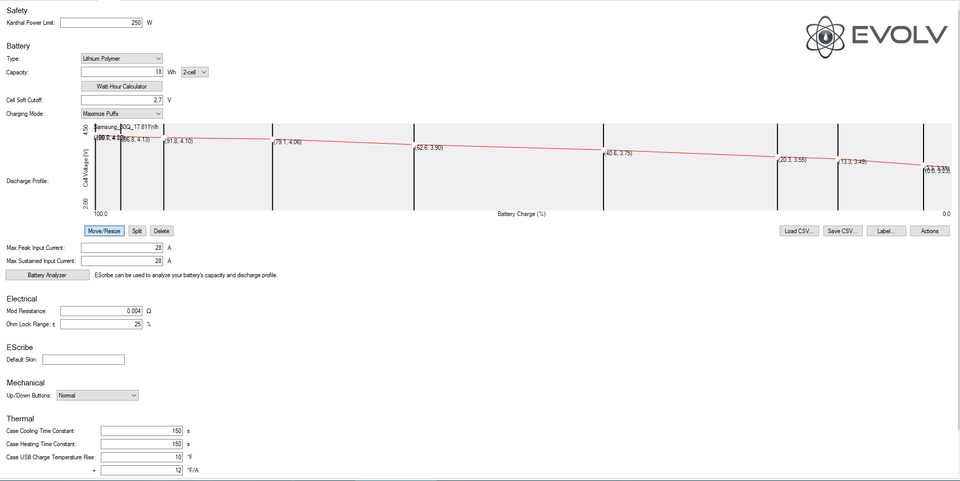

retird Posted March 2, 2017 Report Posted March 2, 2017 I've been following this thread and was just looking at your last screenshots the "Thermal Settings" are default Evolv board settings. You might consider running the Case Analyzer as it seems the device thermal settings were not tailored to the device but the default settings were left unchanged.@giz_60, I think, posted this .ecig file for the Therion 166 in another thread.. it shows the Evolv default thermals also....Therion166.ecig
Damob9k Posted March 2, 2017 Author Report Posted March 2, 2017 Thanks giz_60 & retird,I actually lowered the pre-heat based on some other comments on SS coils, it was on about 25 beforehand.I have already upped the watts after that screenshot, no effect, i'll up it more.I did try to run the case analyser at work a few days ago, but it took ages and I needed a puff so i stopped it !! I will get a spare mod working and give this a go - thanks for the advise on that.BTW what is an "ideal" resistance target for SS316L ? I read .50ohms, but that seems high ?CheersDamian
